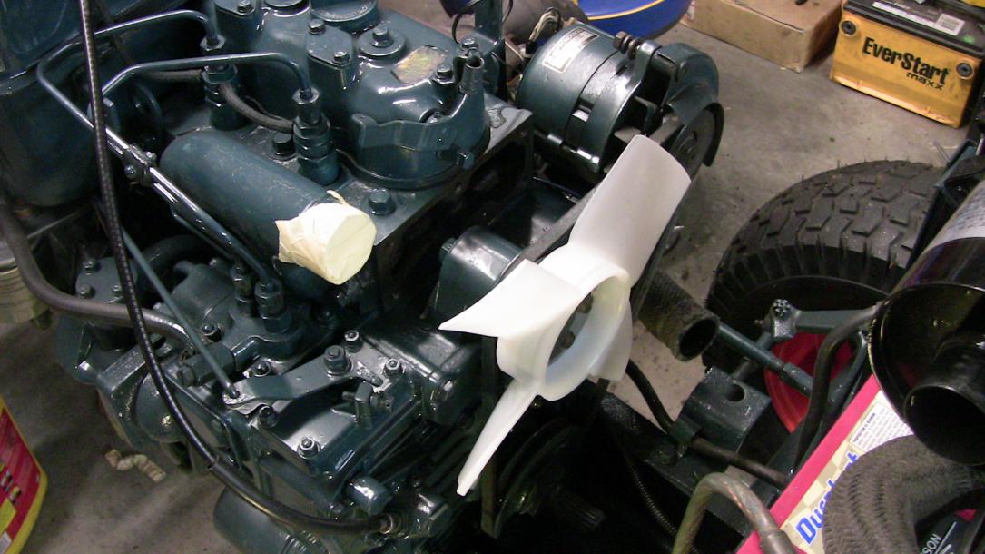

I got the fan today so maybe this weekend I will fire it off, ..............if I can. I have been sick all week and the engine blew up in my Buick so I haven't gotten anything done except find an engine and sleep.

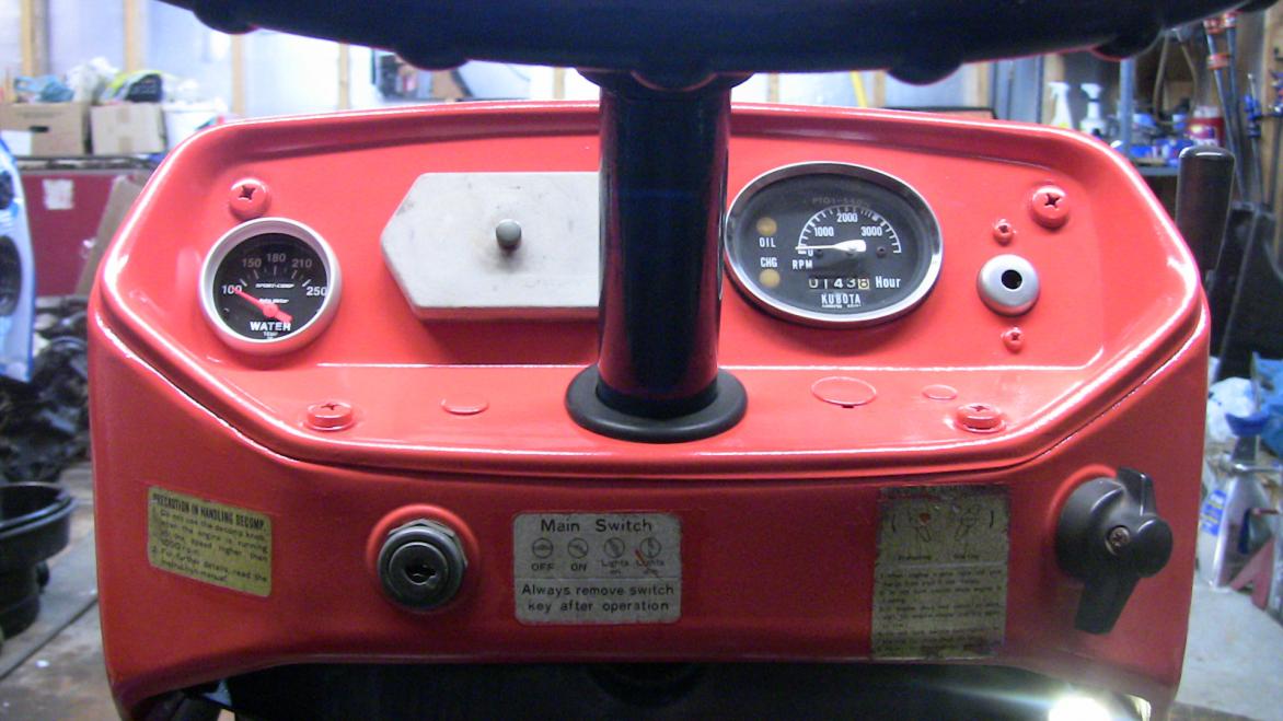

Awesome write up! Now i know where to take mine. :eek::D
What was the thought behind the temp gauge? Which, by the way is a top notch job on adding it to the cluster.
Was it purely as a back up indicator or is the whistle hard to hear?
I've thought about fabing up something to take the place of the fuse box also. :confused: Just haven't studied it enough.
Thanks royboy. I guess your not far down the road from me.
The use of the tractor, where I believe the last straw hurt the head was a hay ride and never in the entire ride did I hear anything and my radiator was full. Since it was full, a temp guage would have told me something because the sensor would have coolant on it.
Also the screamer is only designed to work with water and antifreeze won't help it to work right so the guage can tell me what I need to know.
I plan to keep antifreeze in it so I can use the tractor year round so the temp guage can help me figure out this water only system with different liquids and their temp ranges. If I run a circulation pump then the sensor for the temp guage will also feed a controller for the circ pump to cycle.

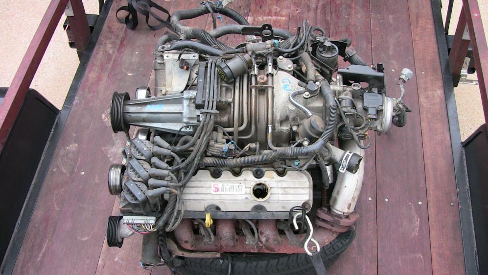

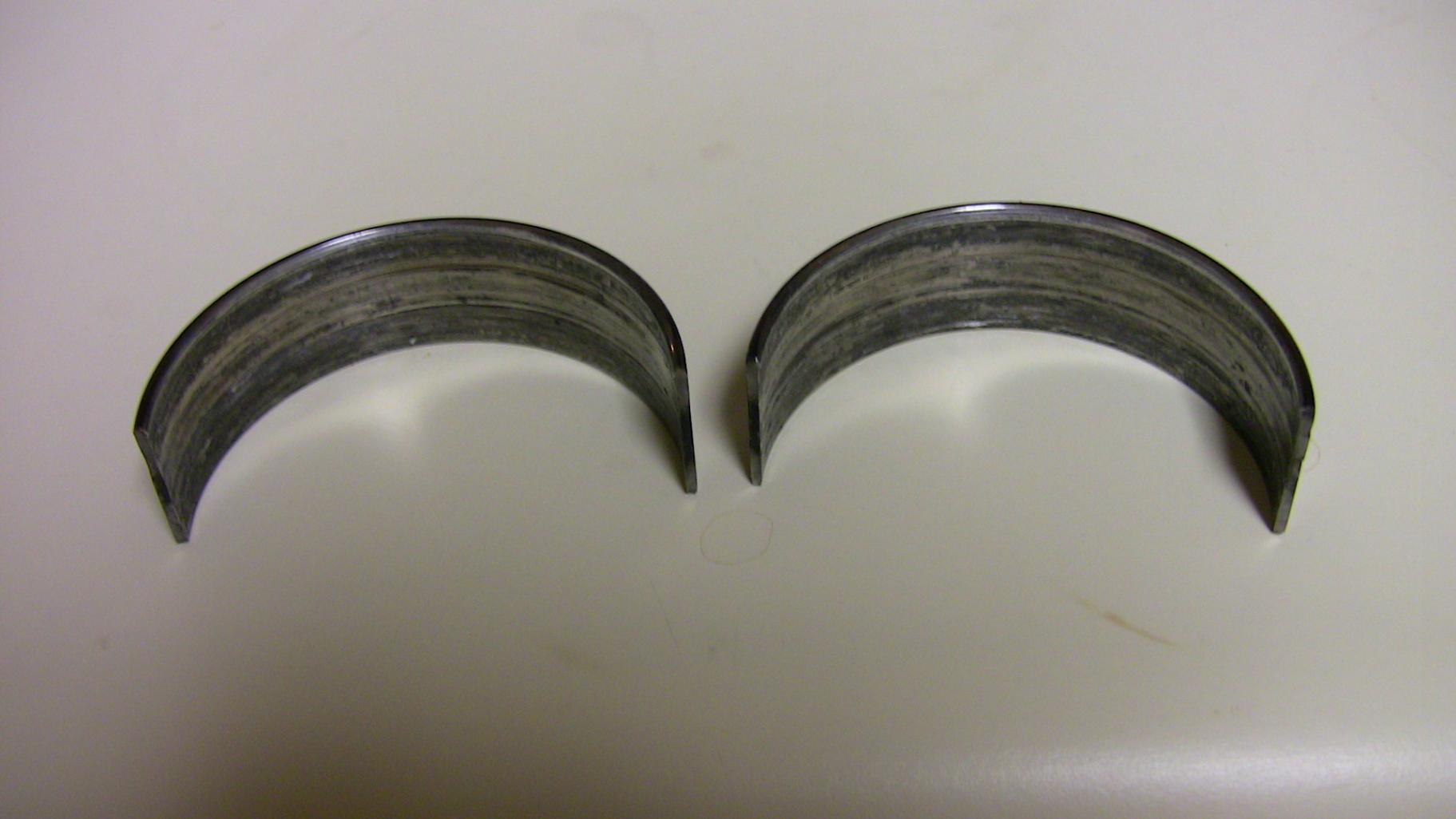

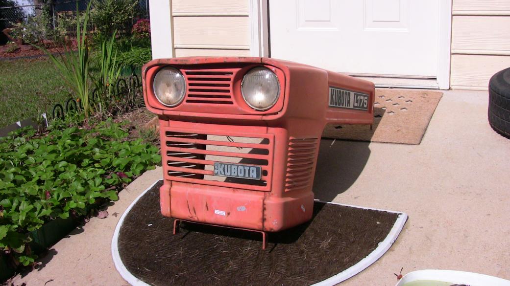

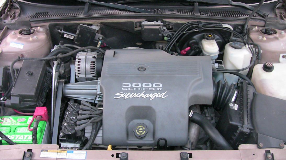

Well when it rains it pours..........we got over the illnesses and now this....:mad::mad::mad::mad::mad:
I got this 2000 Buick Ultra from my dad and it spun #4 rod bearing on the way to the Dr, office.:mad:
Tractor is put on back burner till I can get moma's car going again. :mad::mad:
This engine only had 117K miles and dad was the only owner. He kept the maintenance up pretty well too.
Since metal has run through the oil I am just going to get a whole new (junk yard) engine and replace it.
And I even got another hood for the tractor but can't work on it yet. What a bummer.

Anyway good luck and thats not a bad lookin hood.:D Dusty
Yea I complain sometimes but it's all good.:D
This hood is a cool upgrade too. It is straight for one but also it has a door for the radiator cap where my old bent up hood did not. I'm guessing it is off a latter model L175 than what I have but I like the new feature. :D

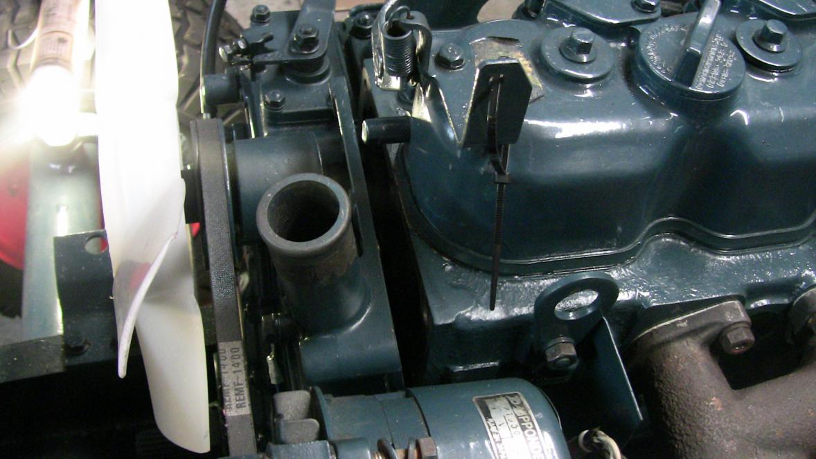

Update :D
I finally fired her up. Purged the injector lines and it popped off like it had never been apart. NICE!
The guage worked very well. I could watch the engine temp move up and down. Perfect!!! I really like how well this temp guage works. Makes me feel much better about running the engine hard now because I can see what is going on with the engine temps.
After running it for about 10 min I had to shut it down. I did not use sealer on the gasket for the cylinder head cover (water neck) and it was leaking as pressure built up. Also the threads on the exhaust were leaking water so they are now sealed up with #2 sealer.
I am still waiting on a gasket for the cover and we will get it back together with SEALER this time. :(

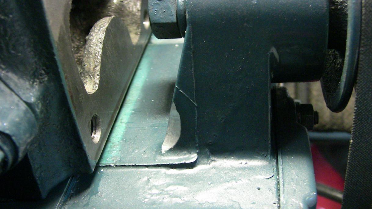

If anyone was to remove this water neck/head cover on this L175 the fan mount that is cast into the front cover is in the way. Simply notch the lower portion of the casting for clearance of the bolts and the cover can be removed without removing the head or engine front cover.
I used a carbide bit (burr bit) that was pointed, some call it a tree shape, and it only took a few moments after the radiator was out of the way to make these small notches and get the bolts out of the cover and remove it.
