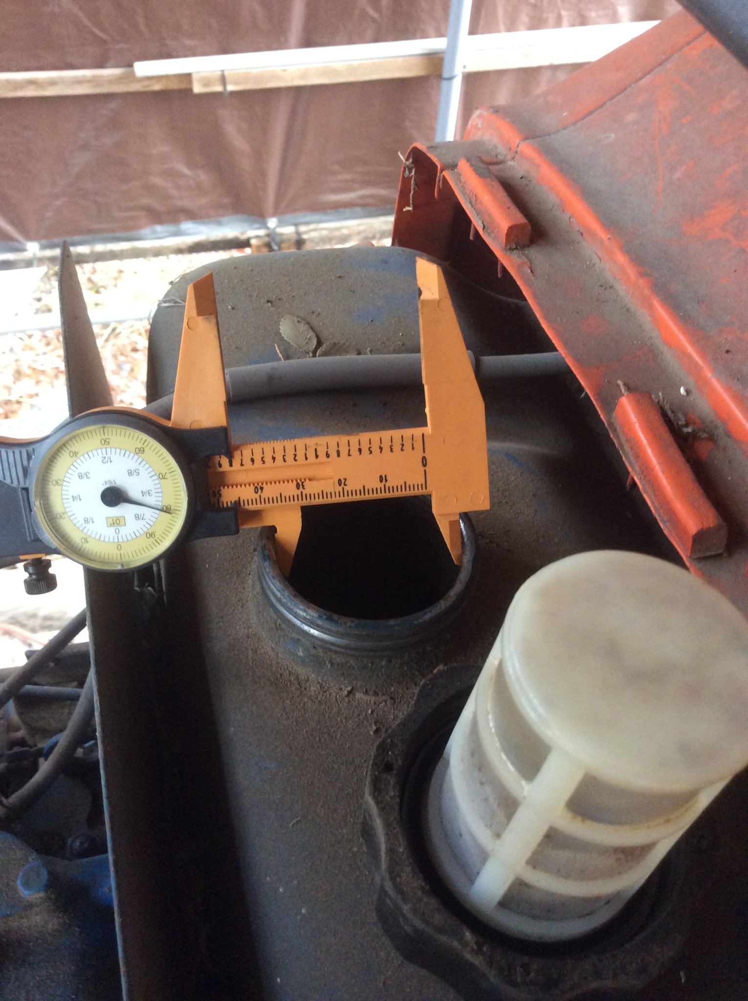

I think the insert for a L185 will fit. It is plastic, not SSt but is a good screen filter. It does slow down how fast fuel can get poured in. Here are some pictures showing the size which match what you need but may be the same instead of smaller. Part number is in another post below.
This is the opening in the tank. (The calipers are inches on top and mm on bottom in this picture). The filter is sitting in the cap. More pictures below.

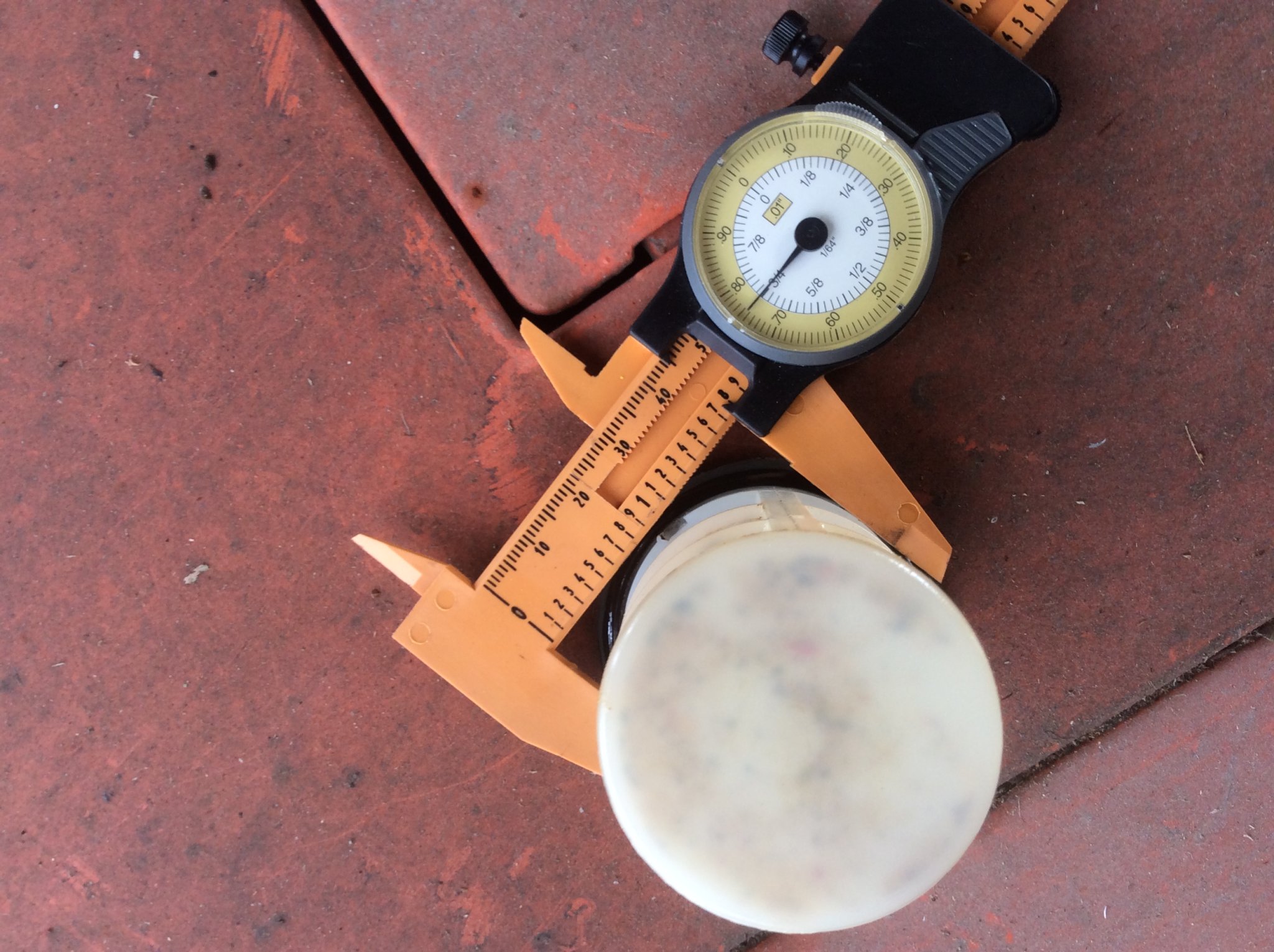

This one shows the body diameter of the inserted portion.
This one shows the flange diameter that stops it from falling into the tank.

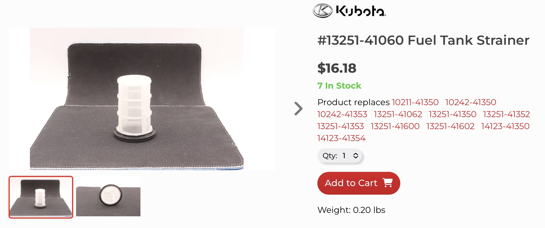

Here is the part number
