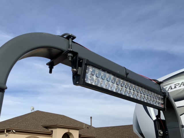

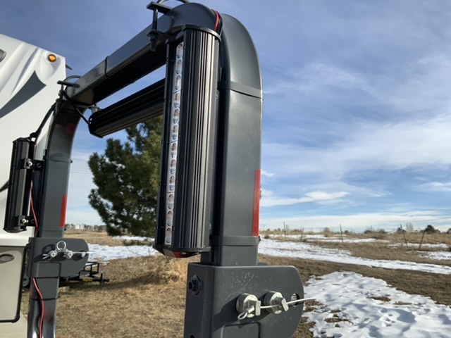

Precisely why we developed these:
http://www.boltonhooks.com/ROPS.html

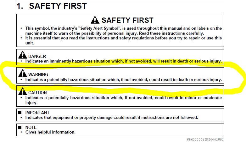

Yes. Good point. That***8217;s why we have warnings on everything. Which brings up an interesting question... I don***8217;t remember seeing a sticker on the ROPS that says drilling or welding may result in death. If this had EVER been the cause of an injury lawsuit, I can assure you there would a sticker.
28,834
5,193
TADA!!!! Your sticker sir!
And from the manual what that warning means!
