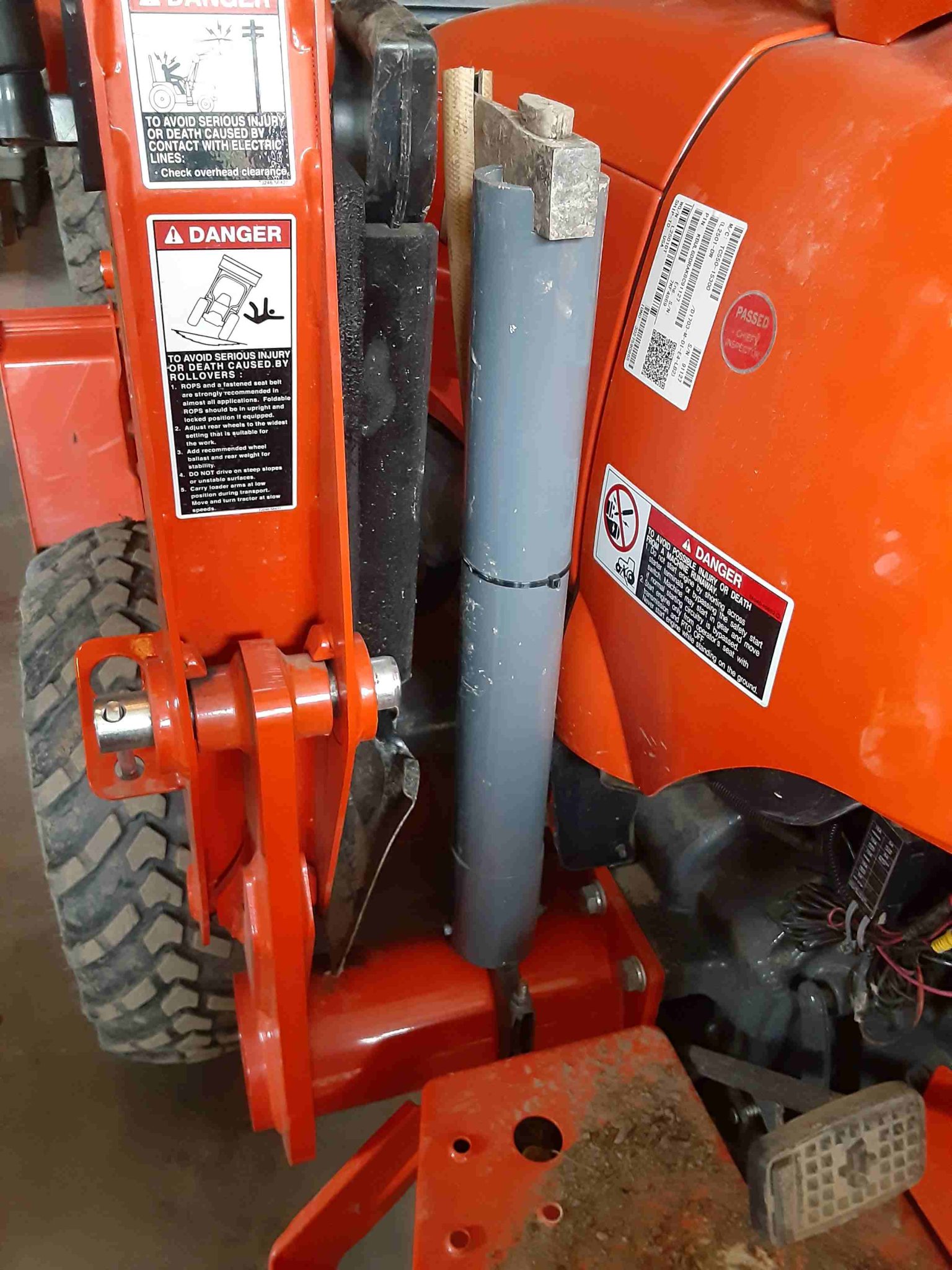

I think this discussion is verging on paranoia. I see no risk of structural compromise from drilling a couple small screw holes in a loader frame.
I drilled and tapped a couple 1/4-20 on each side to mount golf cart mirrors. But for something like a cane I made a mount out of a 5" exhaust clamp that I welded a short piece of metal tubing on the saddle then slid in some pvc about 30" long. Clamping that to the round loader mount I carry and axe that is always handy on the left side. Sorry no picture right now. But the clamp size being 5" you could bolt a pvc cap of any suitable size to it and then add a cane length tube.

This is my axe holder. Something with same or smaller tube could hold cane. Also I drilled for a couple 1/4-20 to hold on the wooden shovel mount I made for a Little Pal square point shovel I use to clean out loader and backhoe buckets. No hydraulic lines were hurt in any of this as they don't exist on this side of the mount. Again, at least on my L2501 and LA525 that large mount tube is 5".

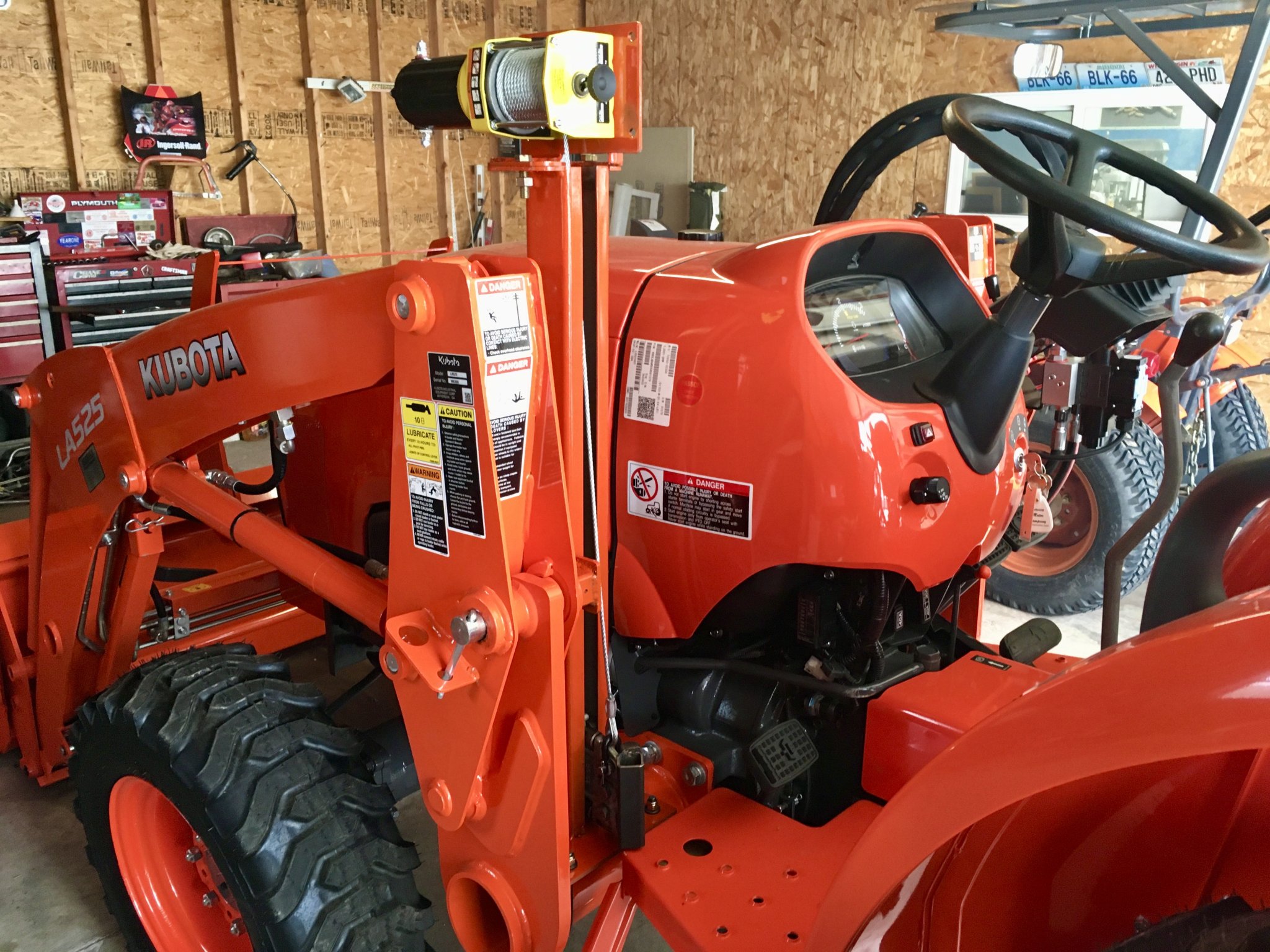

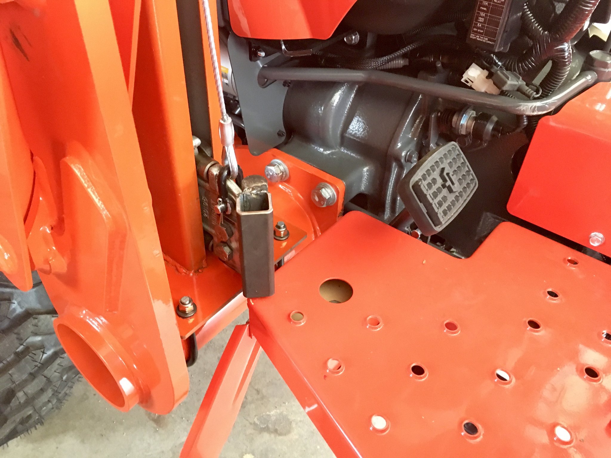

I did something similar when I mounted my seat lift contraption on my LA525 loader frame. I uses 5 inch u-bolts that attach to a 1/4 inch plate.
I also tied into the loader pin to give lateral support due to some heavy side loads when I use it to get up and off my tractor. That 5 inch round with space between the tractor and upright loader bracket really lends itself to all kinds of mounting possibilities. I would have mounted a 30cal ammo can as a extra tool box had I not needed it for my seat lift.
