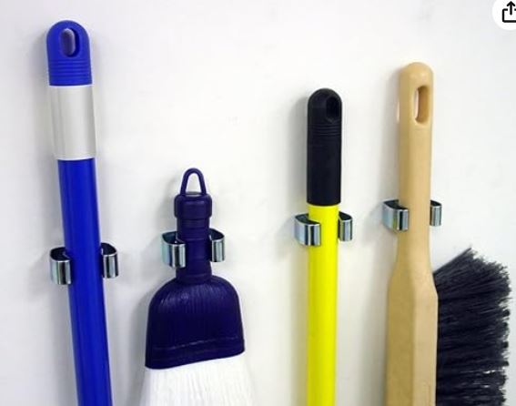

I agree that magnets are the best solution. Combined with a couple spring clamp, the cane should be held securely.

Here's some Spring Clamps
Here's some small Magnets
You'll have to either cut the bolt on the magnet shorter, or use some extra washers to not have it interfere with inserting the cane into the clips.
You could also put a piece of Velcro between the clamp and magnet for added security to keep it in place. Push the cane into the clamp, and then wrap the Velcro.
