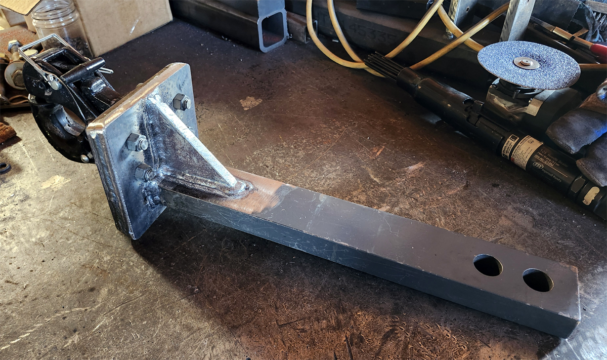

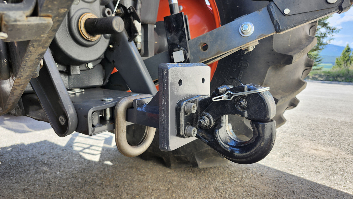

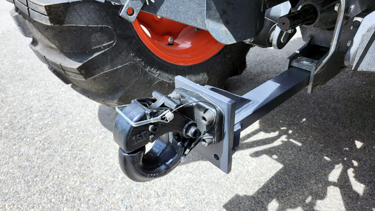

You could weld on a plate to the end of the drawbar and then you can run multiple configurations. I did that for both tractors. The drawbars can be flipped over to change the height of whatever hitch I want to run.
In full disclosure, I also have the original drawbar for the M6060 since it works great with the Land Pride RC3712 folding cutter. I actually got that for free when I bought the cutter since I'd already cut up the factory one.
