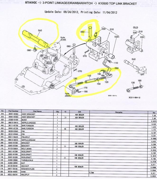

Sunday I removed my pin. My draft work for the first time. I have ask my dealer to contact the power-to-be at Kubota for more info on this. By putting a bar in the backet No 10 -#3C001-81803 the Draft bracket Rod and Turnbuckle moved which allowed the Draft to work. My arms went up over 12 inches highter. Maybe now I can lift my 3 Bottom Moldboard Plow more than 6 inches off the ground!!!!
If you go to Kubota's parts listing for M7040 and then to "3point Linkage/Drawbar Hitch" the K10500 Top Link Bracket - they show the parts. It is pin #050 that must be removed that allows #010 to move Draft rod .

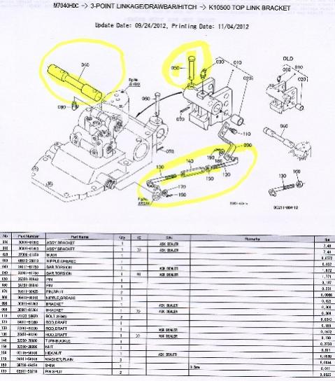

I have had my dealer get back to me about this pin. I will enclose a photo of the parts he gave me.
The pin #050 SHOUND NOT BE TAKE OUT. The part #040 is a torsion bar as you can see slim down in the middle. This made to twist a lttle under load. Heavy load - more twist. He said the grease fitting #030 is there to keep filled so rust and/or water does not get to the #040 Bar so it can move under load.
Now look at the #140 turnbuckle. This he tell us this is used to get DRAFT to work right.
I hope this helps.
