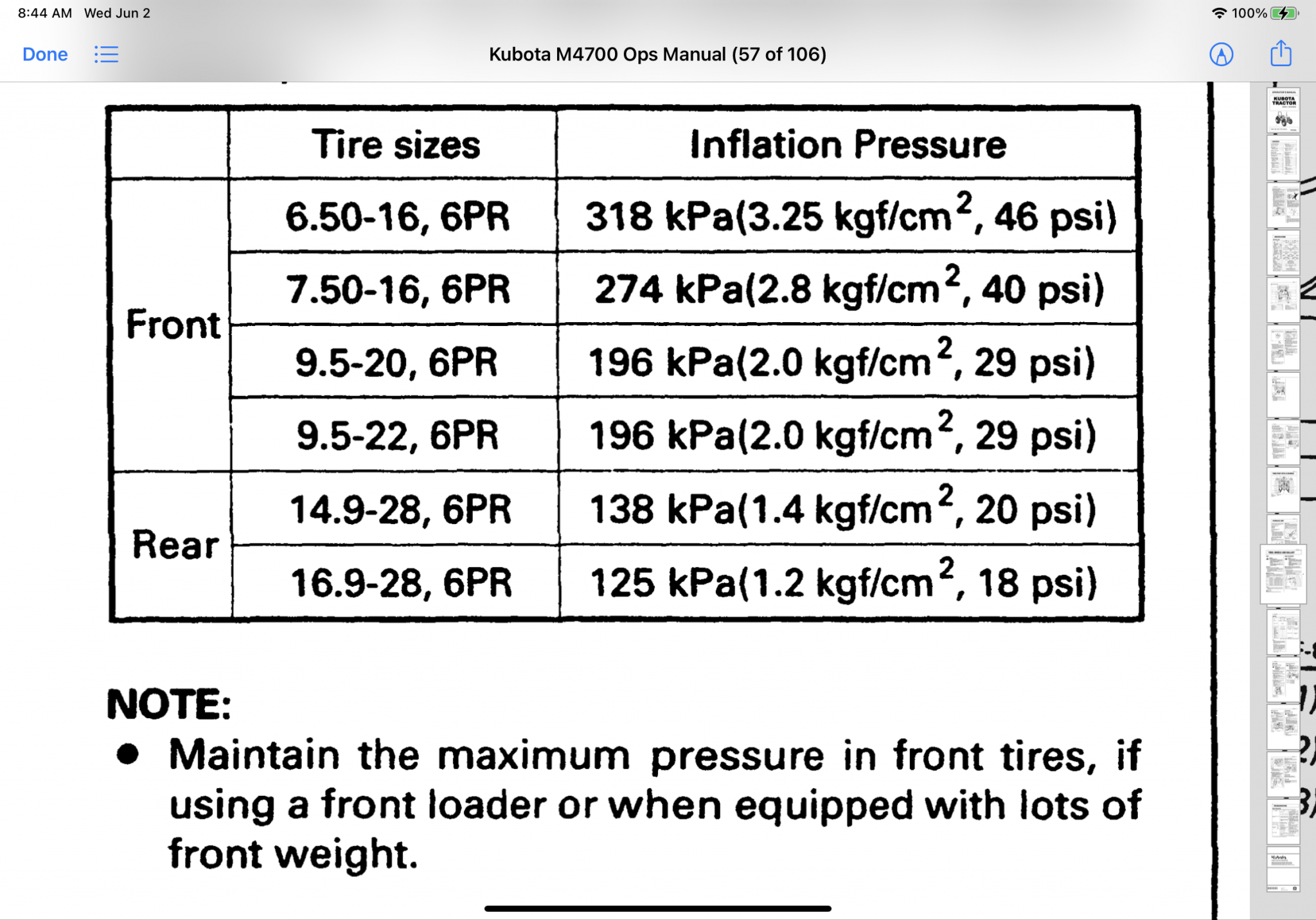

Some Owners Manuals list the ratio - others give tire sizes for the model.
5,825
3,099
Look thru your Owners Manual and the compatible tire-sizes are listed for your model.

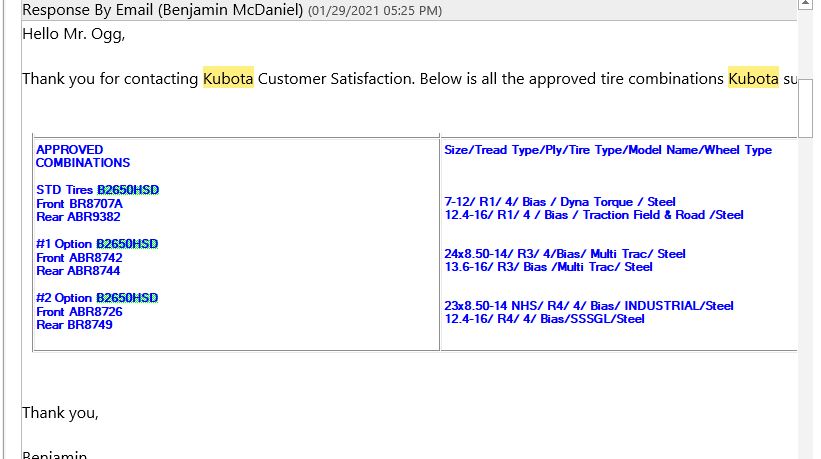

Just for informational purposes, here is what I received from Kubota customer service when I asked about the front to rear axle RPM ratio. I believe that the ratio they refer to as "Gear Ratio" is the front to back axle RRM ratio. Would you agree?
Thanks!

19thSF - The "gear ratio" given on the list ---IS supported in the WSM. The 2013 version of the WSM for B2050 B2350 B2650 B3150 covers all the options - including Bi-Speed Turn, where the amount of front "pull" jumps up on sharp turns . Was that list tied to your serial number?

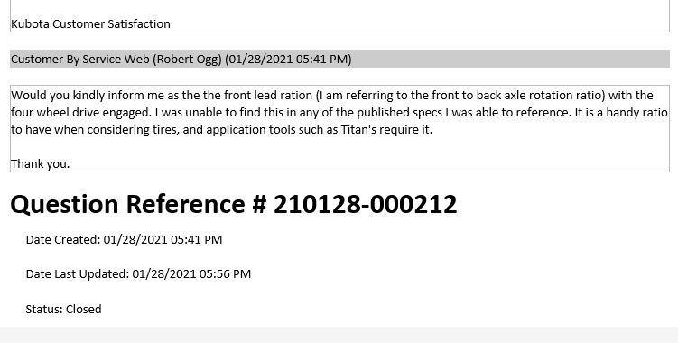

19thSF - The "gear ratio" given on the list doesn't appear to be supported in the WSM. The 2013 version of the WSM for B2050 B2350 B2650 B3150 covers all the options - including Bi-Speed Turn, where the amount of front "pull" jumps up on sharp turns . Was that list tied to your serial number?
I di not mention a serial number. I have attached my inquiry. When I asked them what they considered as the correct lead, they answered with "acceptable tires"

19th SF - does your B2650 have the Bi-Speed option? From the WSM it doesn't affect any other gearing, only kicks in at high steering angle - so shouldn't be a factor here.
I finally did verify the front-to-back axle ratio Kubota gave you, using parts lists and the WSM. I had misread the tooth count on the rear axle gear. All checks out now.
