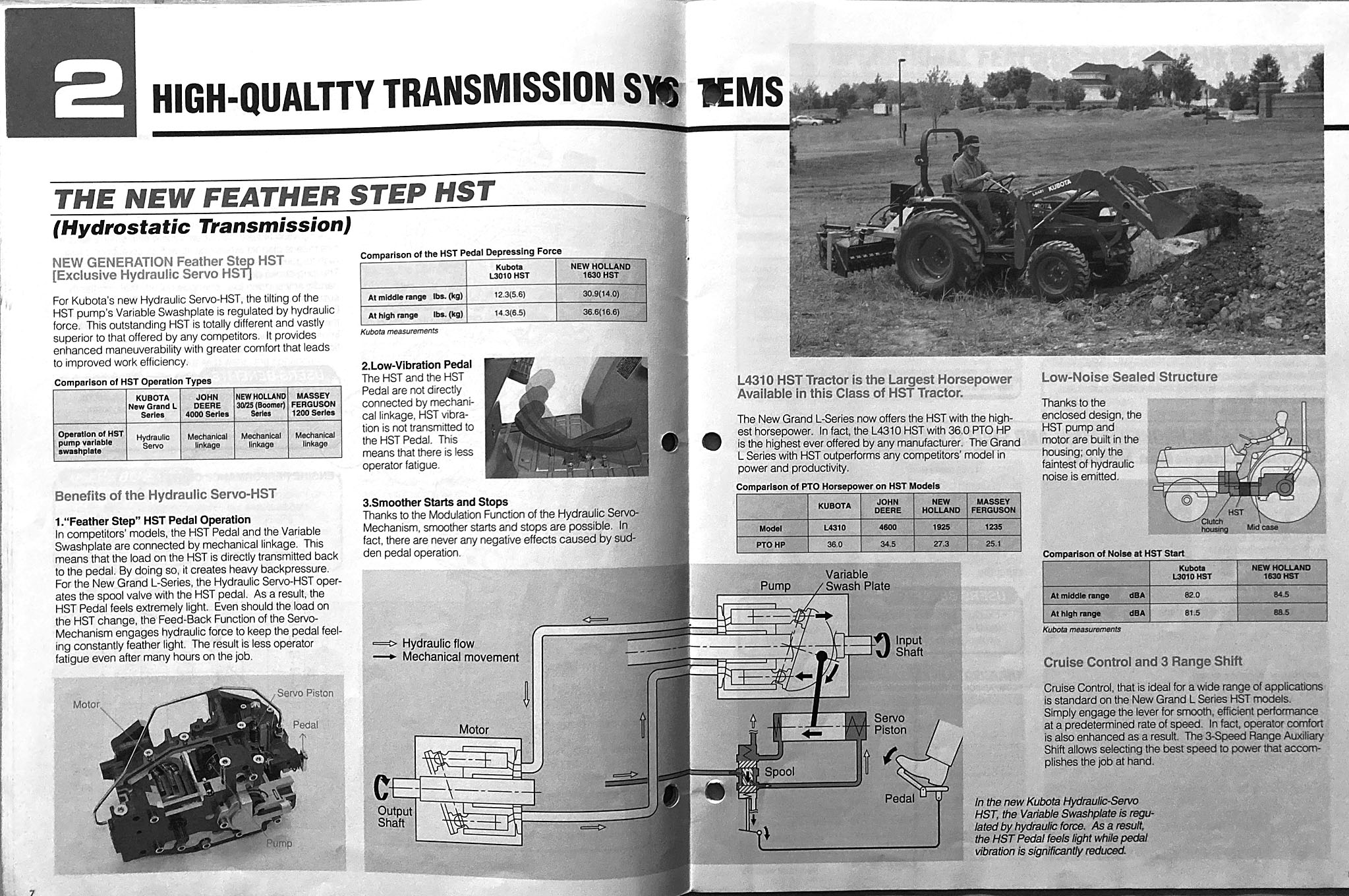

My 2001 L3010 has the featherstep HST, so I'd have to assume it was standard from that point on on the Grand L's. I'll be honest when I say I really enjoy it compared to the notcyness of a mechanical HST. Attached is an article from my L3010 dealer guide talking about the system a little. This was back in September of 98, so I'd have to assume the system has been refined and updated since then.

L4600 was the largest standard L series. It was not a grand L, although the basic transmission design is really the same as the grand L's were.
