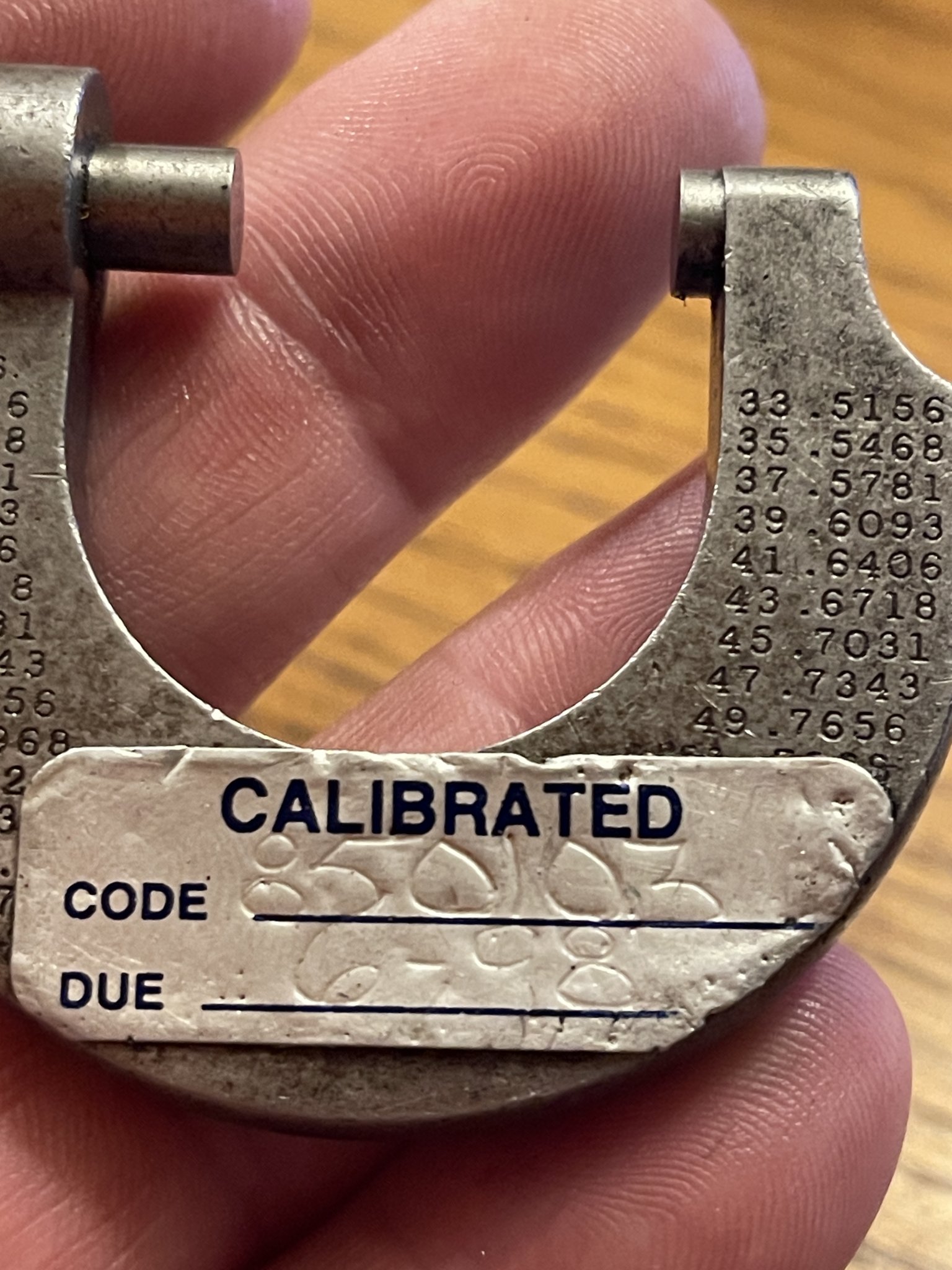

The last time I had any calibration done to my mic was "way back in the day”, when I worked for Chrysler Pentastar Aviation, working on jets.
They required us to turn in our mics to the tool room, and they would send them out to be calibrated.
According to this pic, it has been “a while” ;)

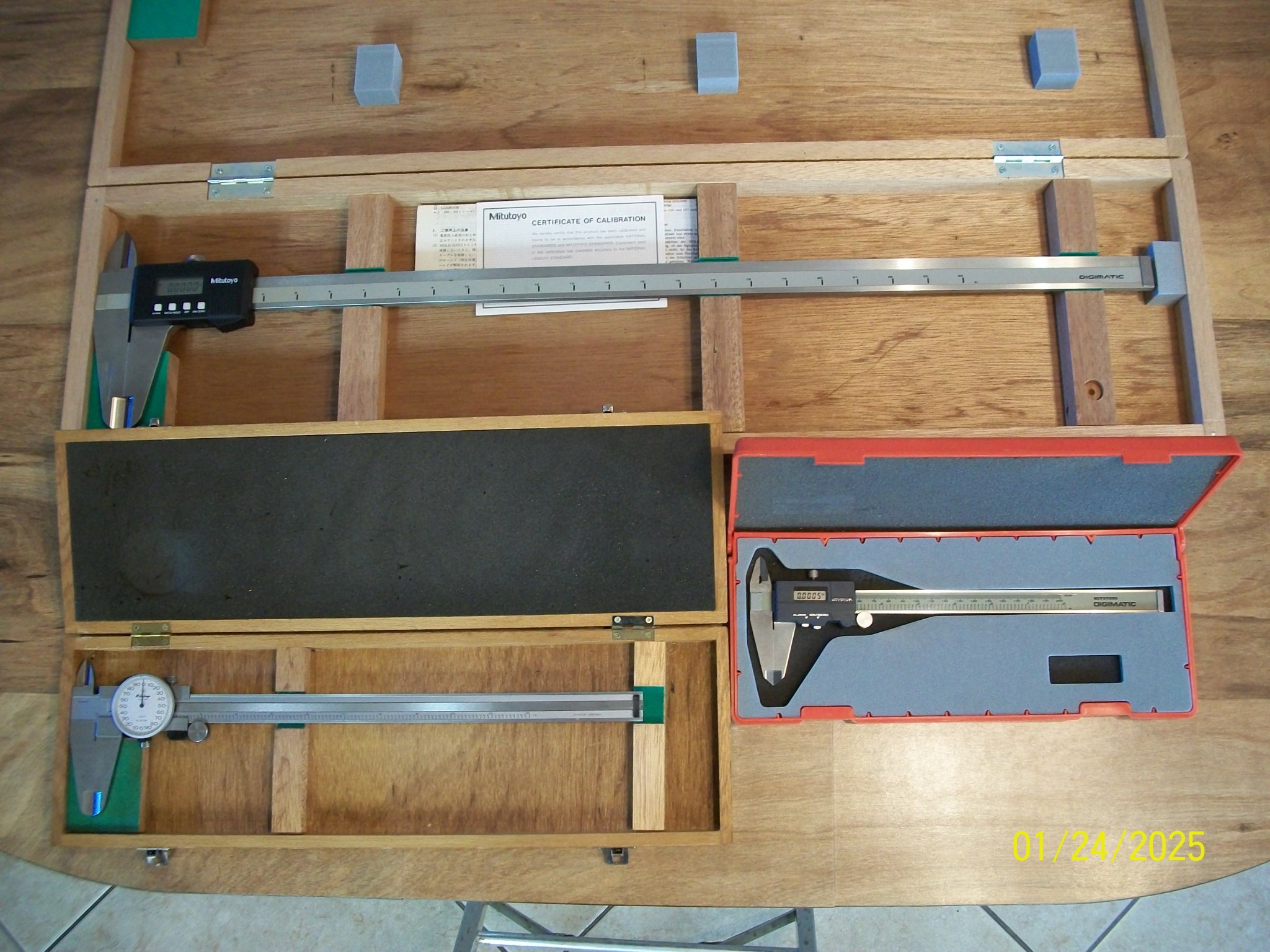

Maybe off topic but I bought this cheap caliper off Amazon and it was dead on with my 1", 2", and 3" standards after zeroing in the closed position. My old HF unit was always hard to keep batteries in so I sought out something better and so far this is that.
Not at all off topic and exactly what you would ecpect. Put it into use where its regularly exposed to a IP67 environment and test it again after 6 months. It will probably become problematic if not inoperative long before that.
The say you only get what you pay for and sometimes not even that.
