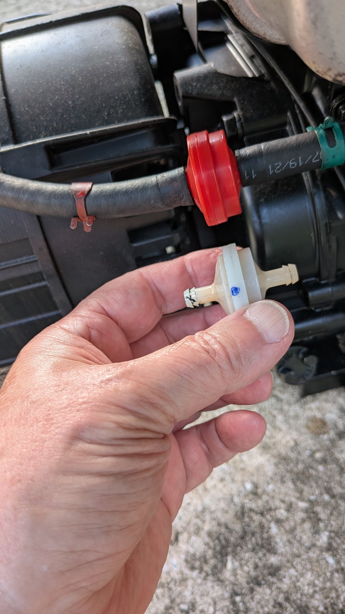

On the other hand, my 4000 Watt Generac from 1992 that I had replaced fuel lines, filters, plug, fuel line etc. last year refused to start. Finally, I figured out that the 1 year old "white B&S" filter would not let a single drop of fuel through. When I reinstalled the original 1992 "red" fuel filter it started right up 🤬. This B&S carb has never ever been drained. It has just has been run until out of fuel.
