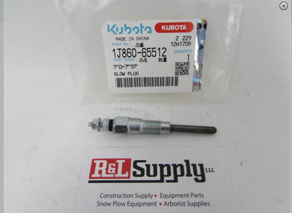

Ive ohm checked, pulled GPs a supplied 12.5v for glow test. They turn red but not white.
Kubota lists 3 glow plug for my model.
19077-65512 (actually NGK Y-716RS 4693)
1J860-65510
1J860-65512

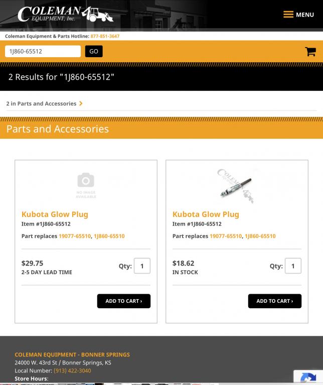

My engine serial number matches part number 1J860-65510 but is superseded to 1J860-65512.
Sent email to Kubota Corp and asked about the glow plug change-superseded. They acknowledged the change but couldn’t answer why.
I’ve always been partial to the NGK with Japanese vehicles, so I am tempted to just get the NGK glow plugs.
Anyone know why Kubota superseded these numbers?
My glow plugs were unmarked.

They do superseded numbers when there is an update, in this case it's probably no more than a update of the part numbers.
The kubota glow plugs are more than likely NGK as all of the one's I've gotten from kubota are NGK numbers on them.
I don't think they change temps, they either work or they don't.
Most newer glow plugs designs don't get as hot as the older ones, as they don't need to to work properly, and because of the lower working temp they last longer. ;)

In my limited experience with Kubota 'superseding' parts has been two observations.
1) An improved part is available.
2) Kubota combines identical partnumbers into a single one which covers more models. (ie P/N for bolts,washers and other fasteners)
Personally, I would go with the latest supersition available just incase it is an improved replacement part.

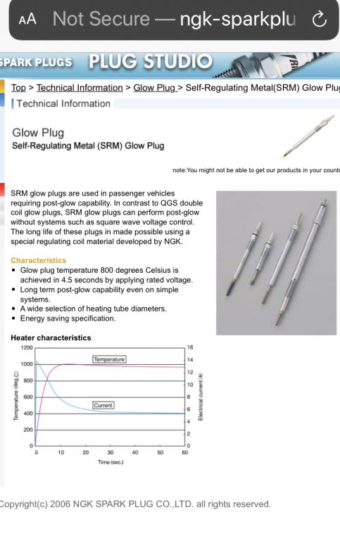

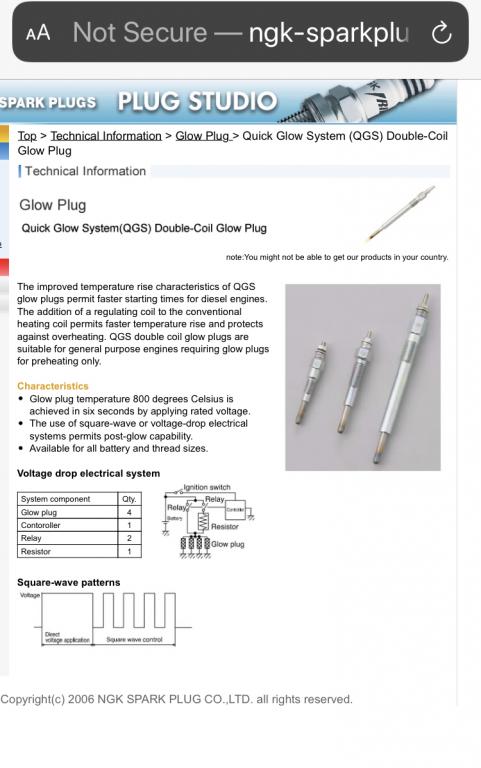

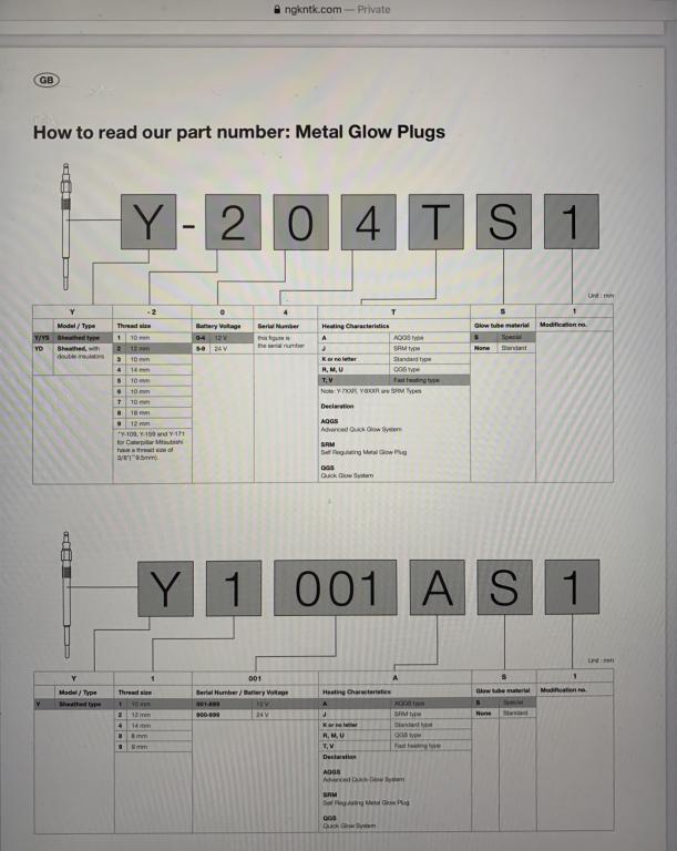

Found interesting information on NGK glow plugs.
http://www.ngk-sparkplugs.jp/english/techinfo/glowplug/index.html
Interesting note, (heat time) varies on rated temperature output of 800 Celsius, 1472 degrees Fahrenheit. The two types attached are 4.5 seconds and 6 seconds.
They are rated 800 Celsius 1472* Fahrenheit
The Y-716RS is
Y=Sheathed type
7=10mm
1=12V
6=serial number
R=QGS but note says Y-7xxR are SRM type
S=Special glow tube material.
See attached pictures for QGS & SRM descriptions or use link.
