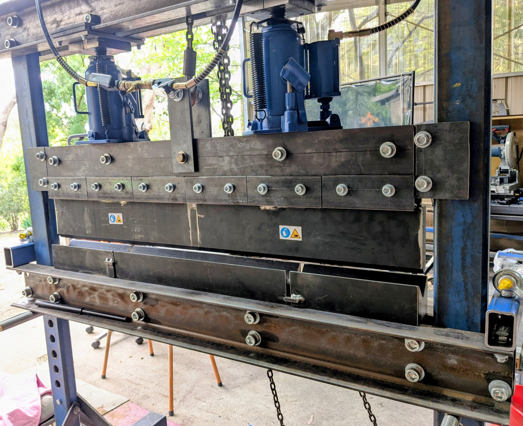

Thanks Hugo. When checking pressures after getting the hydraulics connected for the loader, found that the tractor relief is set to about 1850 psi. That needs two 5.5" cylinders to give me 40 tonne - I have two 20 tonne jacks on the press.
I think I'll leave it as it is - the speed doesn't really matter to me.

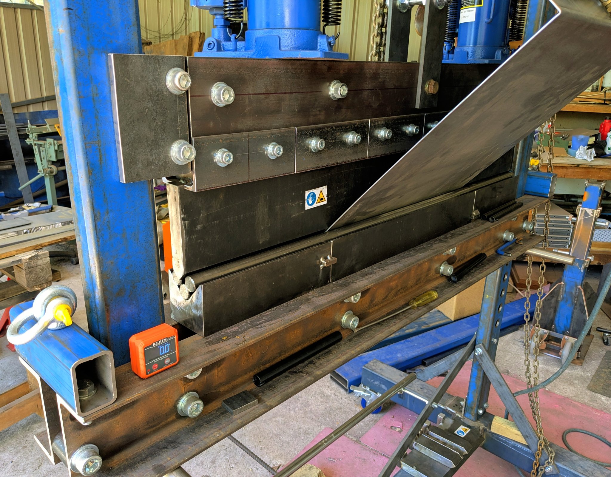

Here's an example of the use of one of the long narrow top tools. The sheet I bought for the bucket just happens to be 1220 mm wide (4 foot) rather than 1200 mm and my rolling is 600 mm wide per set. So I've spread the two 600 mm top tools and inserted a 20 mm piece.
Ideally I'd do the same for the bottom tool but I don't have extra bits for this and for a loader bucket that's going to scrape around in dirt and rocks it won't really matter.
Probably doesn't matter much for the top tool in this case either, but I made it so I thought I may as well use it.

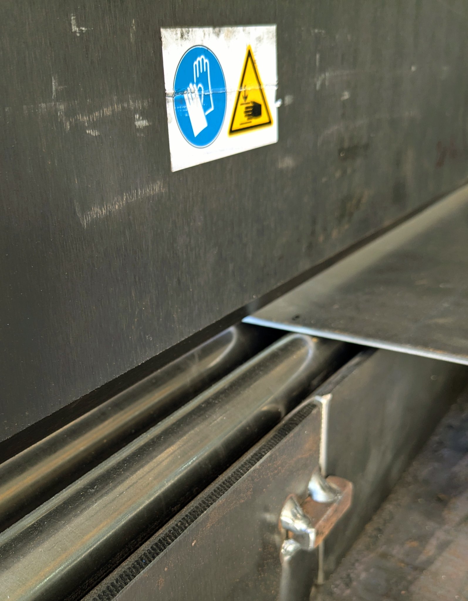

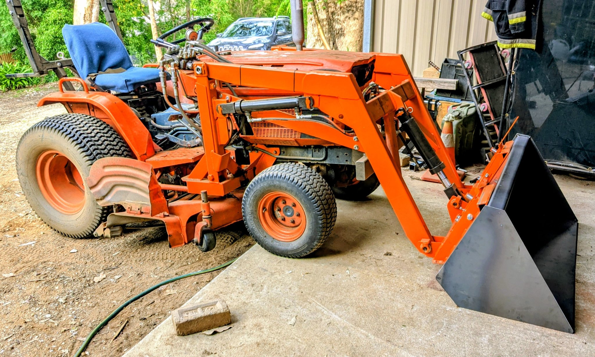

Pretty happy with how the press works so far. It bent the 3 mm over 1200 mm for the loader bucket like it wasn't there. Easy enough to adjust the fold angle to get each end even with a quick tap on the air valve for the side that needs it.

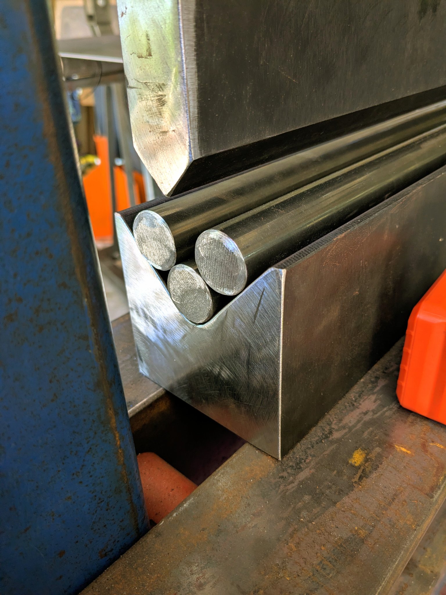

I'll also try reducing the width of the bottom vee by laying 3 x 1200 mm long 1" diameter bars in the vee. This will increase the bending force but also give a tighter radius bend. Don't think I'll always want the big radius that you get with a wide vee that is quite ok for the bucket.

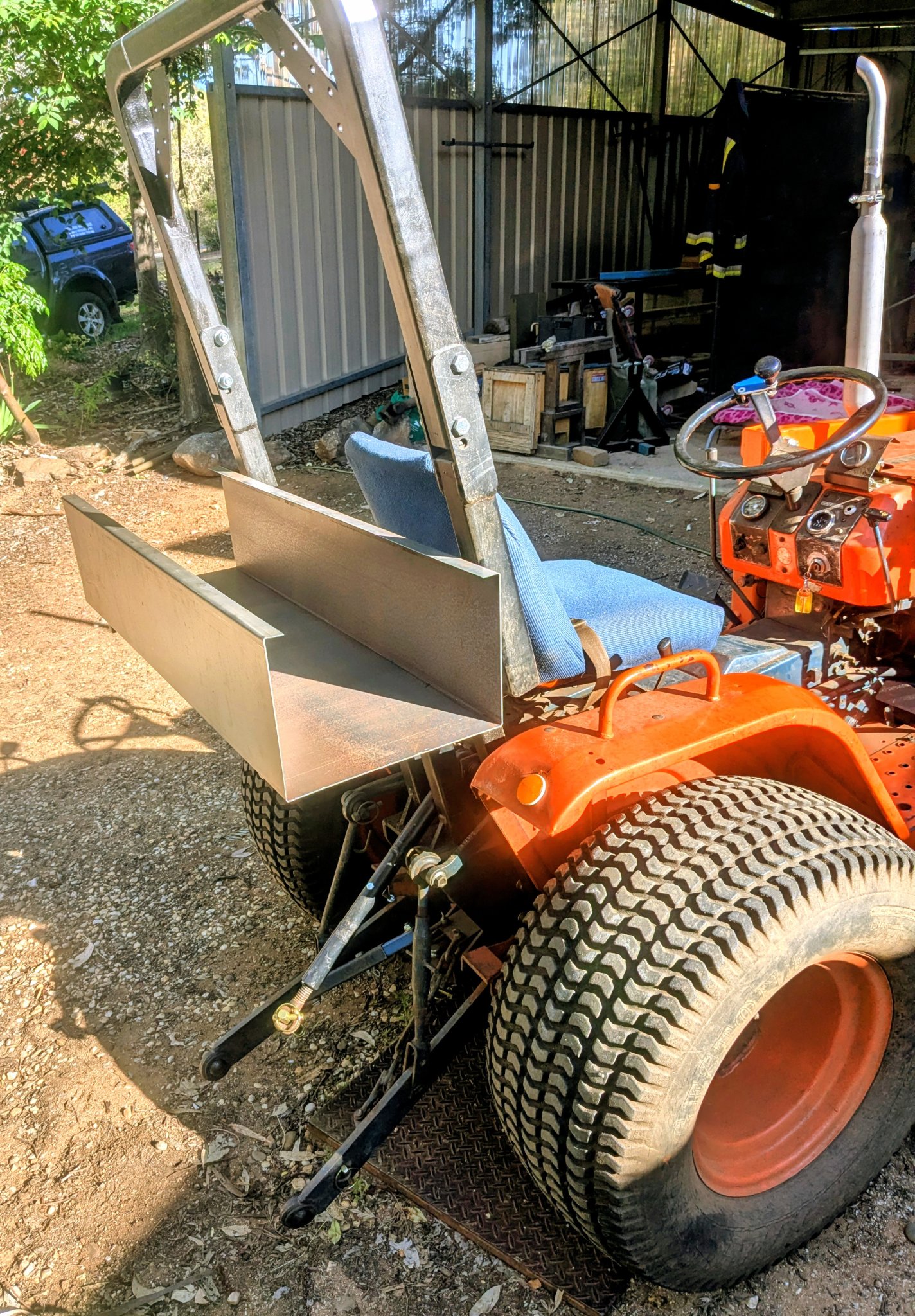

I bent some of the 3 mm steel sheet that was left over from the loader bucket today to enclose 3 sides of the ballast box. I laid three 1" diameter bars in the bottom vee to effectively narrow the vee aiming for a tighter radius bend. It worked out pretty well - nice easy easy to make a narrower vee.
3,954
5,329
Good idea.
I would have thought that those 1” bars would have “moved” when the force was applied.
I will have to try this trick on my “mini” brake.
Thanks for sharing that (y)

Good idea.
I too wasn't sure if it would work or if the bars would move, but they stayed in place enough to get a 90 degree bend.

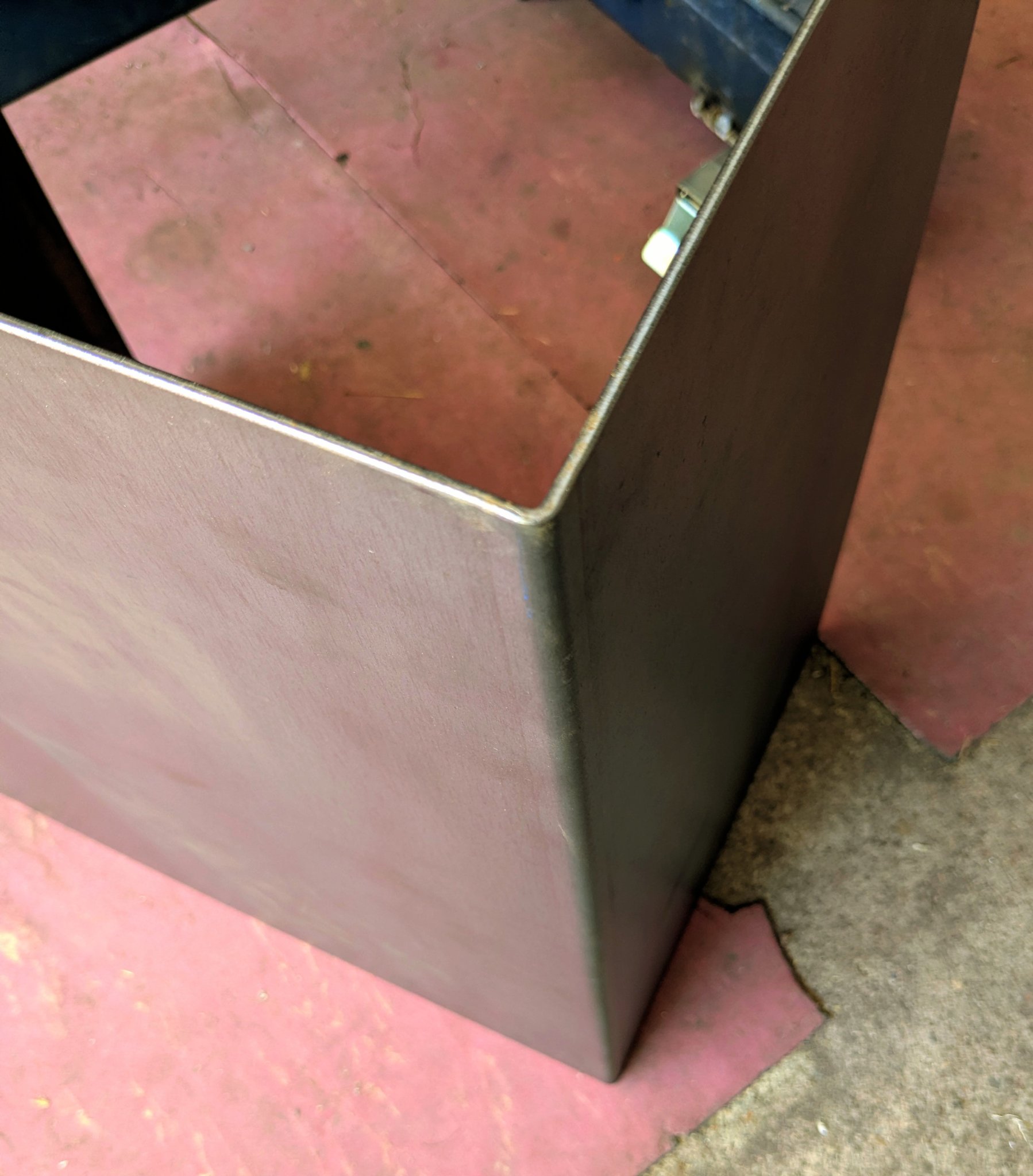

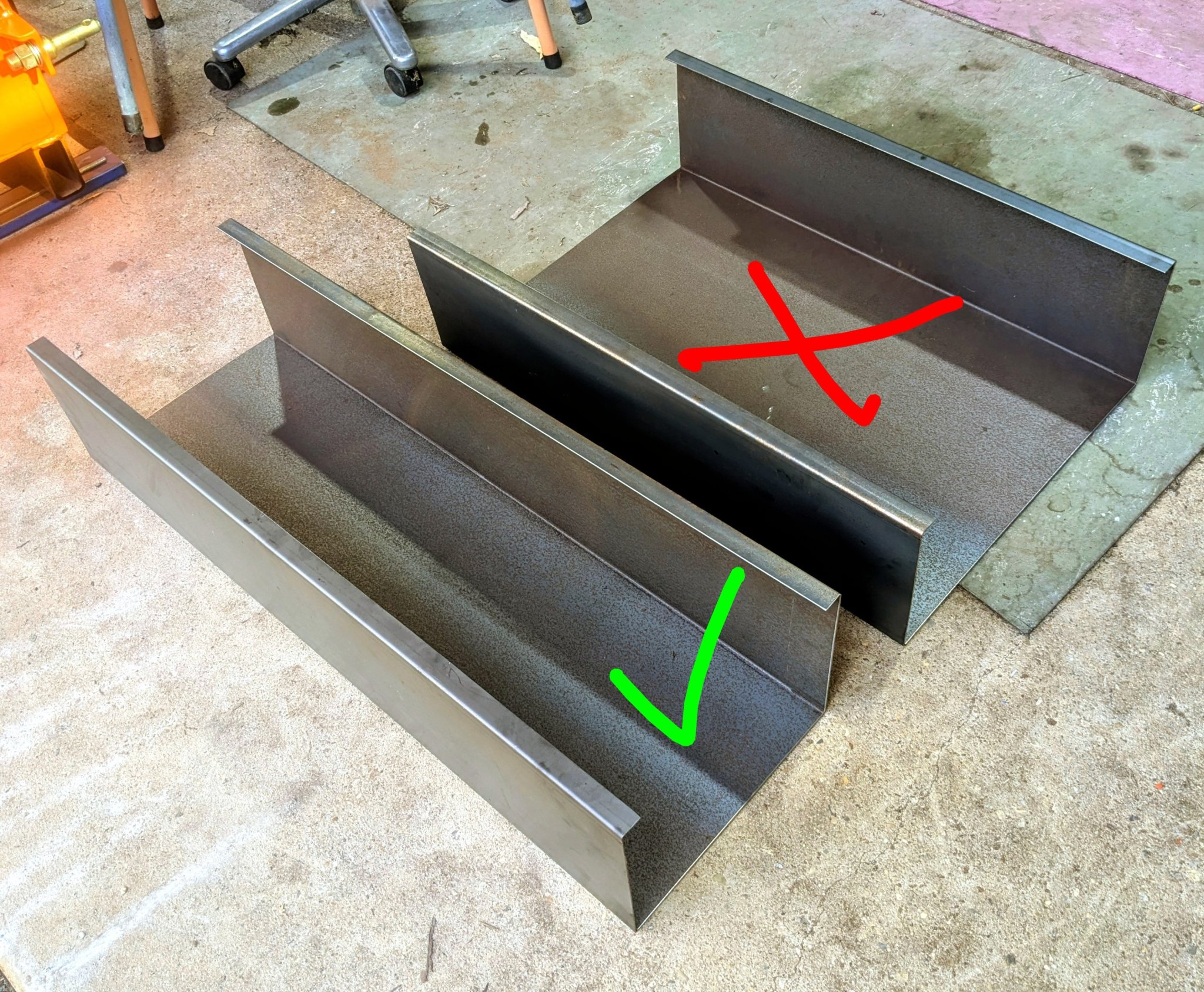

There's probably a few here who remember when calculators were first introduced. If you didn't know what you were doing they helped get the wrong answer a lot faster.
Well this new press is a bit like that.
The 2 folded pieces in the pic attached were folded from the same size sheet - the first one I folded the wrong way. The second one is right. The press helped me mess it up much faster than I normally would have.
Measure 398 times.....
This is the beginnings of a toolbox to mount on the 2 bars sticking out the back of my ROPS.

After initially using the press under a chain block to lift the blade I added a piece of heavy RHS as a counterweight. It works well.
I still need to do something better with the air controls as it's pretty awkward to use with a large sheet as it is.
