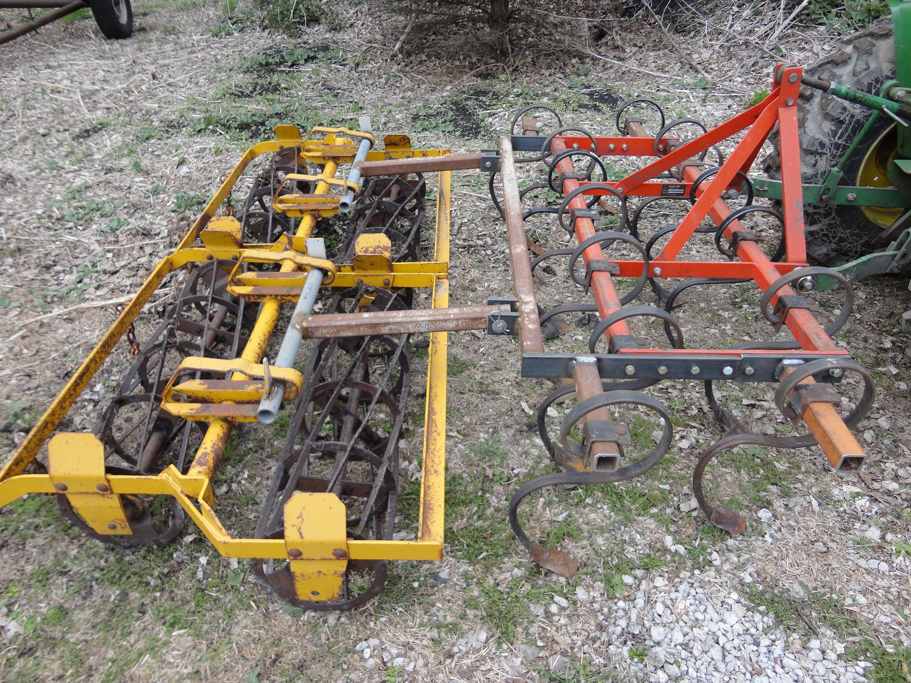

Here's a pic of my 5 ft cultivator modified to accept a couple of rolling baskets and extra s-tines to match their width.

The rolling baskets that I found and added to the little cultivator have done a pretty good job prepping a seed bed. But for them to work near as good as a tiller.....your soil conditions have to be right. And most everybody's ground is a little different. Soil too wet and the cultivator turns up clumps that the baskets can't break down. Same thing if its too grassy/weedy. But if you're soil conditions are right and you've got enough knives/shoes on your cultivator to bust up and loosen the soil in front of the baskets.....then it's quicker than a roto tiller. The roto tiller does a finer job and is a little more forgiving on the soil conditions. Plus you can lift the tiller when turning, back up and lower, etc. Like everything, both have their advantage and disadavantages. Nothing wrong with having both. :ROFLMAO:
If you have a good cultivator, you may not need the plow? But the cultivator and rolling baskets would certainly do a good enough job for broadcasting the grass seed you mentioned. Wouldn't hurt after seeding that way to run a drag over the area to somewhat cover the seed again.

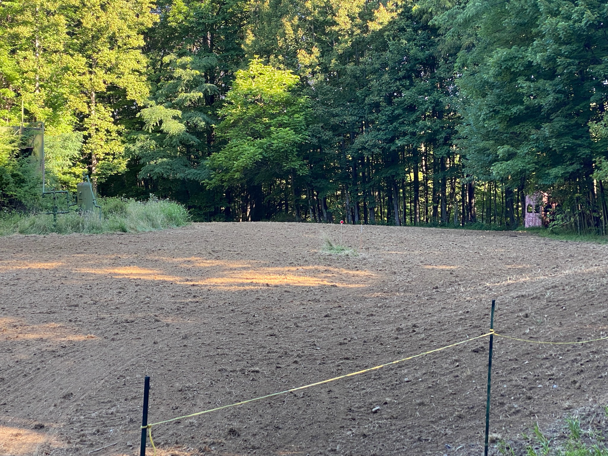

If all you are doing is making food plots for the wildlife to feed on, I wouldn’t waste too much time and fuel getting it smooth. They aren’t going to care as long as your crop grows. If you are planning on harvesting crops from what you sow, then you want it smooth for a better harvesting experience. The crop will grow fine regardless how smooth it is as long as you get it in the ground and get a good germination.

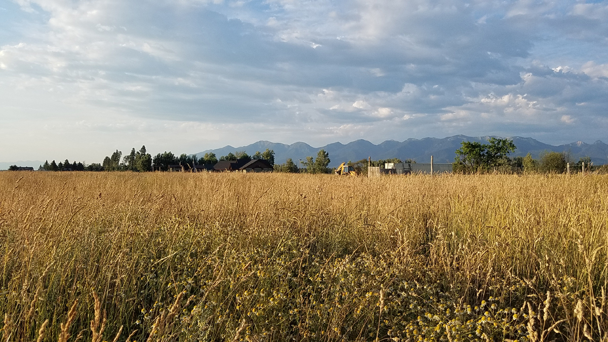

The objective is to avoid this .... 10 acres or so of a 4ft or taller mix of weeds, more weeds, some grass and more weeds. If we can grow something that is good for his bees, good for upland birds, good for deer, can be maintained, and that looks good to stop or reduce complaints from surrounding property owners and visits from the county weed department my friend will be very happy. If I can help him achieve this I'll be very happy! :)
