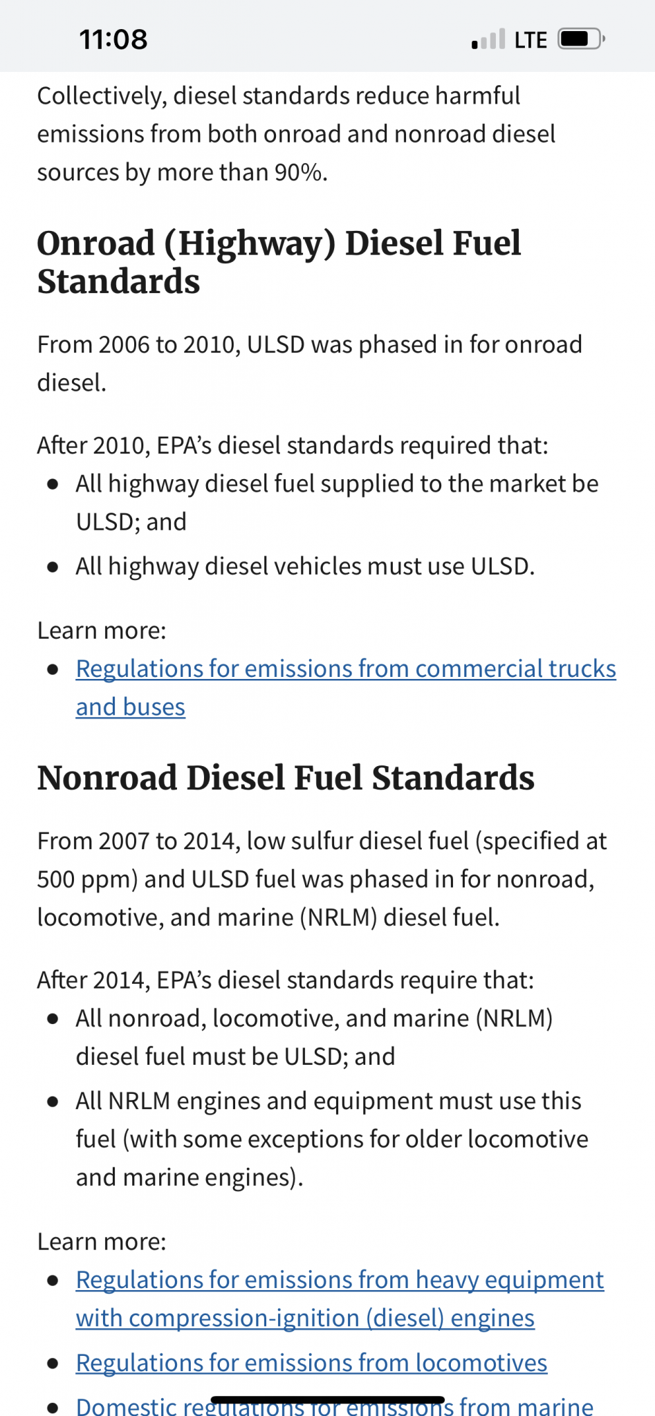

off-road diesel is dyed, so never,ever get caught driving your ride with it ! You'll be in for a lengthy audit from the taxman...

Fordtech86-thank you for the off road diesel intel. Great stuff.
