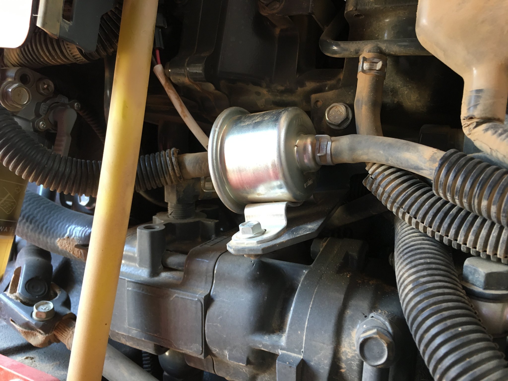

I have the manual that came with the tractor. The photo that I sent, is what is clicking....Is that the fuel pump? All attempts at charging and starting were done with the dead battery attached and Tractor.
I believe so. It is called an "electromagnetic fuel pump" by Kubota. You can check by following the tubes. It should suck fuel from the fuel tank via the water separator and transport it to a reserve tank before going to the fuel filter if it is same as my L3560. You can also download parts diagrams for free from Messicks website or from Kubota.
