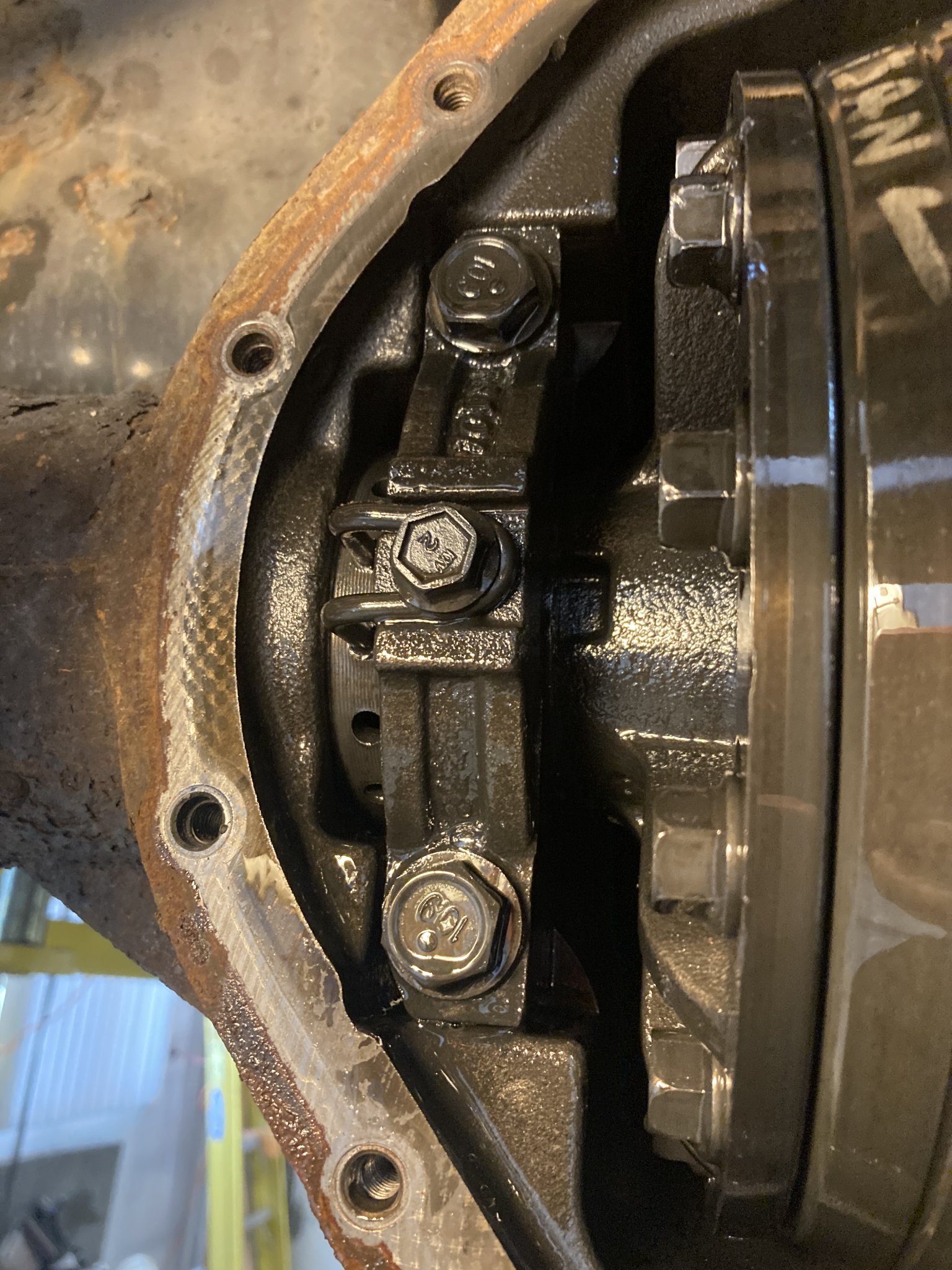

I pull the cover off and it’s immediately clear what has happened.
David Copperfield has made my “retaining bolt and retainer” disappear…….
It should look like this.

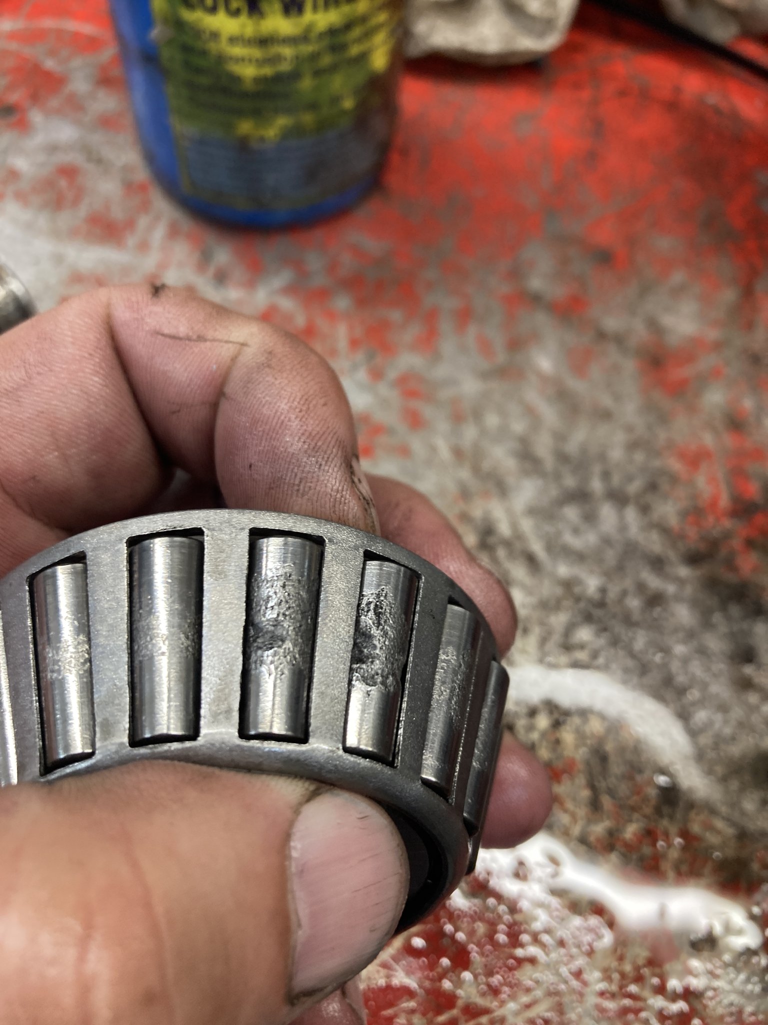

So I inspect all the bearings and pull the carrier apart…..
The “aft pinion bearing” is pretty much “toast”.
The race is equally F’d up.
However,…..strangley enough the “forward pinion bearing” and the carrier bearing are relatively unscathed.
I might even venture to say that all the other bearing could be “re-used”, but I am neck deep in this and the bearings are all already bought, so…….They are going to get replaced.

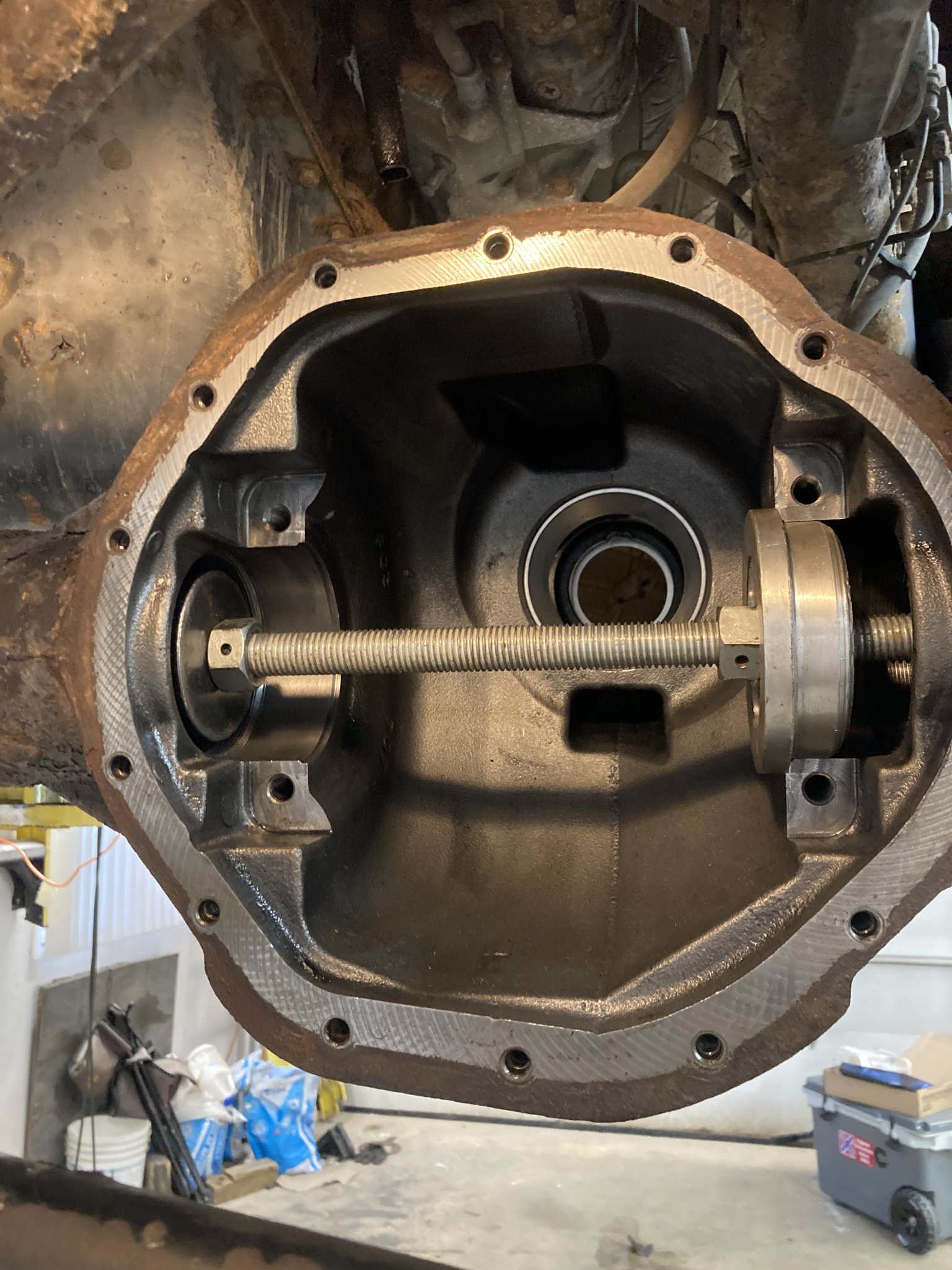

Well now I begin to remove the other bearings with my new “bearing removal” tool.
Then begin to press in all the races.

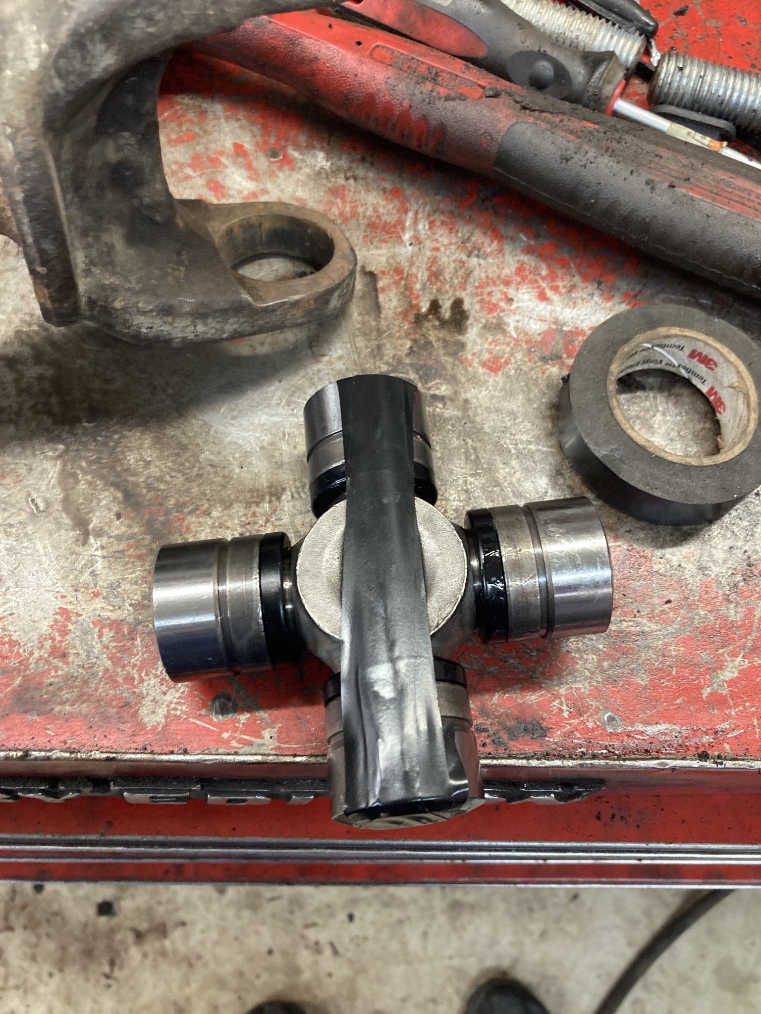

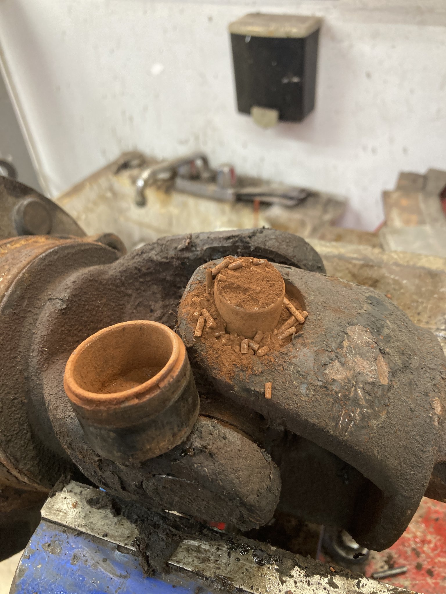

So as I pick up the starboard axle shaft/hub assembly….I feel a “clicking”……Hmmmm??????
I could have sworn I just replaced this side not too long ago…….But I’ll be damned…….
Apparently one of the cups was not getting grease…M______________R!!!!!!!
That bitch was toast…….So another 100 dollars, and a day later, my new “greaseless Spicer U-joint” show up…..
ATTENTION!!!!!!! For those who have never “read" the Spicer Greaseless packaging (like I didn’t the first time I used one) You MUST keep the caps in the order they came.
HEY SPICER…..Thanks for putting those directions in BOLD, BRIGHT letters for the guys that don’t read the directions, becasue they have been replacing U-joints since Jesus was a Corporal……a$$holes……..
Now I have one that was put on keeping them in order, and one that I f’d up and mixed them, so I guess we will see the difference in “life” between them.

I'm going to say the more likely option is someone has been in that axle and put the retainer wire in place and simply forgot to put the bolt on it. ;)

High pinion Dana 30s are good to have. But the bolt and clip I never remember seeing.
If so, then they snuck into my garage at night and did that, cause I drove it "off the lot” when it was brand spanking new, and haven’t touched that axle since...;):)

I doubt the bolt & clip were chewed to dust. That was a Friday or Monday diffy and the bolt was never installed.
Noise made by that diff’ would have likely been on acceleration…. due to the rear pinion bearing going-out. That ring gear is so beefy, it might have gone another qtr-million miles without trouble, except for the pinion bearing.
