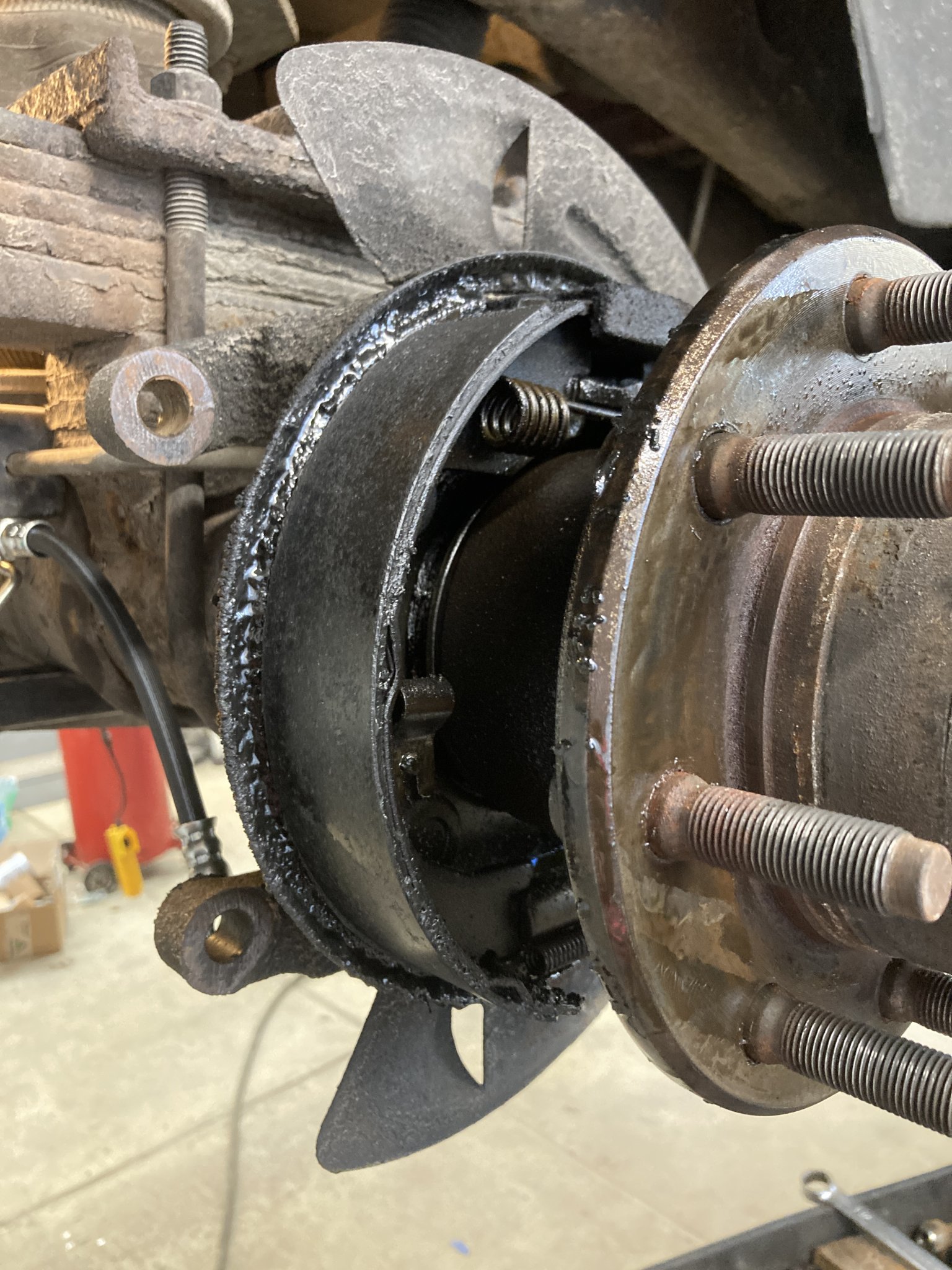

The rear axle magnet looks "pretty good".......However both outboard axles are leaking "pretty good", and the oil has saturated my "Parking Brake", rendering it basically useless.
Here are some pics from about 6 weeks previous when I was replacing the rear pads and rotors, so I do know that there is some "axle servicing" in my "near future".
I dont have a pic, but the other side is equally as bad.

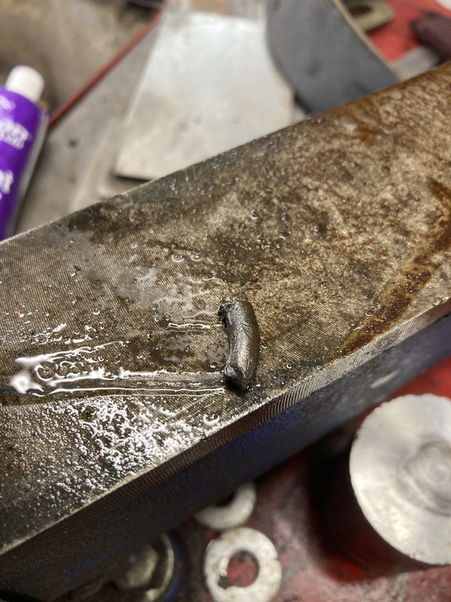

Well when I pull the front diff plug, this appears on the magnet......................
DAMN IT!!!!!!
M_________________R!!!!!!!!

I can't tell what i'm looking at either. Looks too large and circular to be a piece of a shim or thrust washer.

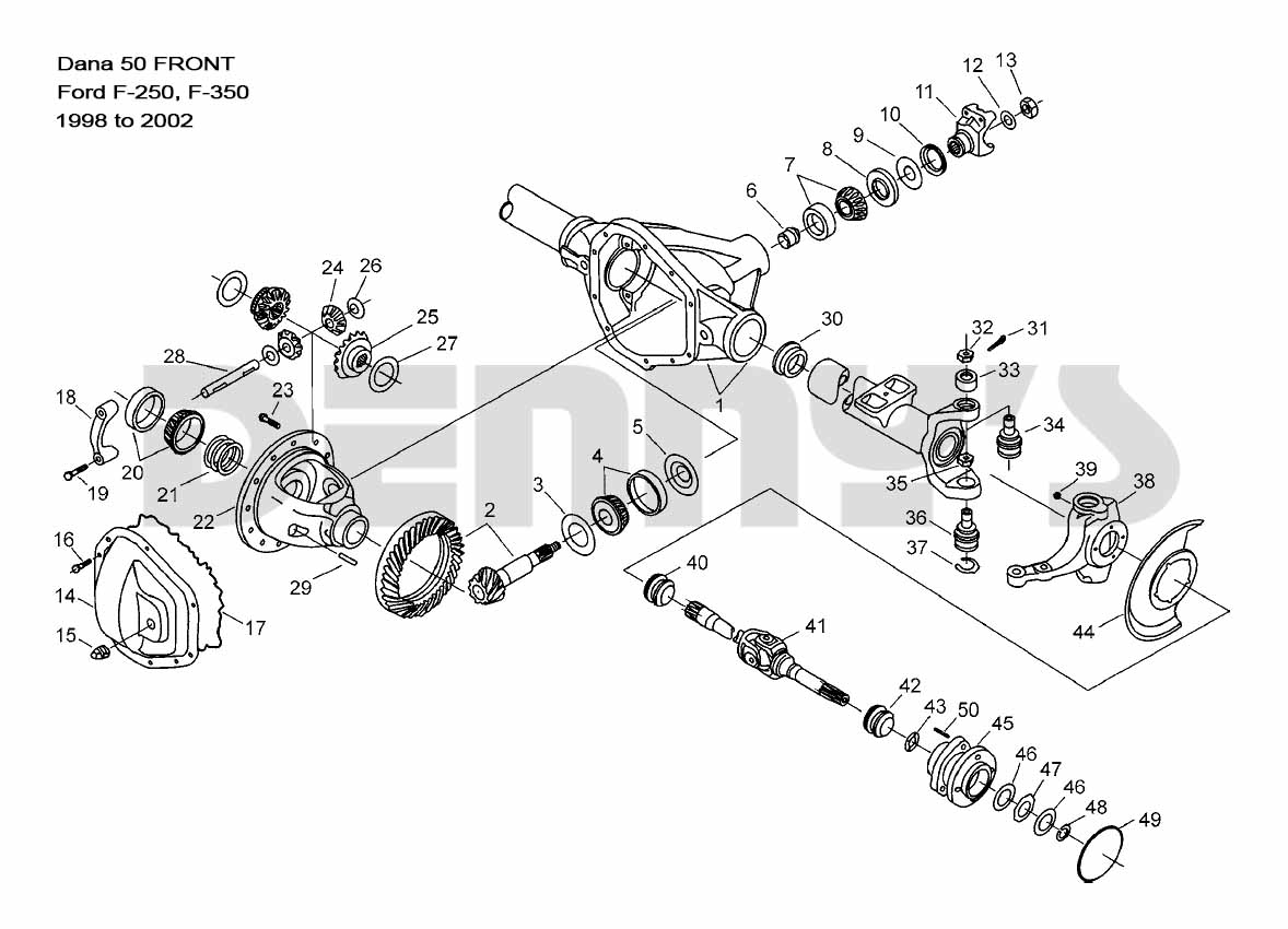

Thats not a piece of the roll pin from the carrier is it? That got whacked and bent a little.
Is this a dana 50 by chance?

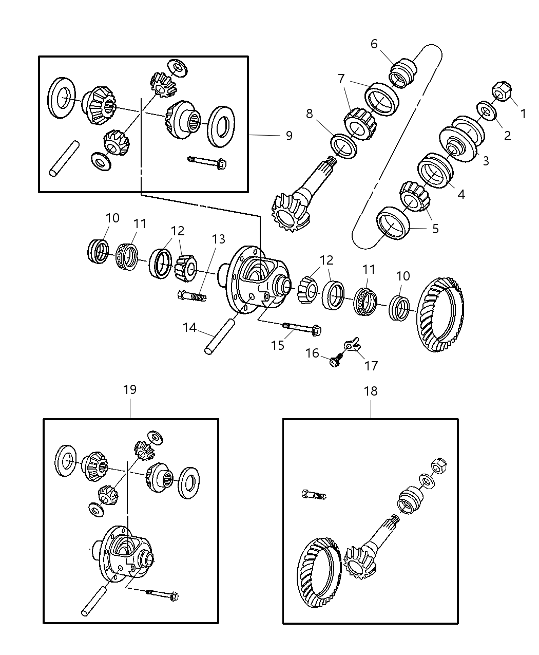

Only thing I can think of that it might be is the spider pin bolt. If the end that threads into the other side of the carrier had come out, you'd have bigger issues. Heck, getting the rest of the bolt out will be a fun time. A left handed drill bit will be your best bet.
Part 15. Called a differential screw. 5086694AA Part Discontinued.
