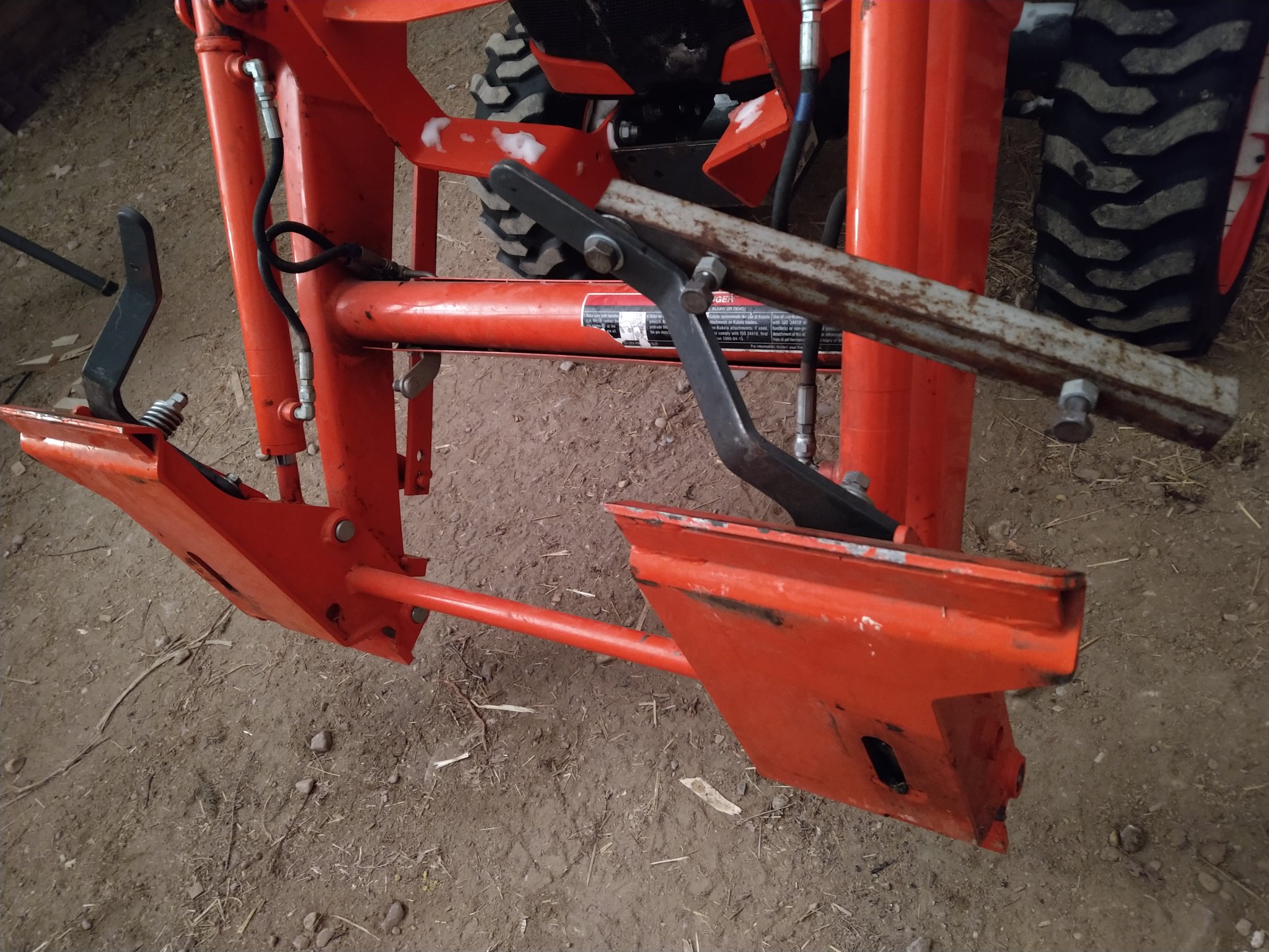

There's a few reasons the locking mechanism can fail to engage, or become loose after proper engagement, as I've experienced. A lock lever got pushed up by a branch sticking up from the ground as I reversed, unaware the right lock was now open. Then the forks bottom corner caught a stump resulting in bending the left side ssqa out of alignment with the right.
Got it all home and found a small piece of oak log to fit in the ssqa frame so curling the loader control pinched it, and allowed the opposite bent frame to get pushed back into alignment.
Solved future bush ssqa lever bush un-pinning possibilities by fabbing a lock bar to keep them firmly in place.

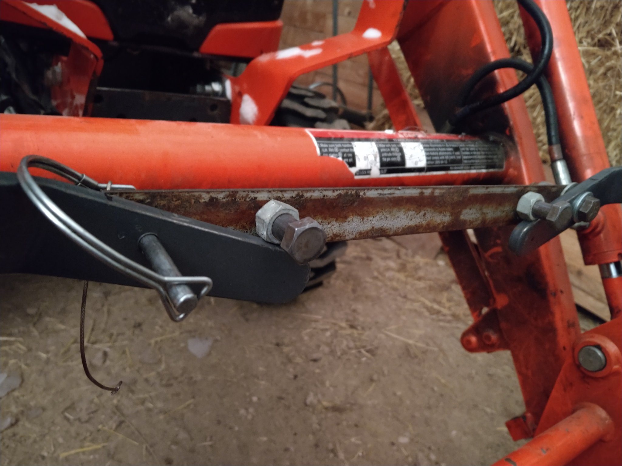

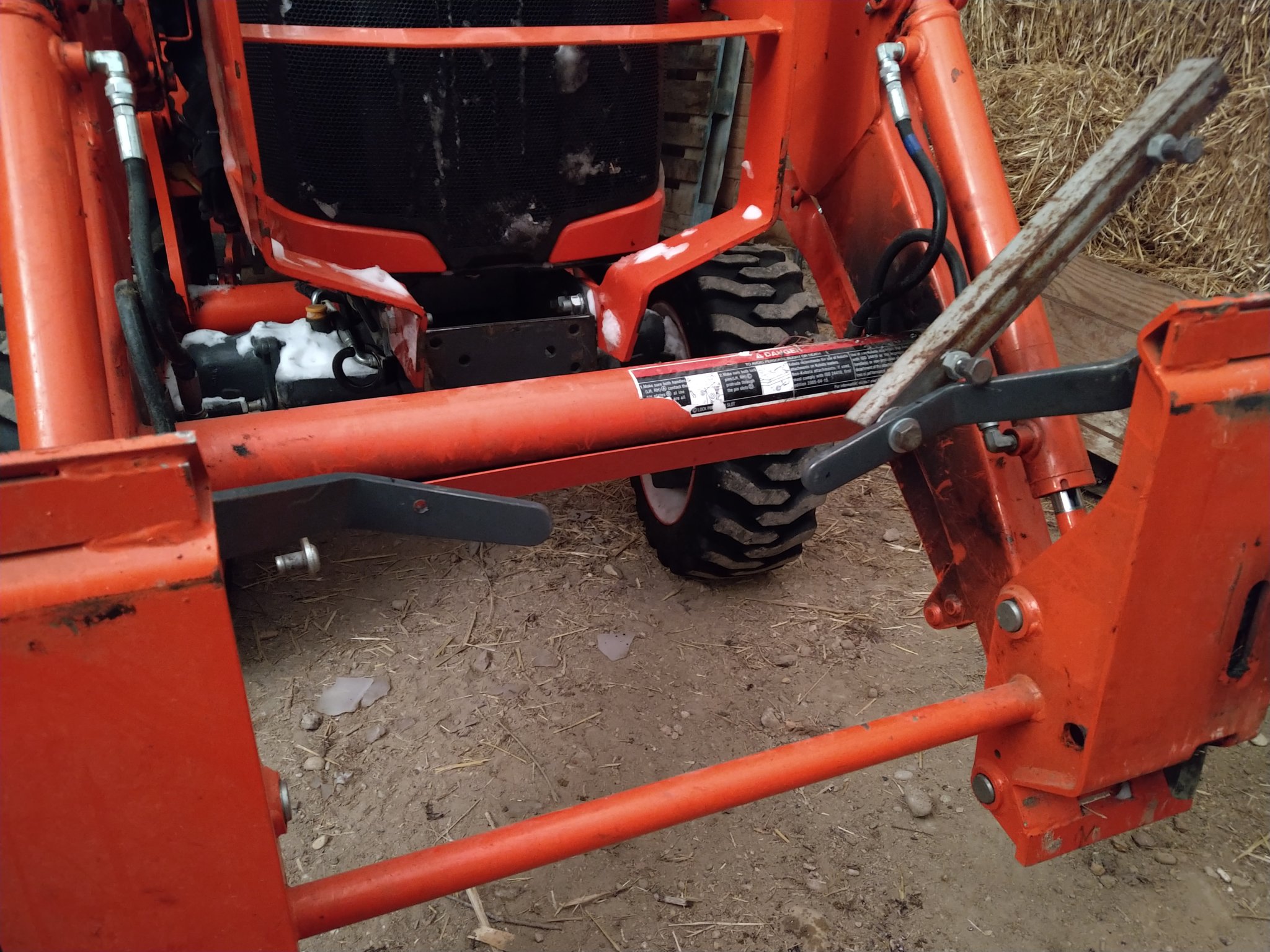

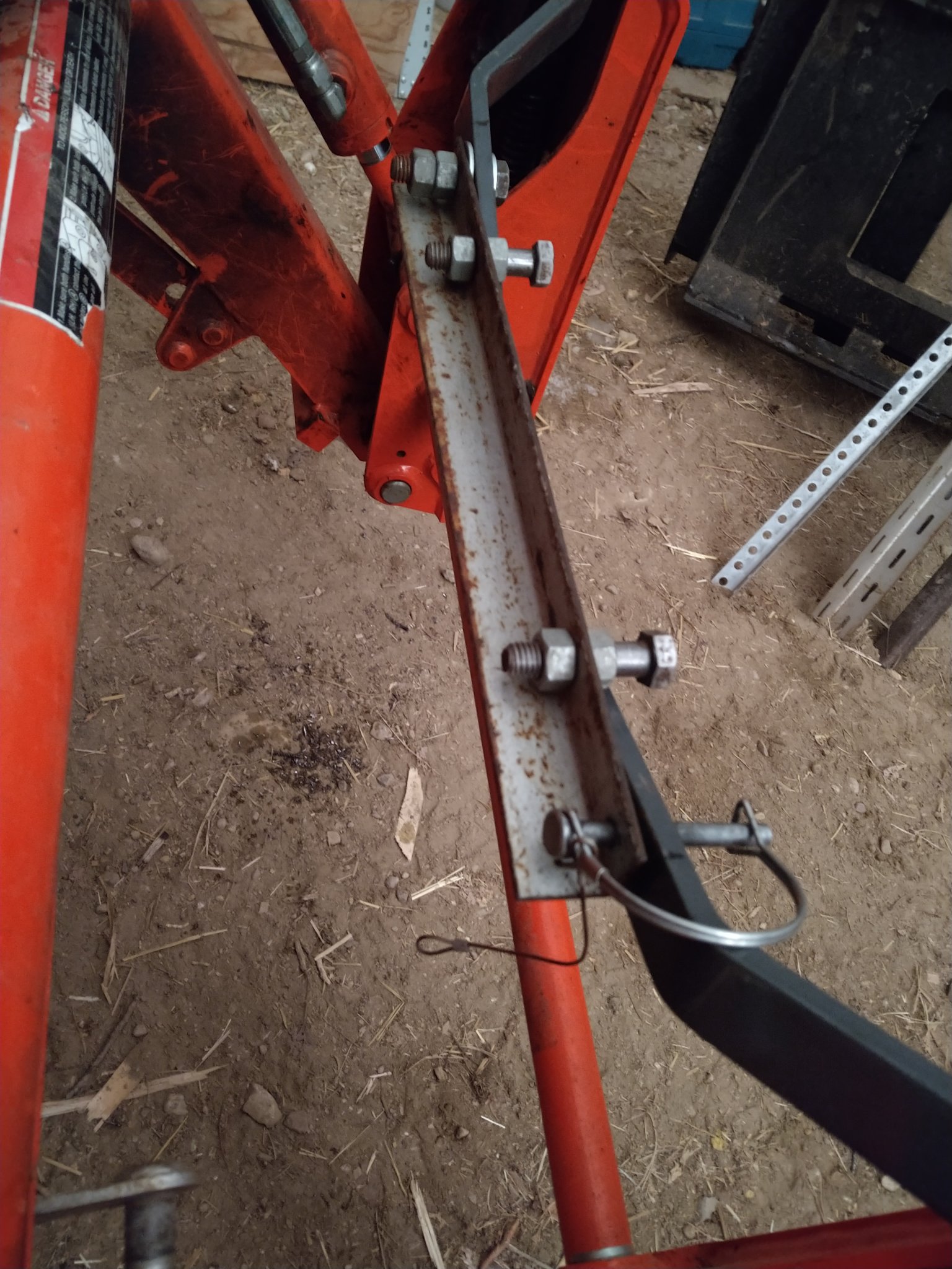

The very first time I used my grapple to move a brush pile, a stick unlocked my SSQA lever.
Luckily I noticed it before anything bad happened.
I am going to make something similar to this I think, or possibly an electric actuator to lock and unlock them from the seat.

I made an 'electric' version. Slower than molasses in January...... Used a 4" actuator from Hydro works ( S Korean ),some steel and pins to connect. Did it work.... yes, just so slow, I could get off the tractor and manually move the levers faster. One of those 'proof of concept' projects...now collecting dust in garage.
I am considering using 2 smaller actuators (one on each end) to increase speed.
However my mind makes projects faster than my check book can keep up with. LOL
