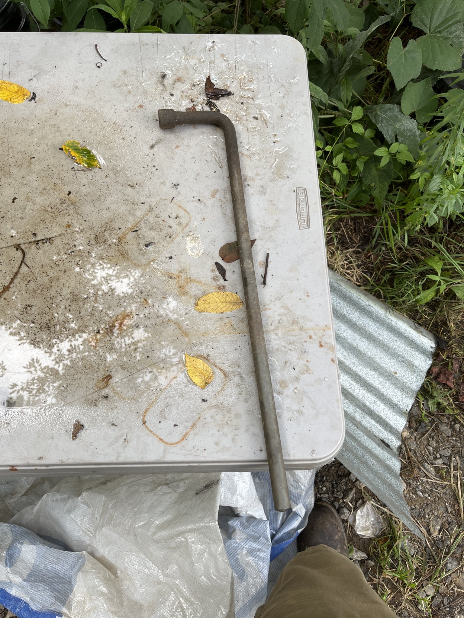

Random question: any idea why my excavator has a tire iron in the engine compartment? Has a special place and all.

May be a tool to rotate something in the engine compartment manually?
See if you can see any sticker remnants near the storage position or look at illustrated parts list to see what that part is called.
