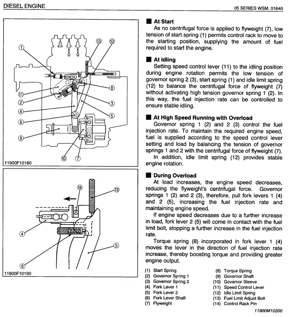

So to test it I have removed the throttle plate and set the throttle to 2000RPM. Then added the load on and off. The revs dropped to 1700RPM under load and I can't see any discernible movement of the governor lever (the upright lever in the middle) which should move the fuel slider on the injector pump to keep revs at 2000rpm. The lever does move on start up but not under load.
A slightly better video and angle of the governor not moving
QUESTIONS:
1. is there a recommended procedure/test for setting the injector pump barrel's twist adjustment or is it just trial and error?
2. Is my theory correct on how the governor lever in the video should work?
3. What are the possible causes? Sticky flyweight?
