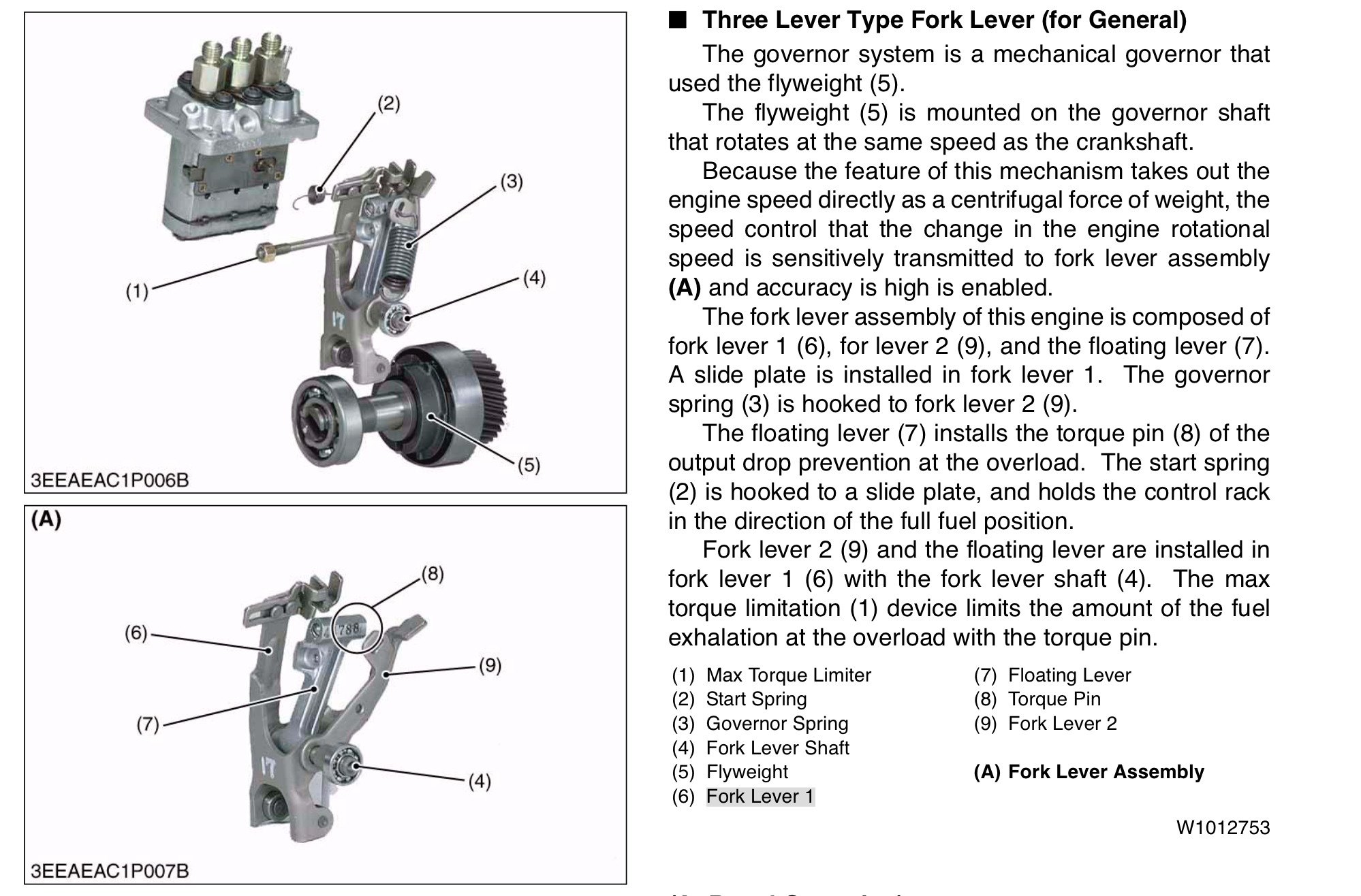

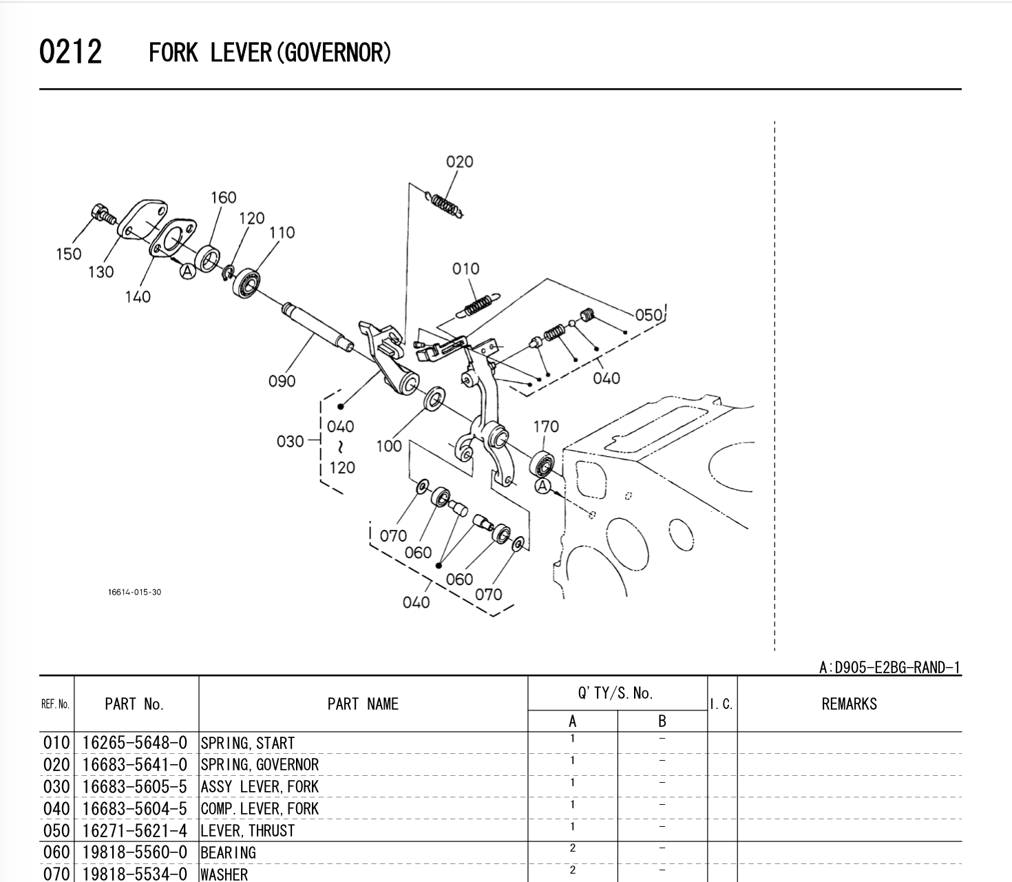

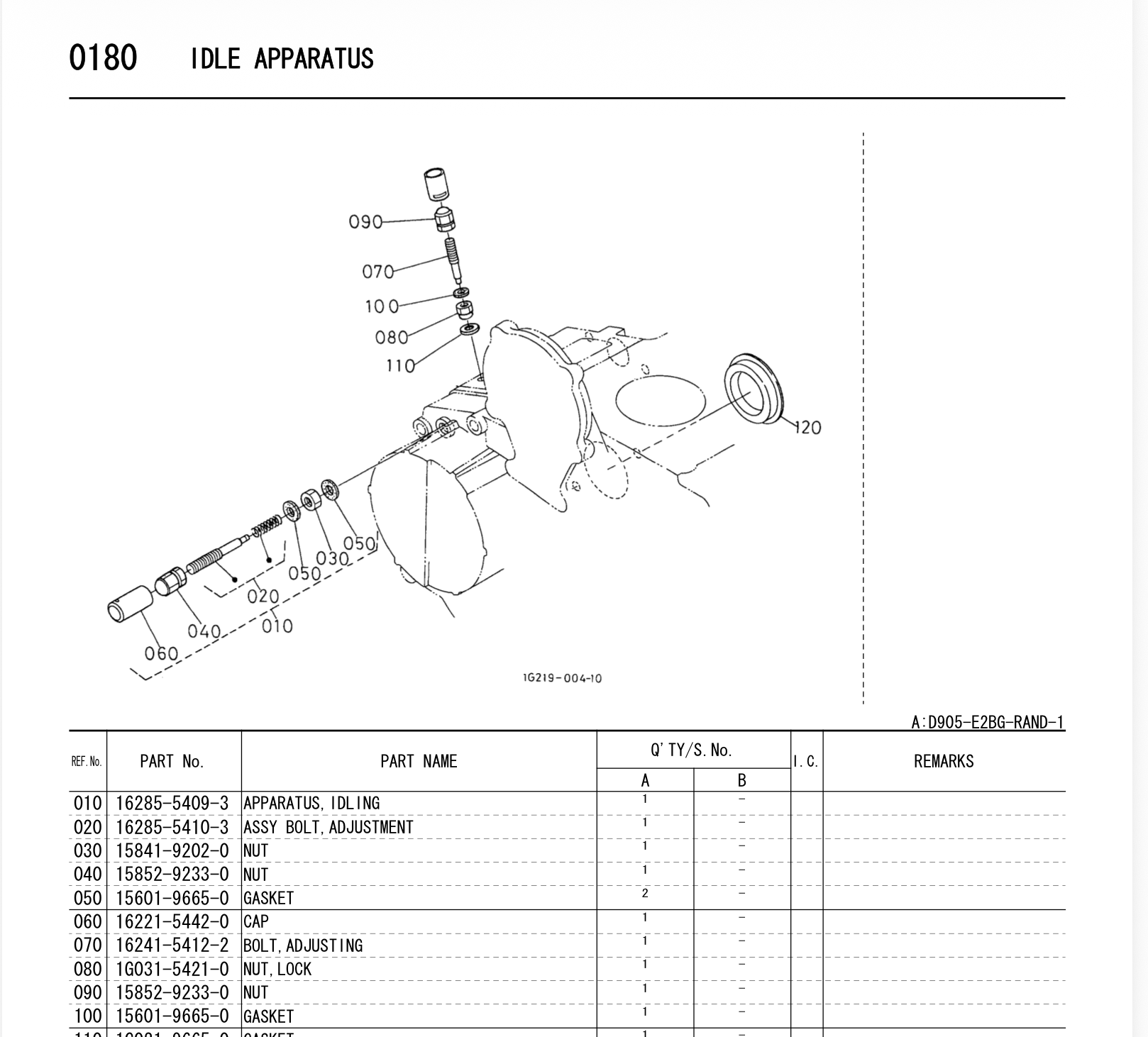

While looking through the parts list, I noticed this “idle apparatus.” (See Appendix ) It's somehow connected to the engine speed regulator, but unfortunately I can't find an exact drawing for it. Maybe there's something wrong there?
