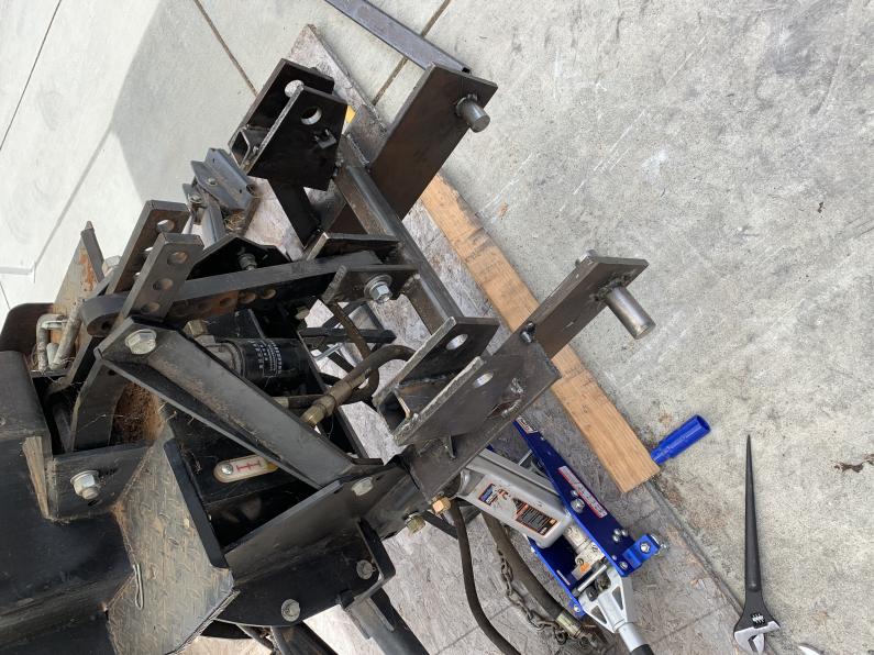

Turns out I misjudged the depth of the PTO pump and had to cut out my cross member and move it back ~6 inches. All good now.
First little bit of digging and man, what a difference between this on my l2501 hard mounted and 3 point mounted on my 6200.
Getting the adapter on and off the BH is a total pain in the butt however it's a one more time thing after I take it off to sand and paint. Hook up to the subframe is pretty easy, just a slight bit more complicated because of the PTO pump.
We'll see how it performs long term and I'll update once it's painted also.
