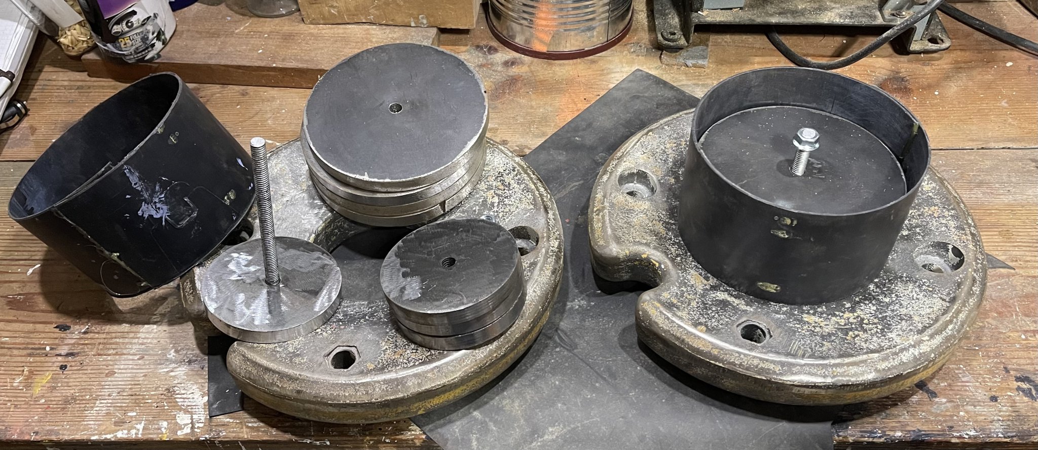

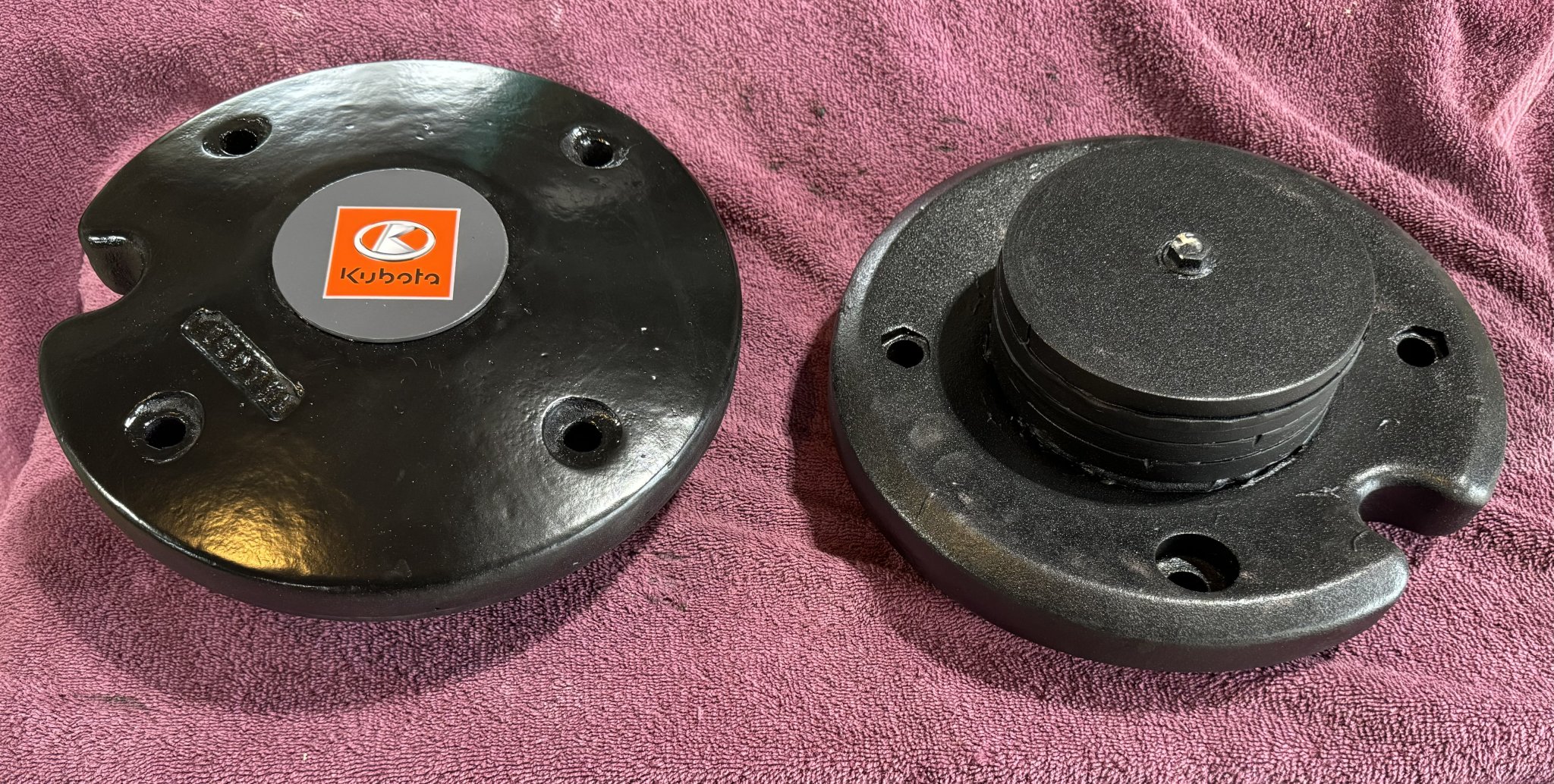

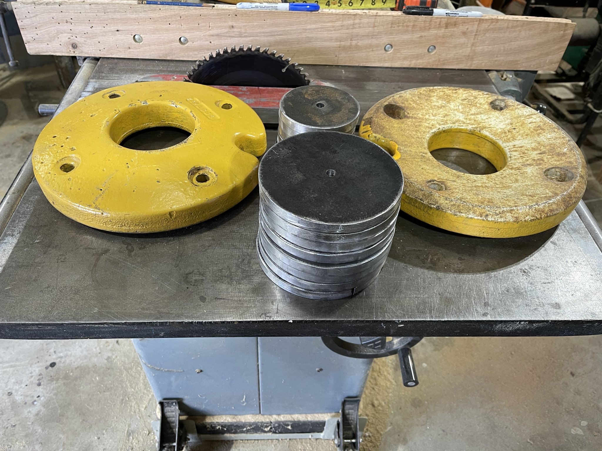

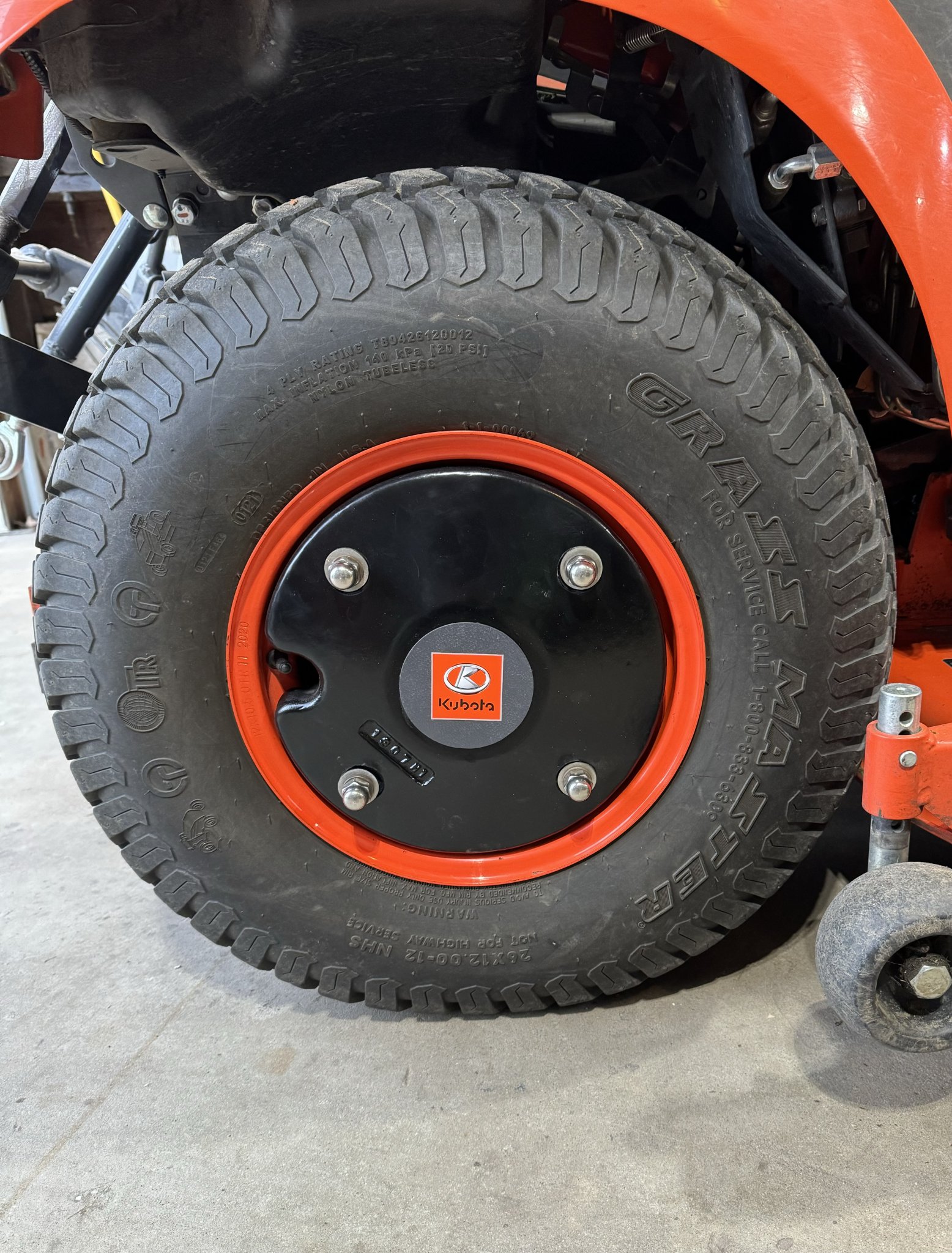

Got the weights for a steel but wanted a little more weight. JB weld and a threaded rod to bond the added weight, bedliner spray on the back and paint the front. Made SS heavy washers and used SS acorn nuts for added bling just because. Mounted on a BX 2680. Also have window antifreeze in all the tires and a removable 4x4x16” iron bar mounted in the hitch receiver when needed.
The angle of the photo make the valve stem look non centered in the weight.

Looks great…thanks for fixing the paint color😉. Jokes aside those look better than the set I bought new for my MX. nice job!👍

Got the weights for a steel but wanted a little more weight. JB weld and a threaded rod to bond the added weight, bedliner spray on the back and paint the front. Made SS heavy washers and used SS acorn nuts for added bling just because. Mounted on a BX 2680. Also have window antifreeze in all the tires and a removable 4x4x16” iron bar mounted in the hitch receiver when needed. View attachment 126665 View attachment 126666 View attachment 126667 View attachment 126668 .
Looks very nice!
