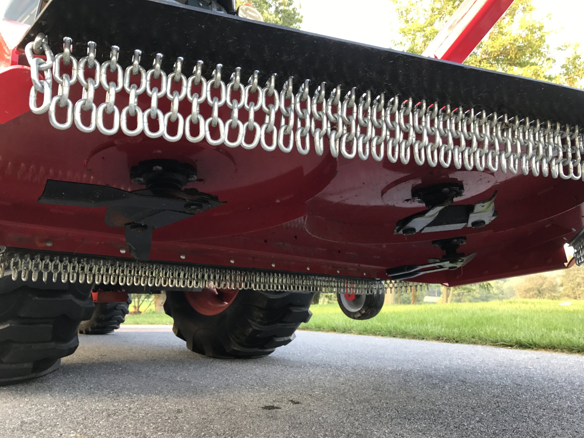

My BIL next door has a Woods RD990X on his L4740HSTC that's a real beast. He bought it almost 8 years ago and keeps it maintained and out of the weather. It will last a lifetime. It will cut up to 7" high. That kind of quality doesn't come cheap. They're close to $8K new.

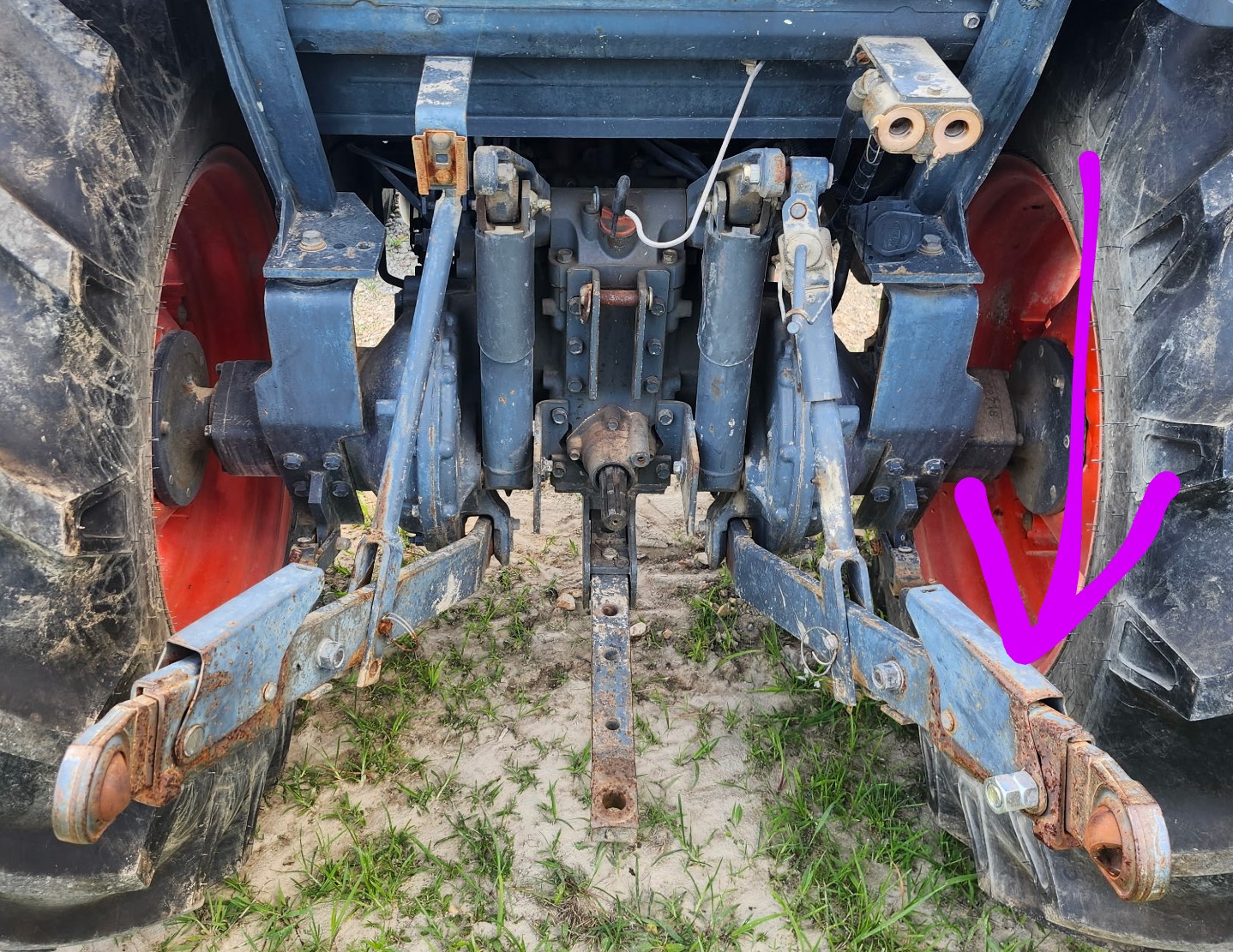

I sprayed the lower arms ends with PB Blaster last night, they are "stuck" or I don't know how to use them ...
The lower arm ends are released by pressing down the blue part that sticks up. It pivots and then released the part with the ball the pin goes into. When you get an implement connected just back up with the implement getting resistance from the ground and it all locks in place, then pull forward and go to work.

You mean these?
I tried to press them down, they wouldn't budge, so I doused them with PB Blaster, will try again when I'm home next ... But I plan on getting a quick hitch too next time home, so not critical that they work, but nice to have stuff work properly ...
Since it was missing the top link I assumed they used a pull type mower, but the salesman said they remove all top links, and store them up stairs, he looked and couldn't find the one for this one, but gave me one from a different one that they had sold, that apparently also had a hydraulic top link.

Those look like telescoping arms that will move in or out to connect to the implement (so you move the arms not the implement).
I think you might have to take the arms off the tractor and put them into a “tub” of PB Blaster. I have used PVC pipe with a capped end as the “tub” to reduce the volume of penetrating oil required. I have also used Evapo-Rust in a similar manner to get all the rust off so it stops rusting after it is painted.
Let them sit a few days in either solution just because it is easy!
Good luck with them!

My tractor has those telescoping arms and they're handy. It looks like someone fiddled with the right one (double-nutted bolt). They may not want to slide in and out easily with that rust. It's worth the effort to free them up.

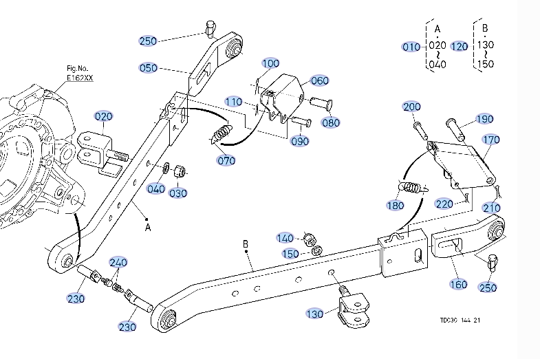

Here's a screenshot that shows the parts. Some parts are side-specific. Others, like pins that will obviously work on either side have separate reference numbers for left and right sides, but the same Kubota part numbers.

Bathing all the rusted parts in the PB Blaster should free up enough to get moving then keep working the moving part.

I figured between the PB Blaster, "maybe" a hammer to wake it up, C-clamp to put pressure on it, then hook a rear blade and help it get loose ... Once loose maybe grease?
Like I said, I'll probably just use a quick hitch, but if it's there, it should work

Attaching a rear blade (or any other implement) will not help that lever move. You push the lever down and the arm with the eye will be able to move a few inches out. You must pull that piece to get it to move. When it's pulled out enough to reach the desired implement you out the pin in. Do the same on the other side. Connect the top link. Now, when the weight of the implement in on the ground you back up a few inches and the part you pulled backwards will mover forwards and lock into place.

I figured that's how it worked, but figured if I couldn't squeeze it down that if I put pressure on it with the C-clamp, and then rattle it with dragging the blade, it might loosen it up?

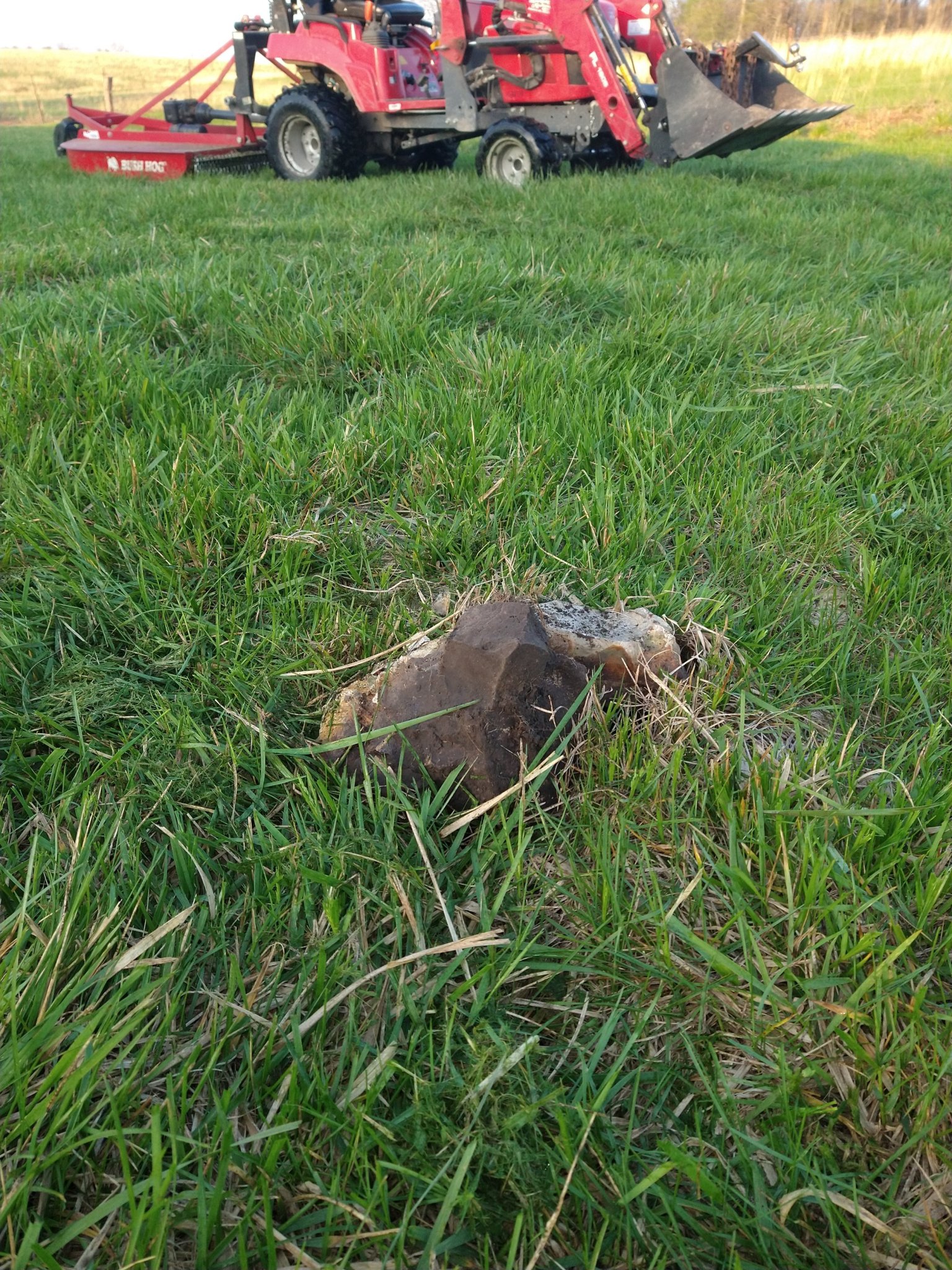

This probably the worst of the "Rocky pasture" ...
Occasional I'll hit one just right to drag it up out of the ground, I then stop and pick it up and toss it in my bucket, if it leaves too big of a hole, I'll grab a few smaller rocks from the bucket to fill in the hole ... I try to always mow with rocks in the bucket for front ballast, as the 5' brush hog is a tad heavy for my little SCUT!

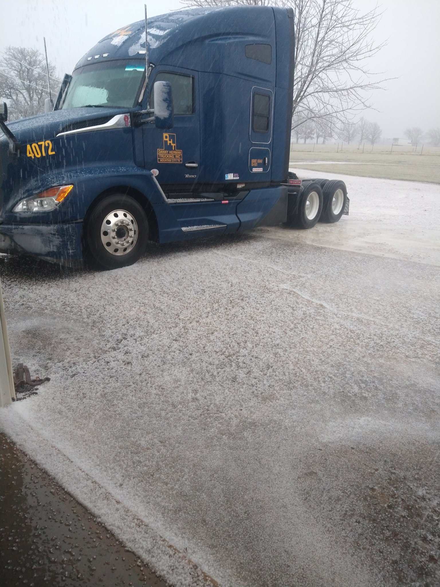

Yup, gone for a few weeks at time, unless I get a load which happens to go by home ... This is my "little blue house!" 😂
Parked at my legal residence!
