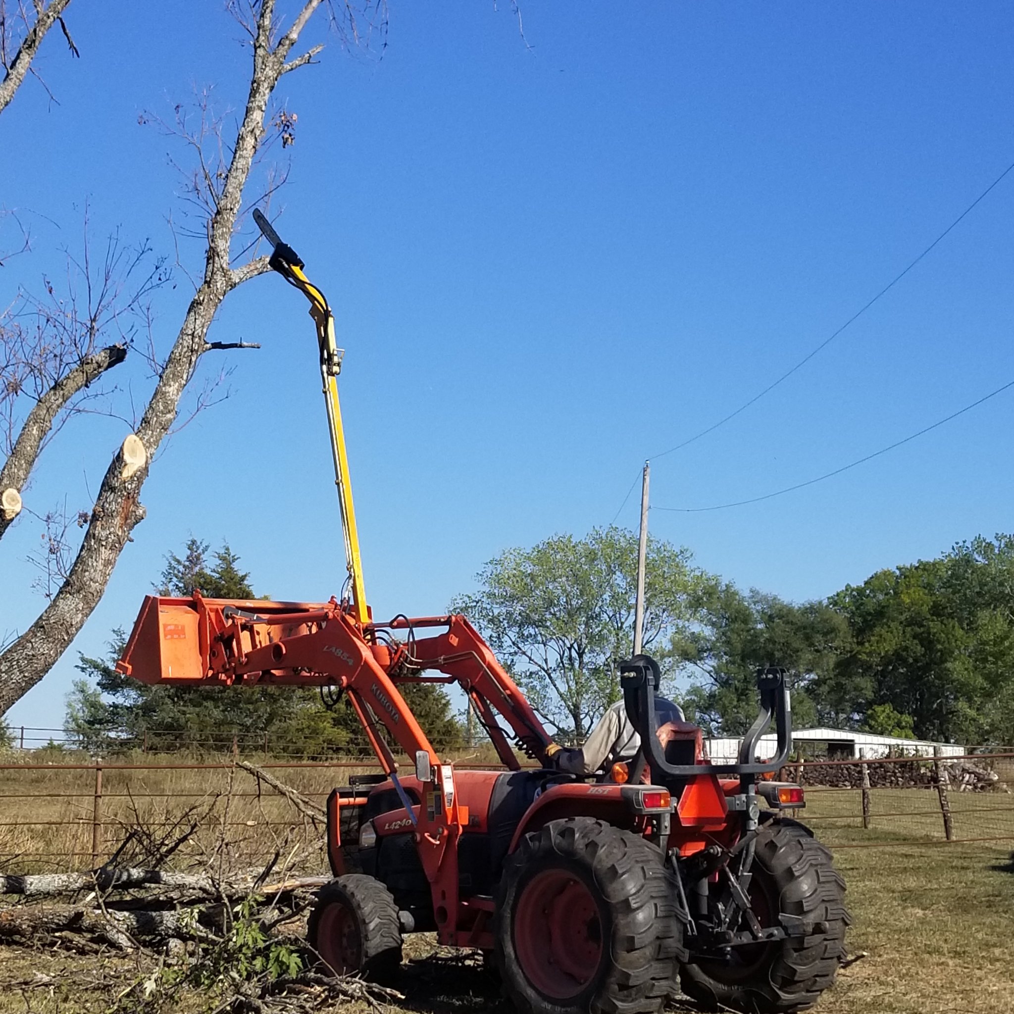

The saw is connected to the remotes on the front, same as used for the grapple. My comment about HST is in relation to the ability to move the tractor in slow, incremental movements to get the saw placed properly.
Clutching, shifting gears to get back and forth in alignment is not something I would mess with.

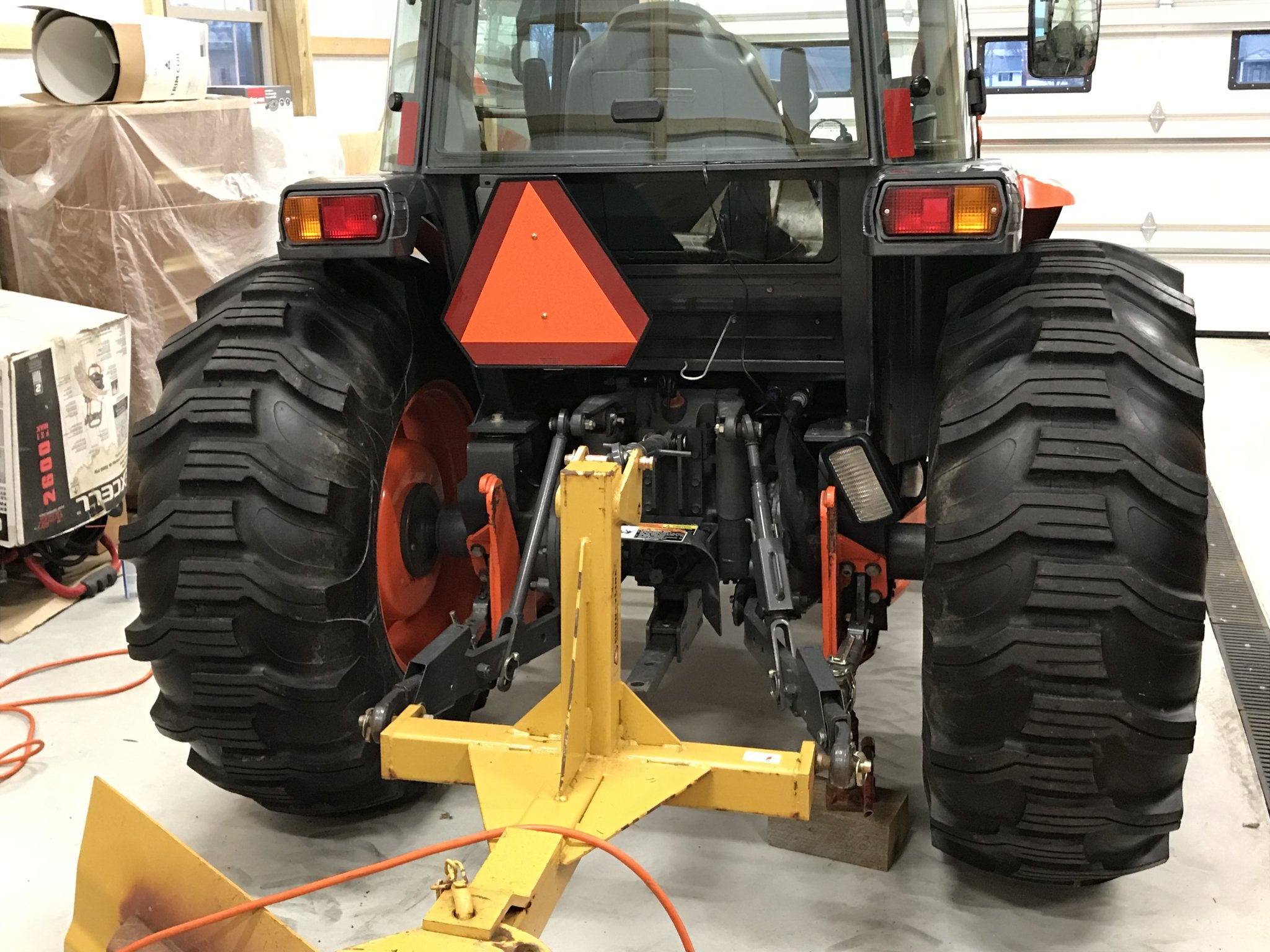

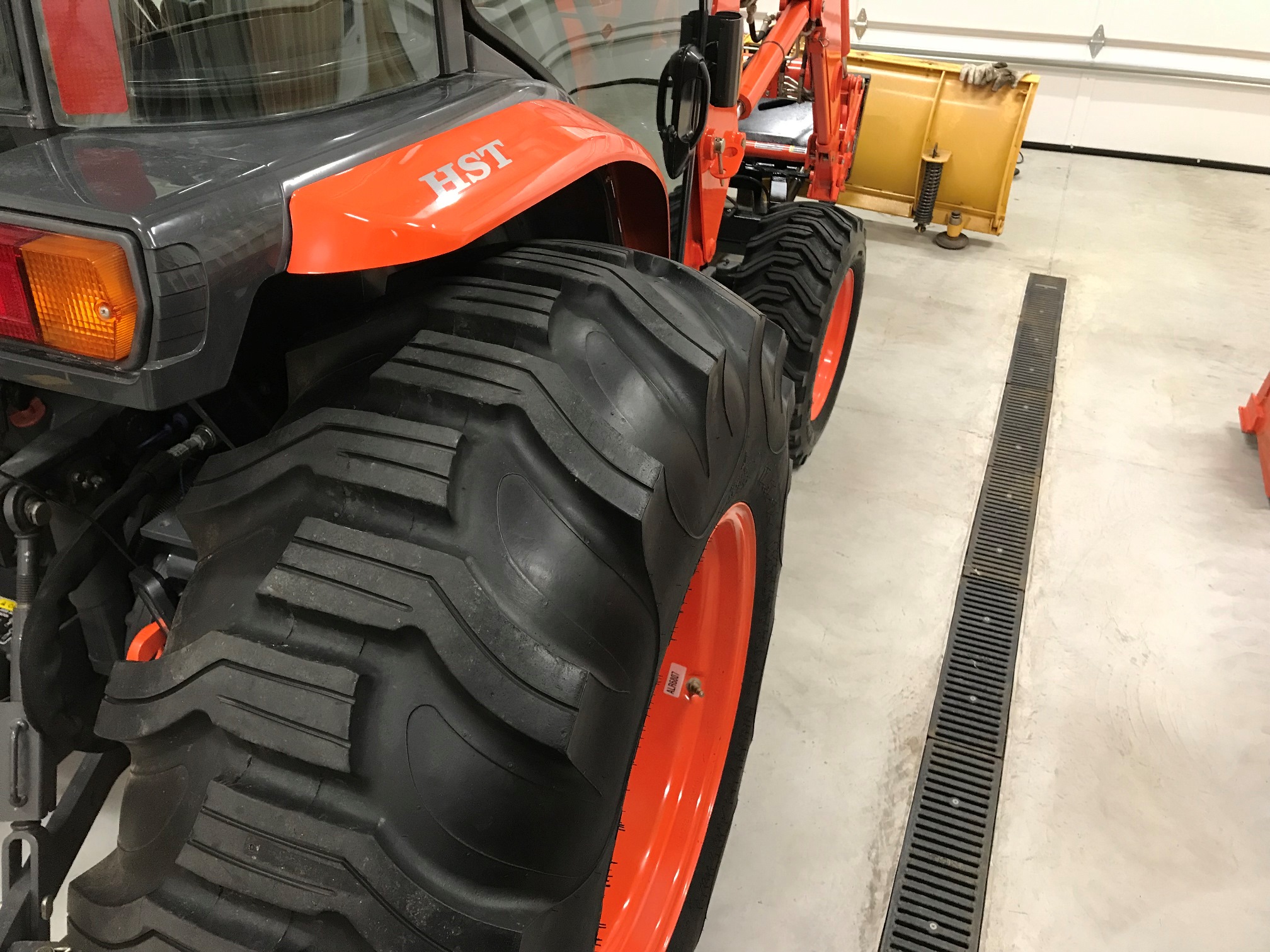

I made a bunch of black worms back in January 2019 when the L4240 came home. It really came "home" next door to my BIL's nice barn and he let me park it next to his L4740HSTC till I finished my shed. While it was in there I brought the plow home from the fab shop at work and mounted / plumbed it. Recut the grooves a year or so ago. The outside edges of the fronts were worn down quite a bit. It mostly runs on my yard, but travels paved roads to our church anywhere between 3 and a dozen times per year. I think it's about 3 miles round trip.
Maybe 5 or 6 years before getting the L4240 I did the R4's on the L3200 in my driveway. I've posted about the success of the grooving - ice hill, etc. It really does work! I've done a couple Winters with just the filled rear tires and no counterweight.
I run a limb / brush cutter, drill, grapple, digger with claw, tree puller and others from my front remotes with my gear shuttle shift trans and it is a non event for slow front and back stuff.
The HST is prob better for that situation, but certainly not required. Gear with no shuttle shift is not good obviously for front and back stuff but shuttle shift is awesome.

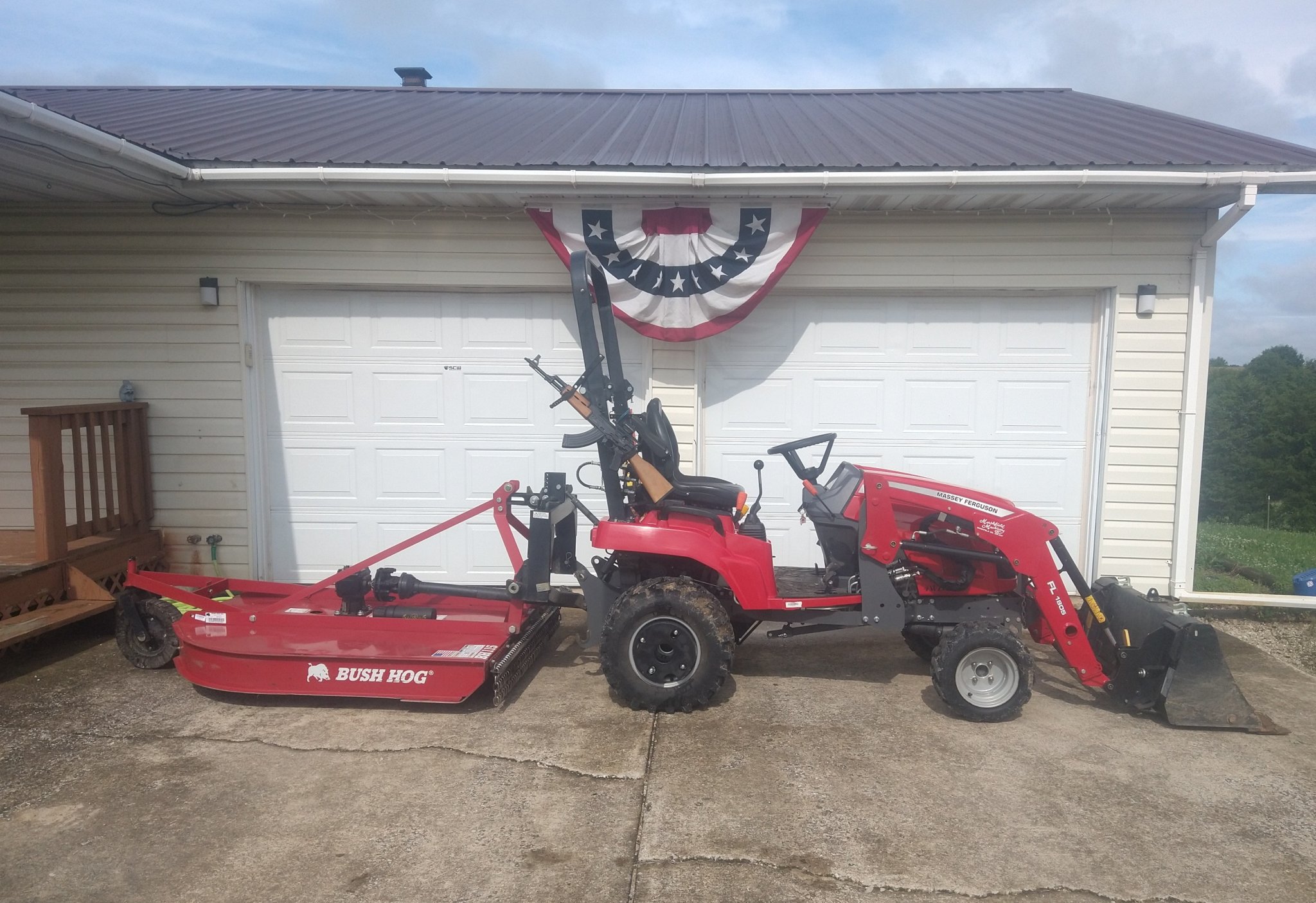

Not my first tractor, would be my 2nd ... mines the red one. 😁
I'm not opposed to a gear transmission at all, as a truck driver I'm kinda use to it, but got this new 2026 Kenworth a couple of months ago with a rotten automatic in it!
For my intended use for this tractor, I see no disadvantages of a HST, as long as it has cruise control ... I currently mow with my HST SCUT 90%+ with the cruise control ... Just set the engine RPM to keep the PTO happy, and adjust ground speed with the pedal, then set cruise, sit back and steer! 😁

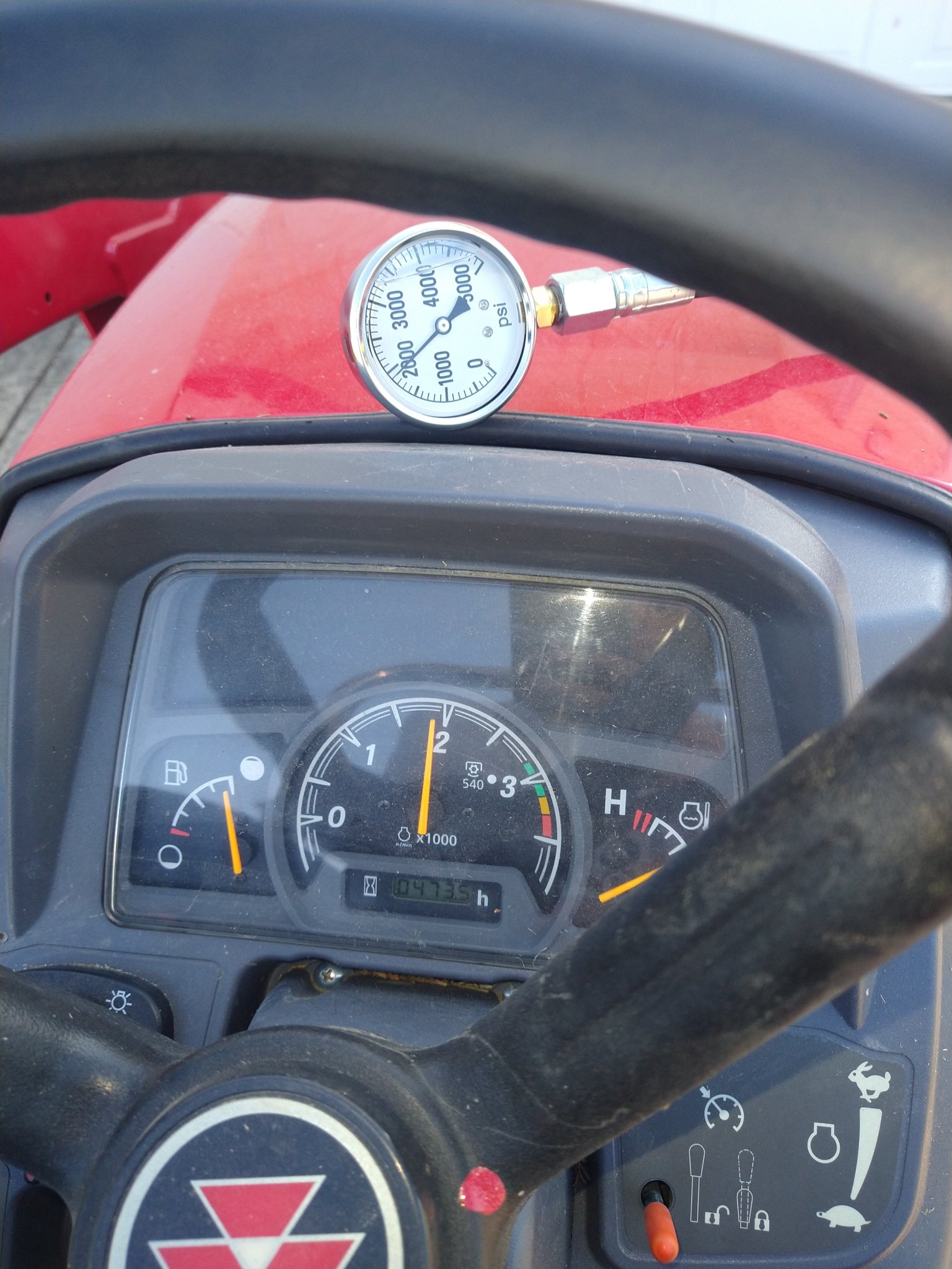

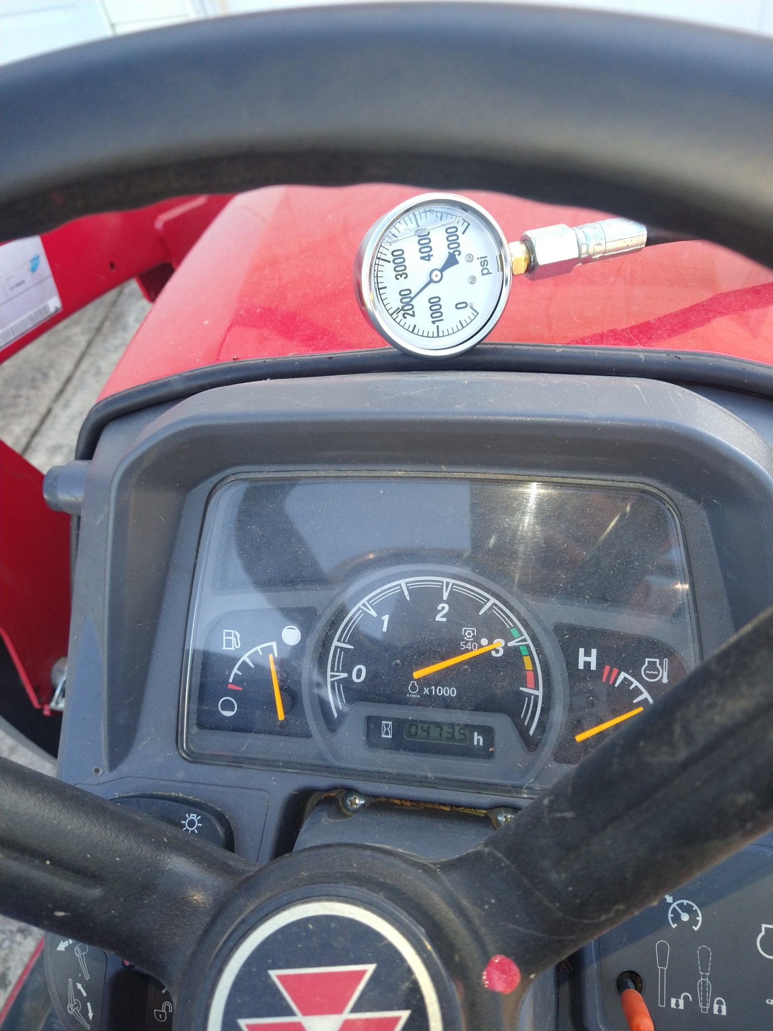

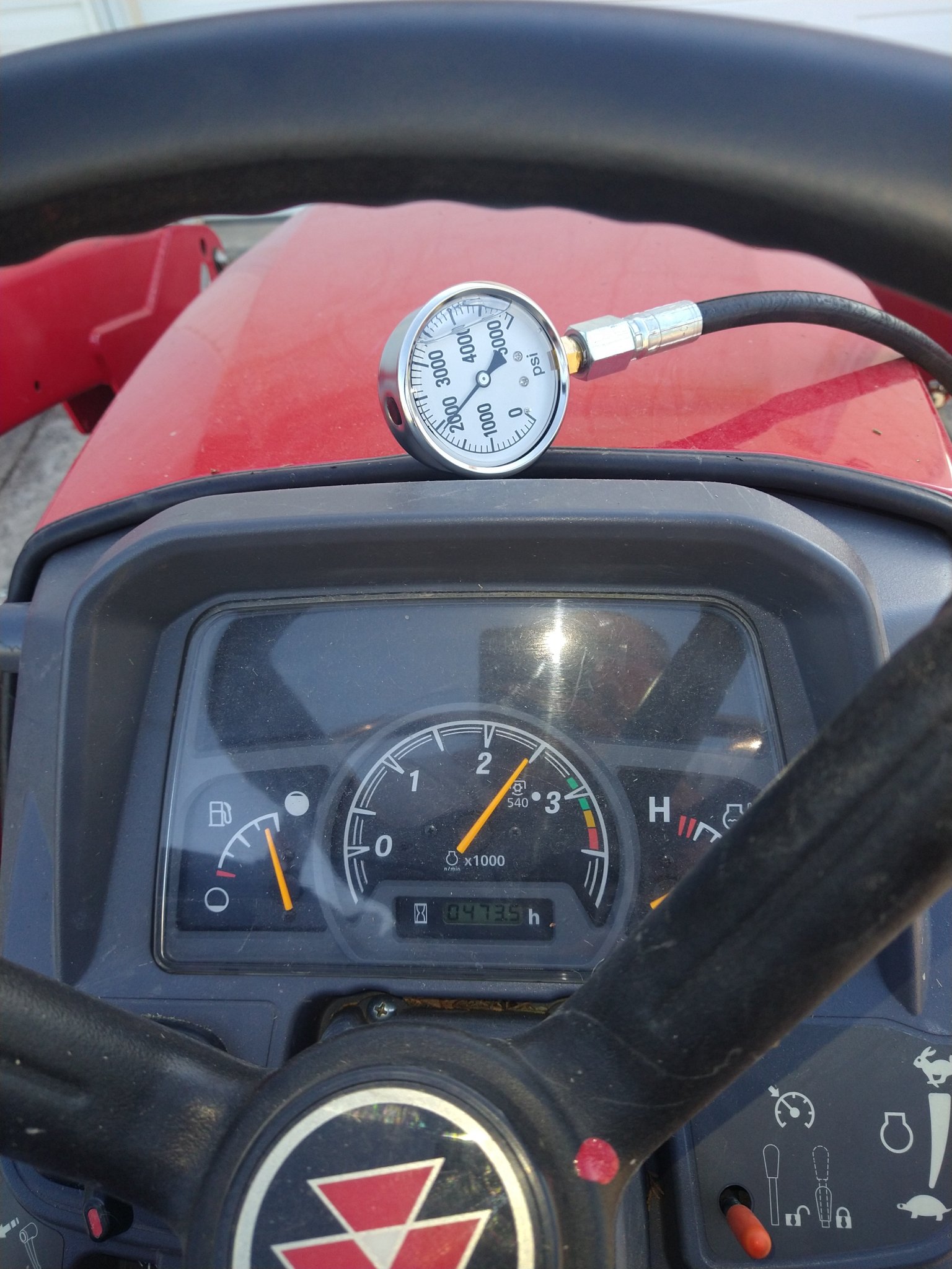

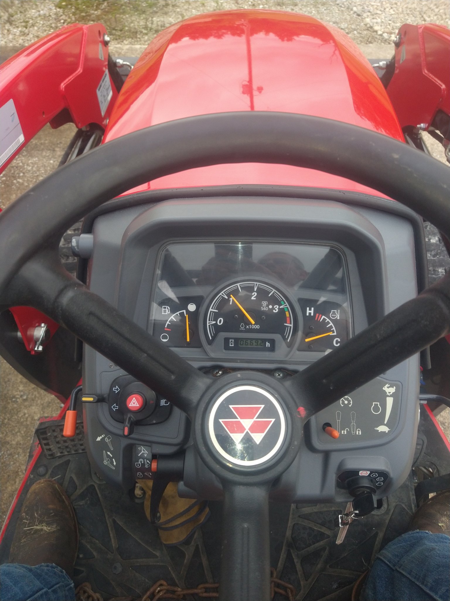

I don't understand this ... For PTO work, (which the Kubota will be doing) at least on my little tractor I gotta have the RPM up almost to 2900 RPM to spin the 540 PTO for the brush hog and rototiller I use ... Now when I use my sprayer, it generates too much pressure for my use, so I idle it down to 2100 RPM and the pressure control knob out all the way to get it down to about 40 psi on my nozzles ... I get 7-8 hours on my 6 gallons of diesel ... Tank holds 6.5 gallons or so ...
I usually run it about 2400 - 2500 RPM for loader work, and 3000 for backhoe work ...

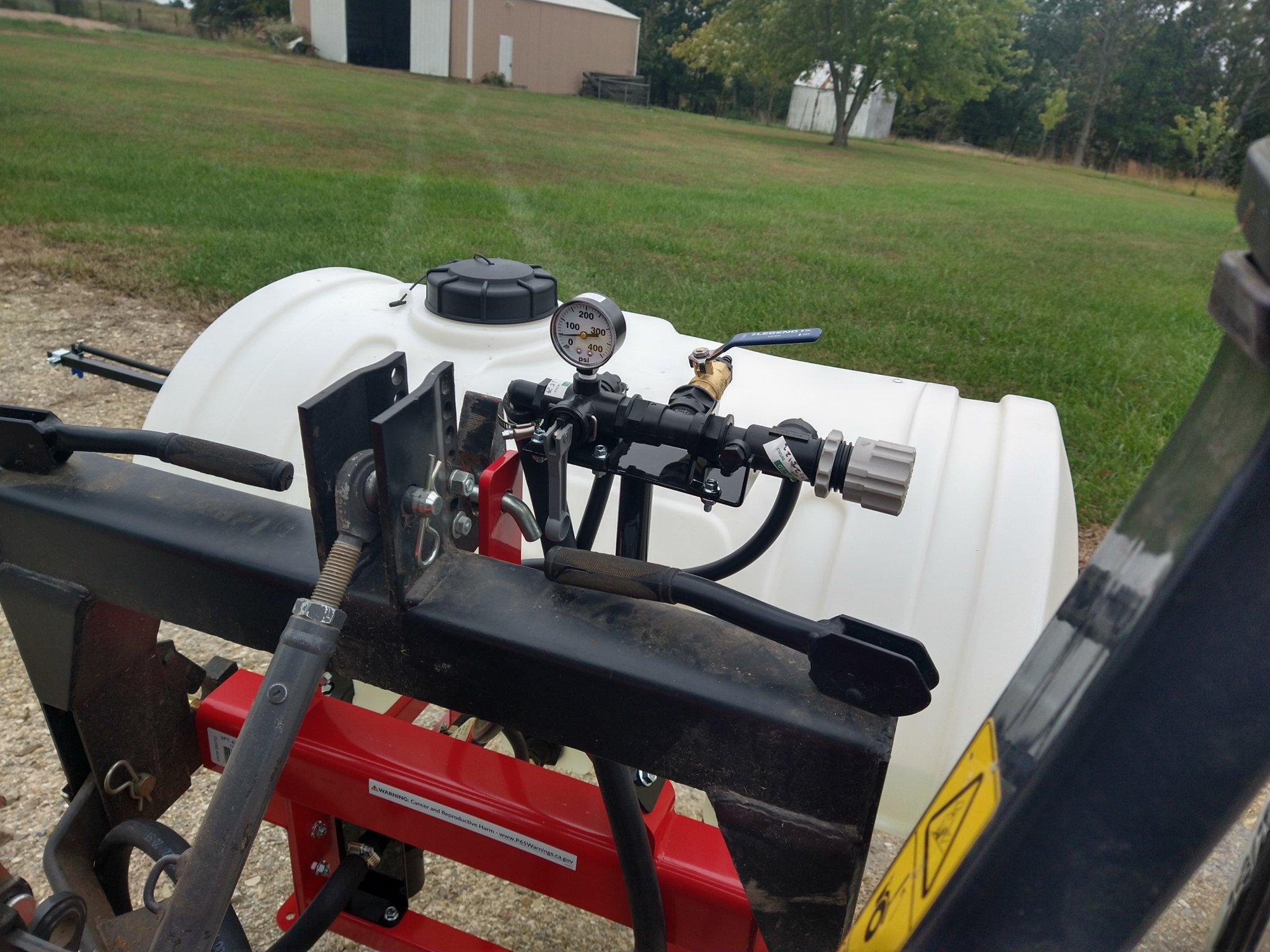

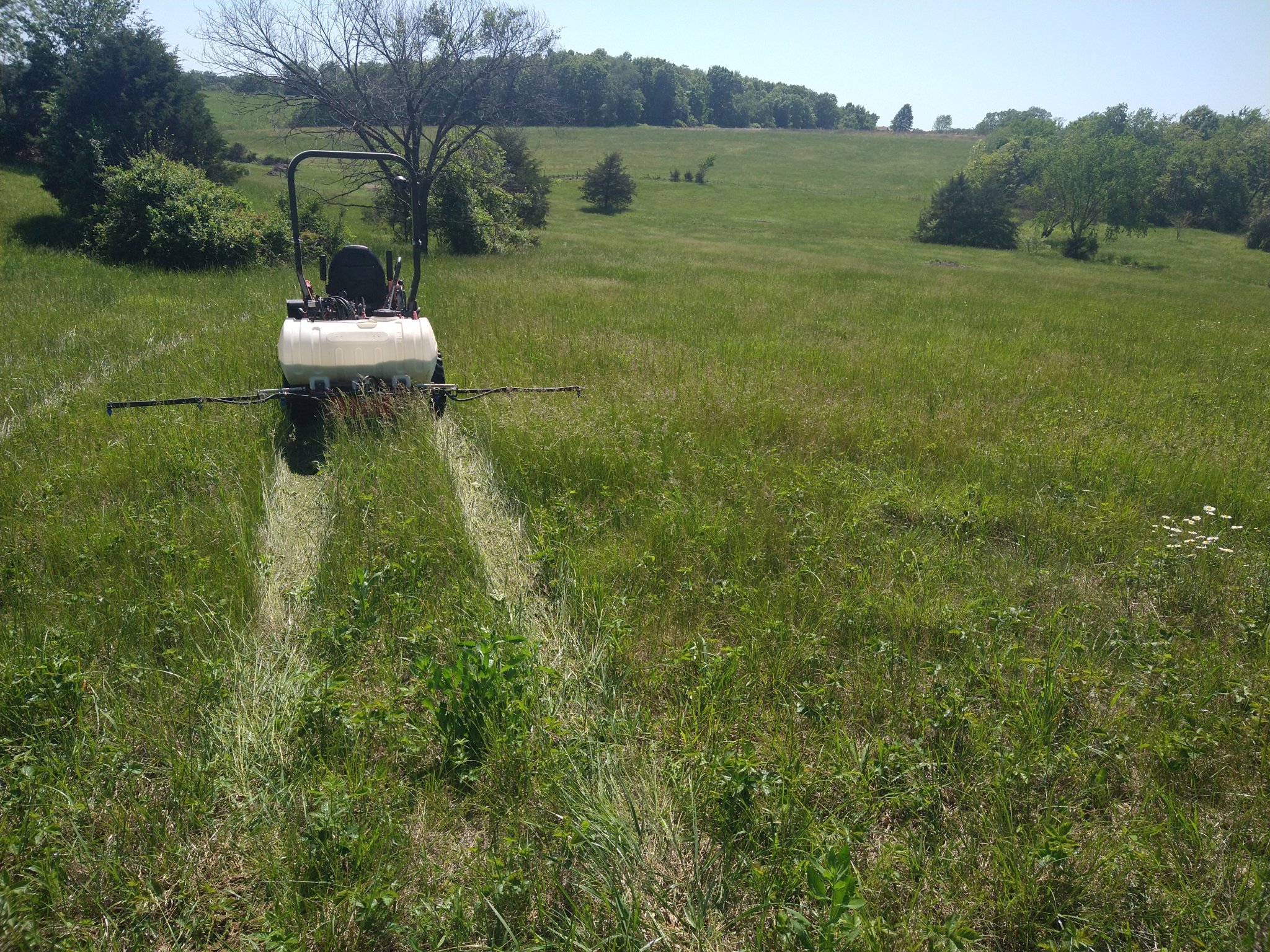

The sprayer only needs a little over 1 HP to turn it, so it will pump at an idle, but then I loose ground speed, but my brush hog won't cut at an idle ...
For maximum hydraulic power I gotta crank up the RPM's to 3100, while it's not a lot of gain, on a little ity bitty tractor, I need all it's got at times!
Deadheaded it at 2000 RPM, it dropped to this:
Deadheaded it at 2500 RPM, dropped to this:
Deadheaded it at 3000 RPM, dropped a tiny bit:
So I only gain about 50 psi, but it does make a difference.
