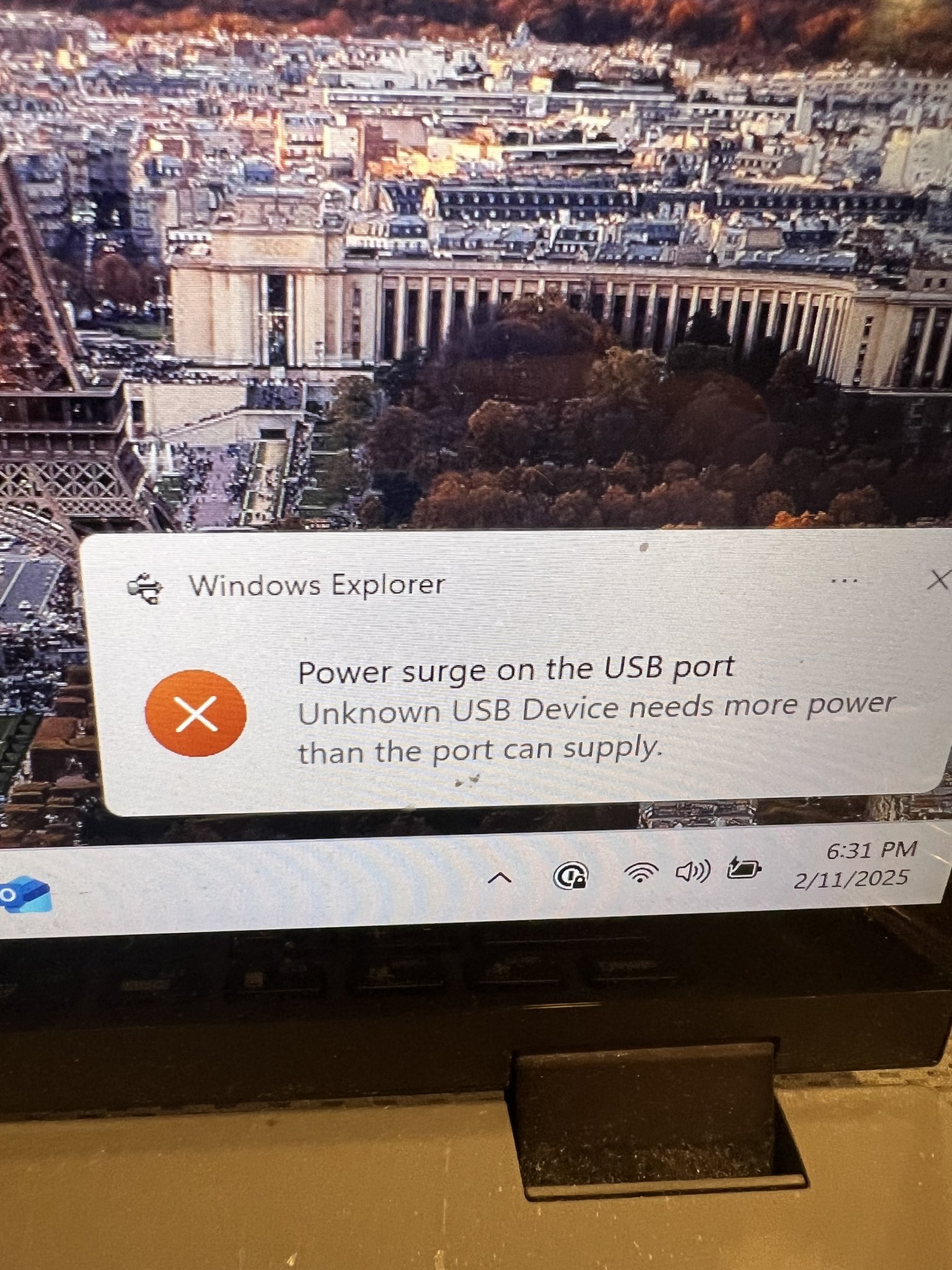

Second, and reason for quandary. I use a wireless mouse. Uses one of the two USB ports on the laptop. The other USB port is wonky. Whenever I plug something into it, I get an error message.
I took a picture of the error. Googled it a while back, and said something about uninstalling and reinstalling the port?

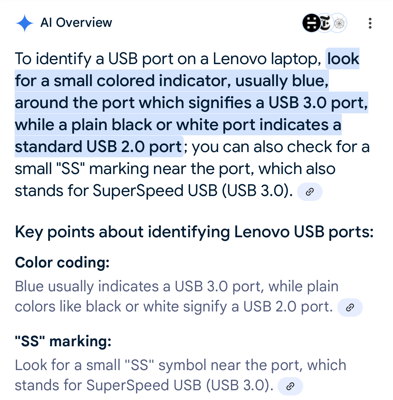

There are multiple flavors (and capabilities) of USB ports-and likely the one giving that message is the older version that can’t provide enough voltage to something new fangled wanting more. See if there is any difference in color, or any type of insignia showing on the other one. Seems like newer ones may show some blue in and around the ‘duck’s mouth’😉

It's not low voltage it's CURRENT that's wrong.
USB ports have a lot of 'flexibility' and one of them is limiting the amount of current that can be sent to the 'device'.
Odds are some 'app' or program has decided to change the 'power setting' for that USB port.it took me 3 days of digging to find what POS 'app' had changed a port on this PC, so I never allow 'updates' on ANYTHING except the virus database.
I find it hard to believe that laptop had a 'high' power and a 'low' power USB port. USB by 'standard' should allow 2 amps of current. That info 'should' be in the owner's manual of the laptop.yeah I know I'm dreaming....

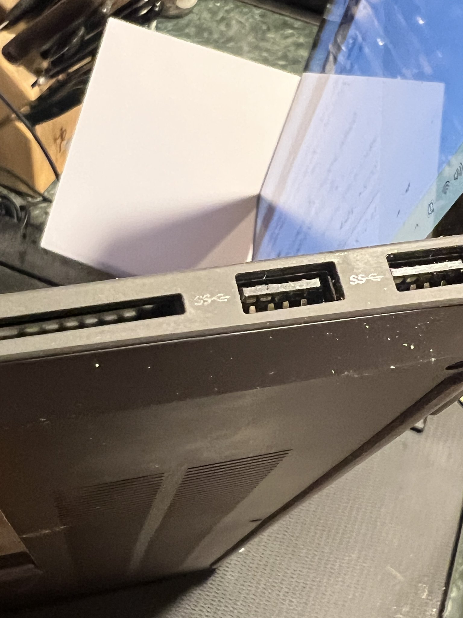

Don’t know if it will show but both look to be labeled SS….
Then there’s likely an issue with the port, I would speculate. With the laptop unplugged and the battery out, maybe see if a can of air duster (or some such dry keyboard cleaner) can dislodge a dust bunny back in there. I doubt I myself would put any thing else ($ or time) into it, given the laptop’s age.

Some easy things to try, non of them have catastrophic consequences: USB port not working
Thanks so much for your suggestion. Sounded like what I saw earlier when searching.
Unfortunately, none of them worked.
Good side, I was easily able to follow the steps!
I did blow out the port. Looks clean. Betting your estimation of a bad port is correct.

I can take the USB wireless mouse thing from one port where it works fine....put it in the other and I get that error..... :mad:
I did all the uninstall/reinstall stuff that @xrocketengineer suggested, and no success there either.....Those were the steps I recall when I looked at it before. Thought that was the ticket....
