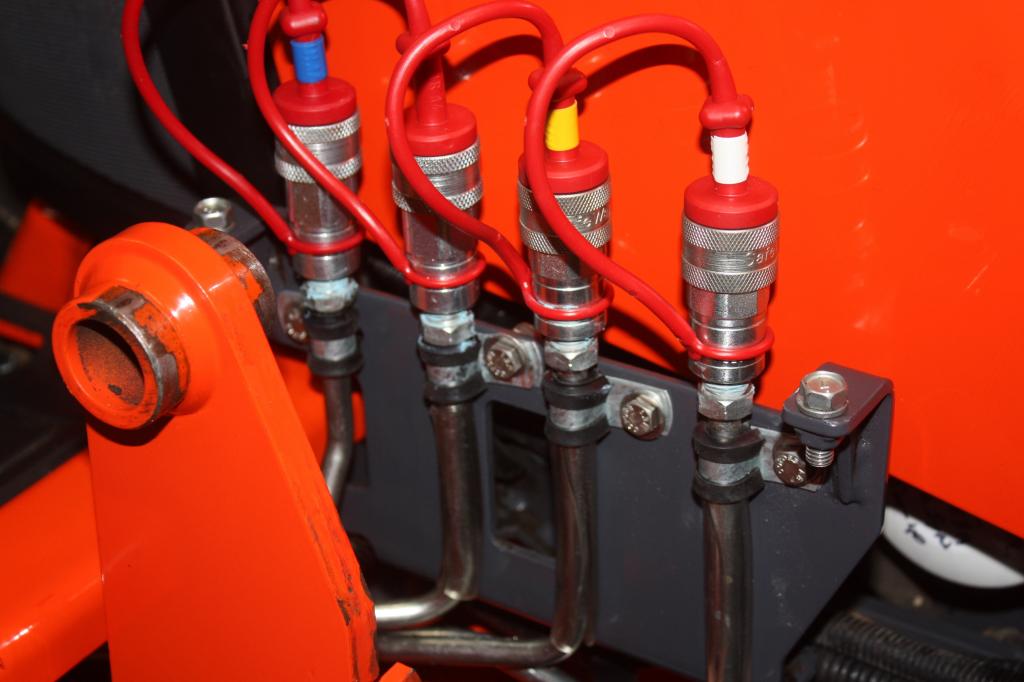

Alrighty then....
Looks like I’m done.
Everything lines up good everything works no leaks
Pretty simple to hook/unhook.
For anyone looking to do the same thing on a BX23S
The parts are:
4 sets of Pioneer couplers (1/4” NPT)
4 - 3/8”JIC to 1/4” NPT adapters.
4 - 3/8” tube clamps
The only thing I need to get yet is four of those plastic protectors for the male ends.... when the loader is unhooked.

Nice job, well done. I have everything together to do not only my FEL but also my K Drive, F/M snow blower and my power angle F/M broom. I'll keep the entire factory setup and put it back on when this tractor moves on.
I am still going to put the 4 females on the tractor. I have 4 really good quality snap-on covers to to protect them when not in use.

Awesome.
Make sure some wiseguy friend doesn’t swap those color coded caps on you ...
LoL!!

Great job! I like the way you clamped the tubing!
