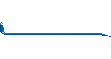

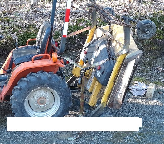

I do not clean it as often as I should but it still has been around for a long time. I remove the drive shaft and throw a small come-along over the ROPS and attach it to the top link under the seat. Tip it up and clean with a nail puller and hose. I clean until it is good enough.
CAMO strap is for safety. Visions of having the deck slip and take a kneecap off.

My come-along has two cogs on the winch gear. One is the stop/safety and the other is on the handle. To let down you pull the handle as in raising the deck . This releases the safety and you can hold it open. Let handle lower deck a few inches ( it will only go a couple of inches and it stops), let the safety cog snap back in place. The handle can then be moved again. It is a slow and tedious process but extremely safe.
It is almost impossible to by-pass the safety when there is tension on the cable but it is possible. Without being specific you can use the procedure that allows the cable to be let out quickly for set-up.
With a thousand pound mower, I'd say it is the suicide method.
I should add. The actual come-along is on the mower side of this rigging. That way there is no cable moving and digging into the PROPS. A large rag site between the PROPS and the steel cable
