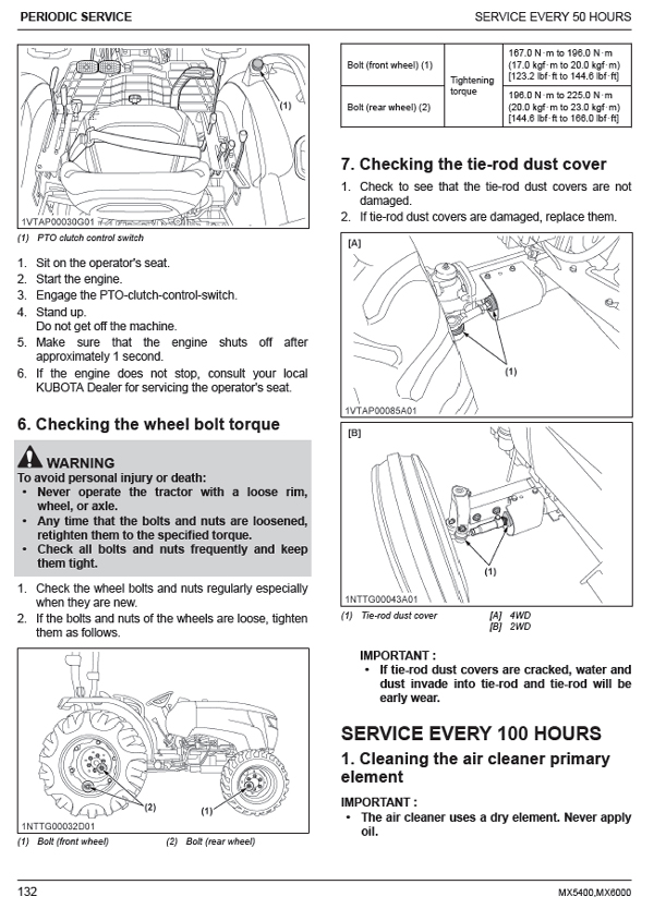

5,025
NW Montana
Old Ford Flathead v-8's used toilet paper roll filters and would last a long time. As you can imagine oil having to flow thru the fine medium of a roll of toilet had to be clean at the end of the trip. VW's had no filters early on and even with the high temps of air cooling lasted a long time also. Some Land Rovers never had trans fluid changed and still going after a million miles. Wonder what the "rev your engine" guy on UTUBE would say?
I have no idea what point you're trying to make. If you're against preventative maintenance then that's your prerogative. I'll continue to remove dust and debris from the outer air filter as described in the owner's manual. It's easy, it's fast, and it's effective.
