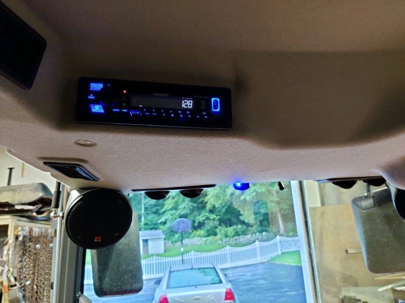

A lot of us can’t afford the $300 and something dollar factory radios that kubota supplies. Messicks has a kit for $90 plus shipping. But, shopping around on Amazon, I was able to get the radio for $36, the adapter wiring plug that goes into the stock harness for $23, a couple of crimp connectors and you are good to go. All the cab kubotas use the same 9 pin plug so you can put a radio into anyone of them and use the factory wiring. The factory speakers on my machine being a 10 yr old M6040 were dead, so I had to replace those. But, the whole system, including the antenna, is pre-installed on the cab tractors. So, a radio install is simple. Here is the link to my how-to video and the video description has the links for all the parts I used: radio and wiring harness install

Timely as I am looking to put in a radio in my M4D. Looks like I need the 9 pin adapter and that is about it. The manual states you need to have a support plate. Have not tried to remove the panel yet so not sure if it's already included or that is another item I need to pick up.
BTW - Yes bluetooth is for taking calls from your phone through the built in speakers and a built in mic on the radio. On non cab tractors will be a bit more involved but can be done.
depends on how big of a radio you put in, aka the additional supports are really only needed if it’s a cd player. Basic radio is so light there’s no worries on the m4 cab.
Yeah I used this one: https://www.amazon.com/gp/product/B08464VRML/ref=ppx_yo_dt_b_search_asin_title?ie=UTF8&th=1
It's only about 2" deep so no real issue with support.
I used the adapter from EBAY HERE: https://www.ebay.com/itm/203788614647
Took about 10 minutes with the soldering iron to hook the radio wires to the adapter. Installation was a couple of minutes with a screwdriver to bend the install tabs on the radio plate. Slide the whole assembly into place and viola. The bluetooth phone interface works well. From what I can tell it's equivelent to the OEM radio and 1/4 or more the cost.
