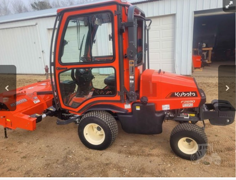

I have an F2690 that is too high to get into my garage. I‘m looking at buying trailer tires for the front
with same bolt pattern that should allow it to fit. The tire outside diameter will be about 16” vs 24”. Seeing this is a 4WD unit, will this be a problem.

Wait isnt the F2690 a lawn mower ?
Yes it is, I really BIG mower, think of a B driving backwards.
I think his issue might be because he has a cab on it.
34,619
9,846
aww. he didn't say THAT !!! Kinda changes the 'options'.
One problem with smaller tires, is grass cutting height could be drastically changed ???
And even more of an impact is on ground speed and 4wd operations.

I think he's talking about swapping on small ones just to go in the garage when he needs to work on it. Put the normal tires back on when mowing.
Short answer is that it'll be fine in 2WD. No reason it'd cause issues for short distances. Unless you go so low something drags on the ground.

OK, have to ask, can you not lower the ROPS, or just get rid of it ?
Should have mentioned I have a cab, not reasonable to remove it. I bought two trailer tire wheels, the bolt pattern is 5x4-1/2. These tires are 16” high rather than the front wheels that are 24”. This solved my issue. It takes less than 5 minutes to swap them out.
