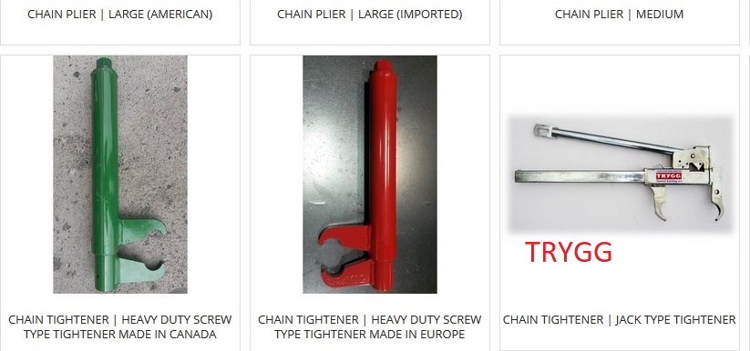

If you get studded chains invest in the TRYGG tensioning tool, aka a jack.
For two years I did without and when I got it I felt I had a gorilla helping me.
Chains are snug fit when installed as manufacturer recommends.
There are actually three similar jacks as shown below.

5,696
2,905
