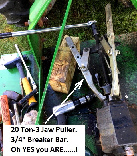

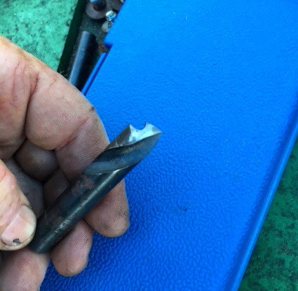

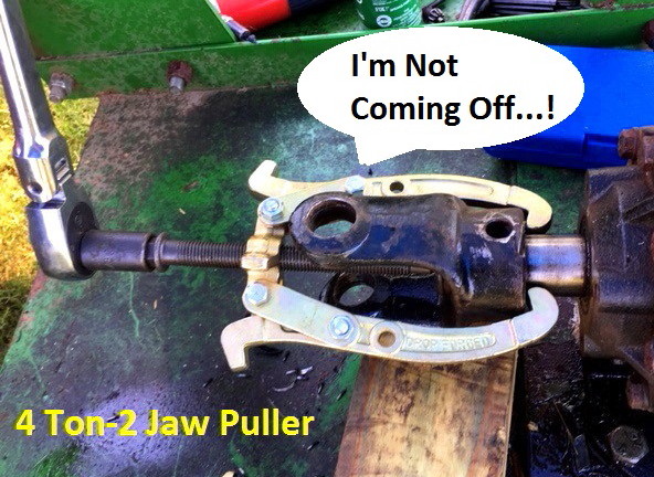

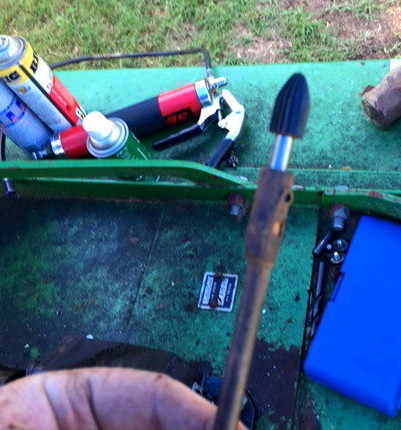

Well....I have to say 'It put up a good fight'. Getting the Ujoint out was a feat in itself, but finally got that done and down to the yoke(y). After a couple of broken 1/2" bits (and having to punch them out) I rigged up a carbide burr and was able to bevel the hole in both sides of the input shaft, insuring no metal shards/dings were holding it back.
After that.....I set up a 4 ton/2 Jaw puller and put a LOT of pressure on it. The Yoke didn't budge, in fact...I'm sure I heard it laugh.
Not to be denied....I got the big gun out (20 ton/3 jaw puller) and 3/4" breaker bar.
Even with that....it would build up pressure where you would think the whole darn thing was going to fly apart, then it'd 'Pop' and move about 1/8". Did that the entire way off.

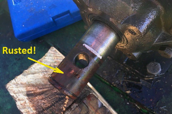

As first suspected....the Yoke and Input shaft had simply 'rust welded' themselves together.
I will install new U-joints and apply a 'generous' amount of anti-seize to the shaft when putting the yoke back on. Don't want to do this again.
