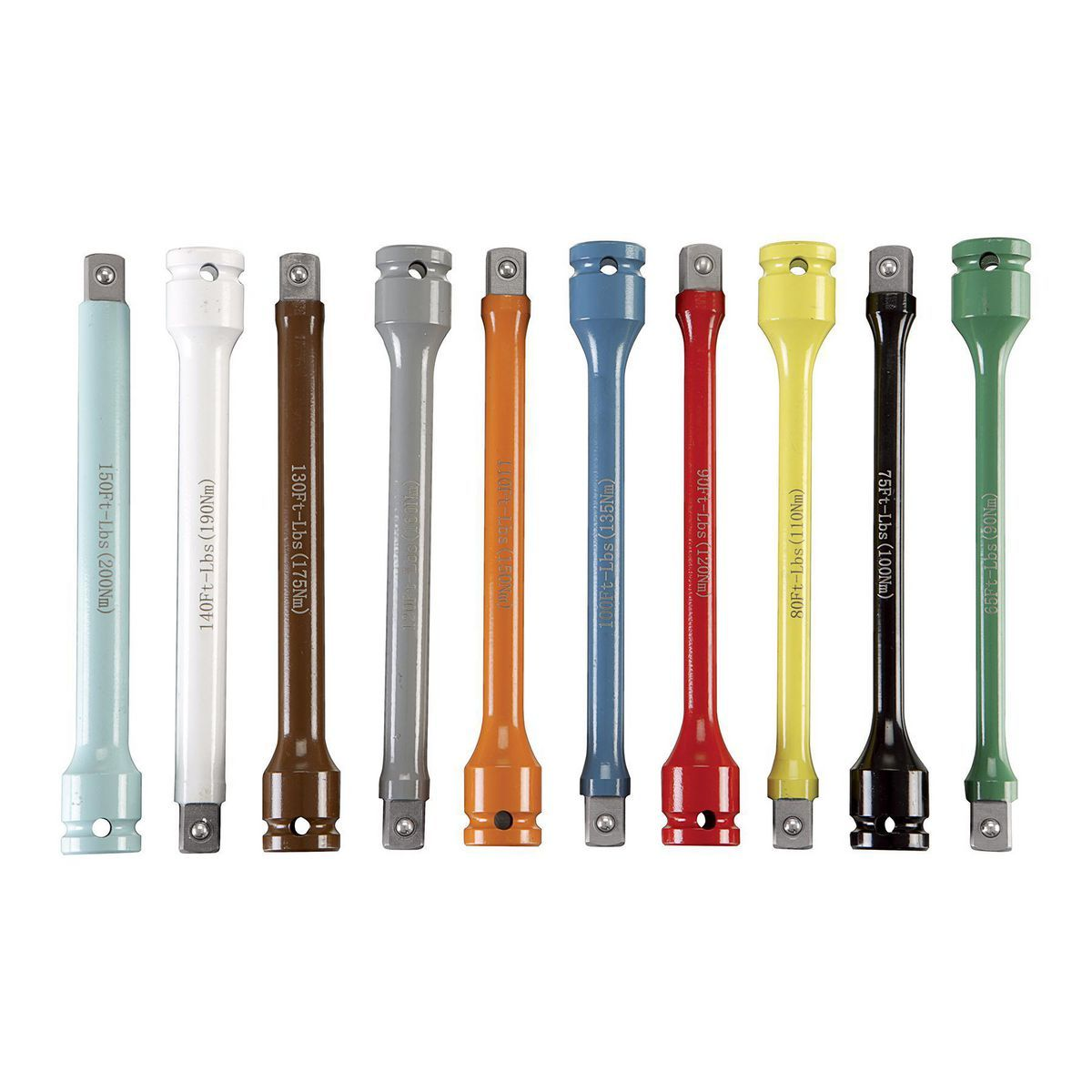

Tire shops that use an air powered impact wrench probably use torque sticks to achieve the proper torque. Note that these things may not work well with battery powered tools.
I don't use impacts much.. but those are pretty cool!
Edit.. I had to go out and look em up.. how do you know when it's at the right torque? Seems like if the pressure was up it would keep torquing beyond its specified torque. I read it was kinda like a torsion bar where it gives a little. Is it something that you just get use to the feel of it flexing and know when to stop? If not what's going to keep it from over torquing? Yes now I want some of these!

The torque sticks twist a bit not allowing the impact wrench to grab its next click. They do prevent over tightening and the results are nearly right on. I wouldn't use them for critical work but for lug nuts they work great since a couple of pounds one way or the other is insignificant. Again, they are best used with air powered tools, and should be tested before use on others. I have checked lug nuts tightened that way at a tire dealer and they were spot on.

Thanks for the info.. think I'll pick some up and I would just use on torquing things not super specific or critical. At least I could get close and know I'm not over torquing something accidentally.
