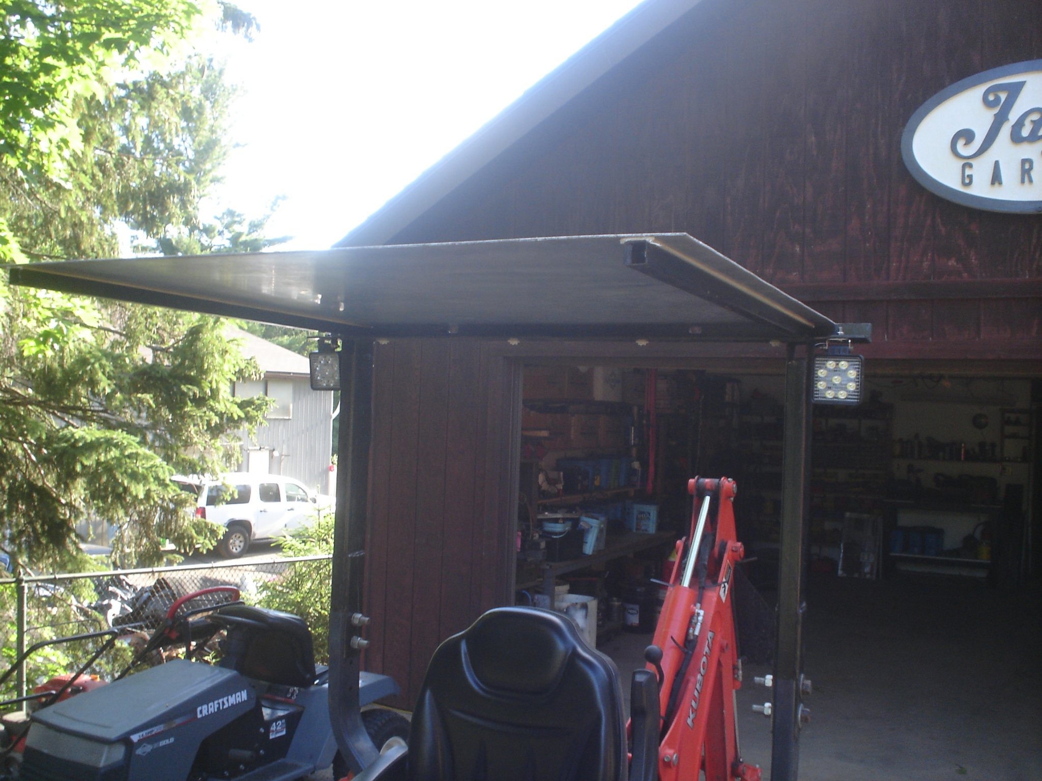

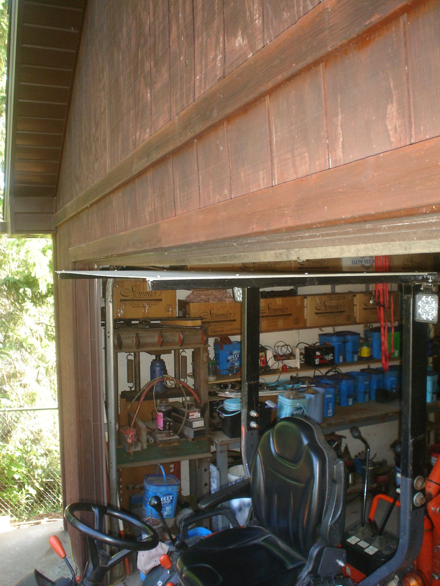

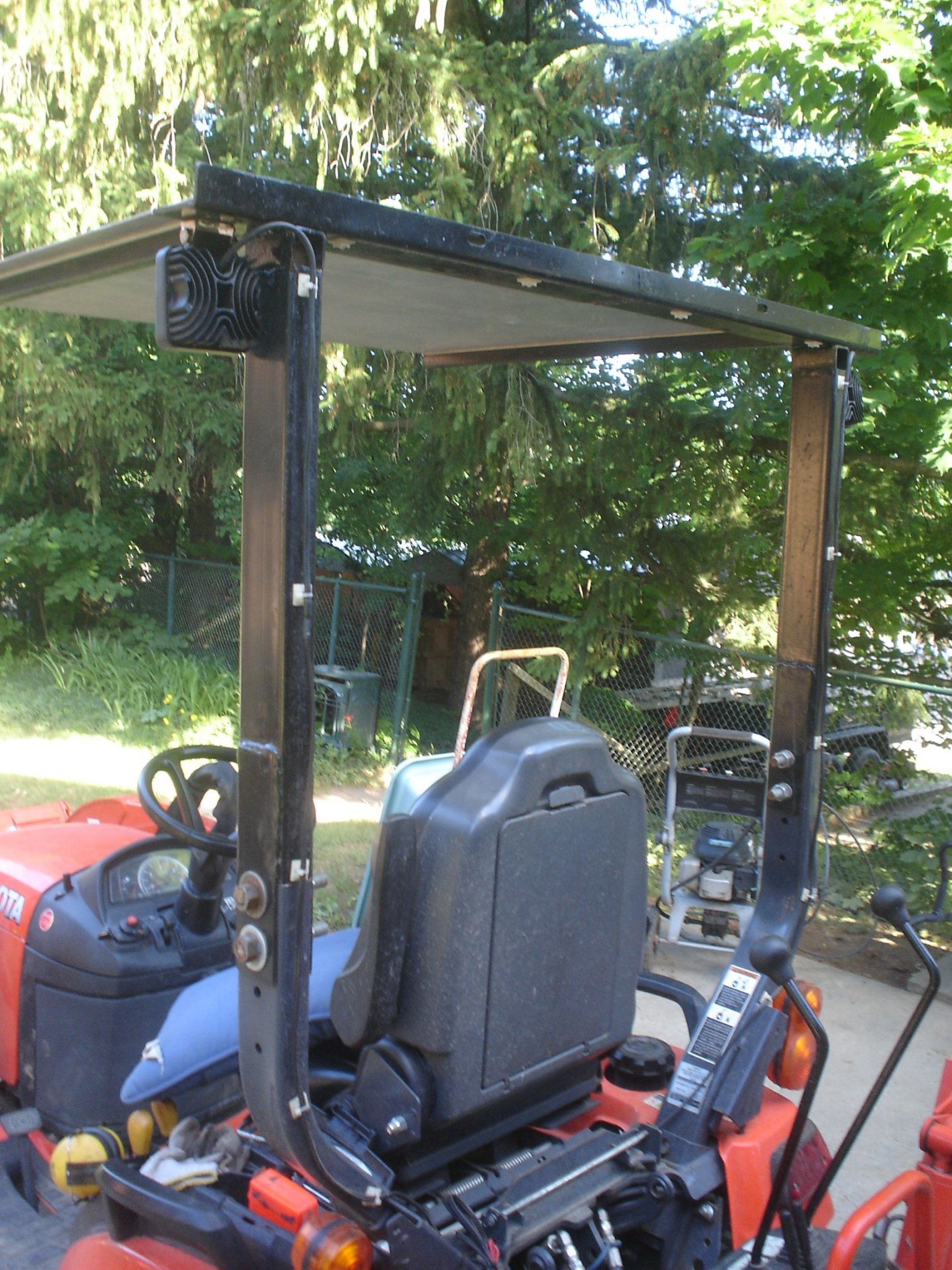

I made a shorter version of the ROPS for my BX23S, so I can drive it THROUGH the 7' garage door opening NOT hit the dang wall.... screwed an aluminum plate on for 'sunshade',works GREAT, keeps Mr. Sun off me as well as most raindrops. even works well when using the backhoe. Of course I added some LED headlights as the stock ones are, well, useless.....

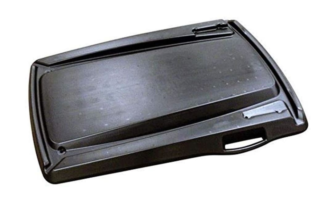

I just purchased a rhinohide canopy. I like how they can be installed lower on the rops, tool-less removal / install in seconds. They look like plastic garbage can lids and should hold up to the abuse of being tossed around easily.
I dont have a quarter inch of clearance with the rops folded halfway back to get under my door, so this was a solution that worked. Most of the others all attached a mount to the top of the rops, rather than the side.

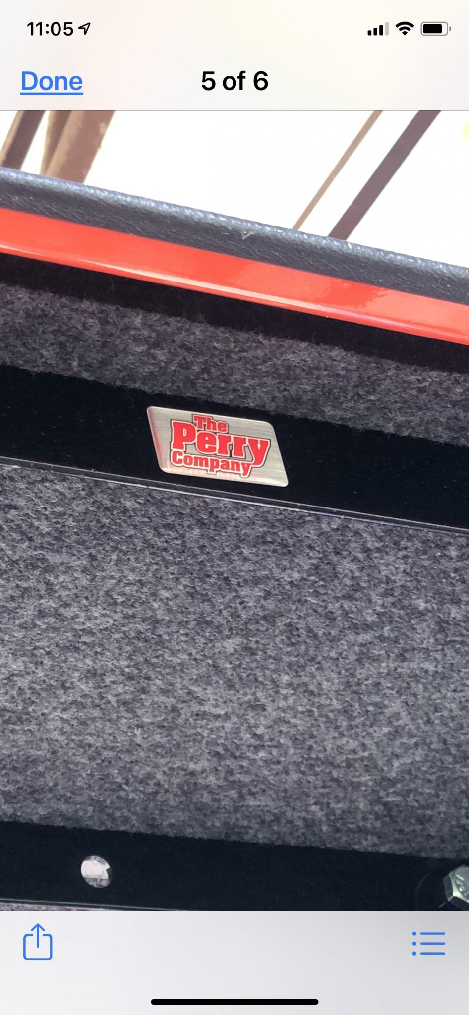

Unfortunately I do not know the brand. Its the only one the Kubota dealer here sells (other than a smaller plastic one). Here are some good photos photos. If you type in 'kubota canopy' you can match the photos and maybe get a brand, I saw mine ...sorry. It is HEAVY and rock solid. The problem I have with the plastic ones (golf cart kind) is they break easier.
EDIT: In looking at my photos I see a sticker, let me look at that when I get home, if you think you may be interested.

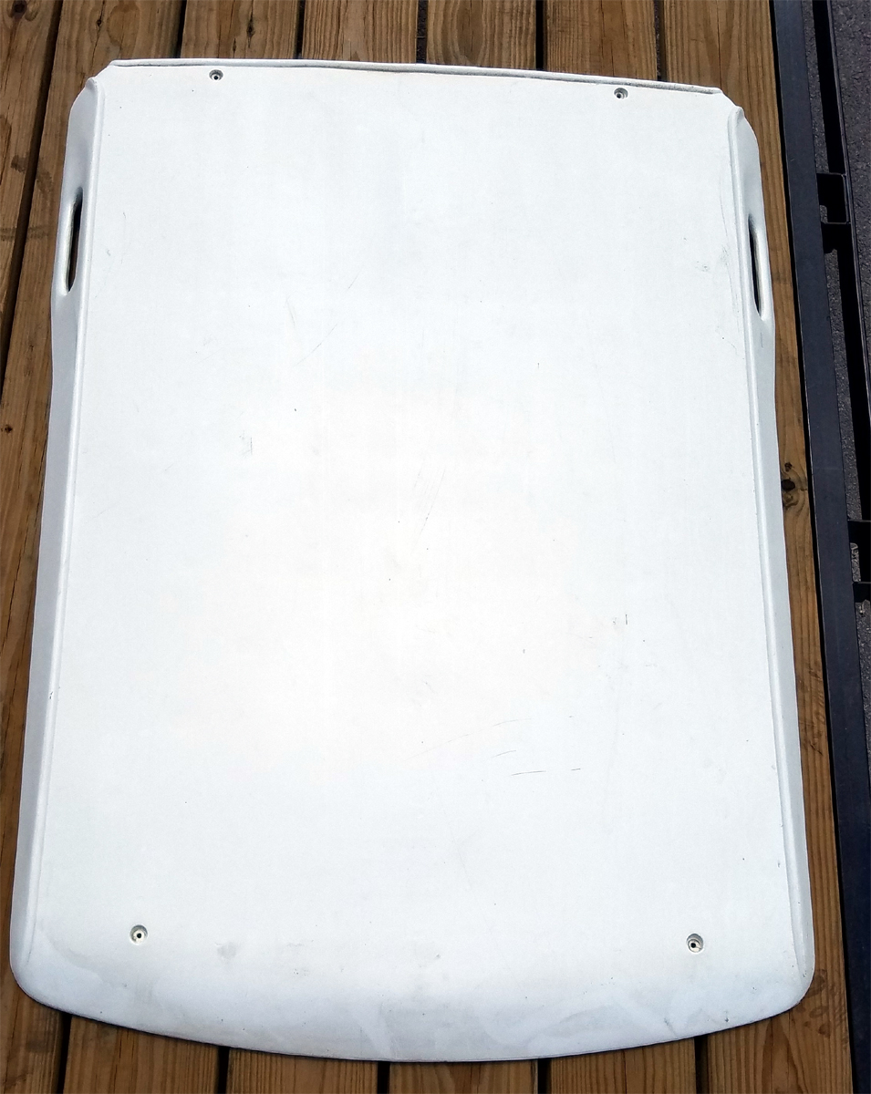

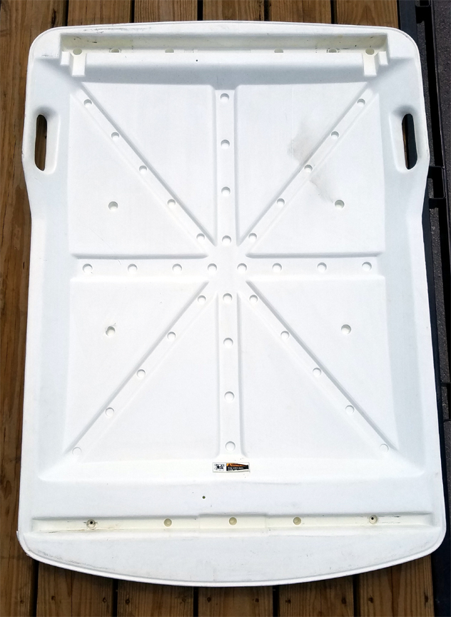

I stopped by a local golf cart sales and repair business this afternoon after picking up another binder and 20' chain for the trailer. I bought a used EZ-GO canopy for $75 and will make my own "quick detach" mounting system that keeps the canopy as low as possible. I'll paint the top of the canopy Kubota orange and might leave the underside white.
The canopy is very stiff and comes with nice bolt holes molded in. This should be a fun project.

The cart roof I went with is for a EZGO.
I got it from a local golf cart guy.
I mounted it handles forward.
The install was a design/build. There is a channel that runs right across the back that I set on the ROPS and then propped up the front with a 2x4 down to the hood to get the height/angle right. From there I measured/made the frame for it to bolt to. It handles highway speeds without issue.

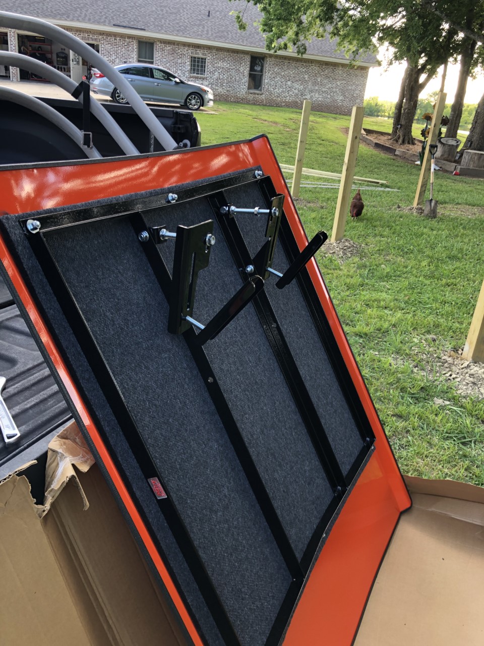

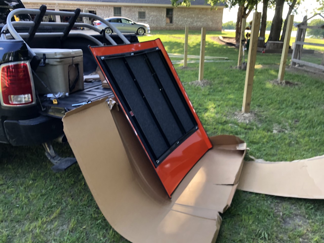

I have canopies on my tractor and zero turn, I had a skin cancer issue on my head a few years back and I am trying to not let that happen again. The only downfall I have found so far is working around trees. My dealer installed a canopy from this companyhttps://thunderbirdaz.com/
I wish I had purchased work lights from them, the Kubota work lights and mounts are not to my liking. Picture of tractor with canopy is shown in my avatar.
