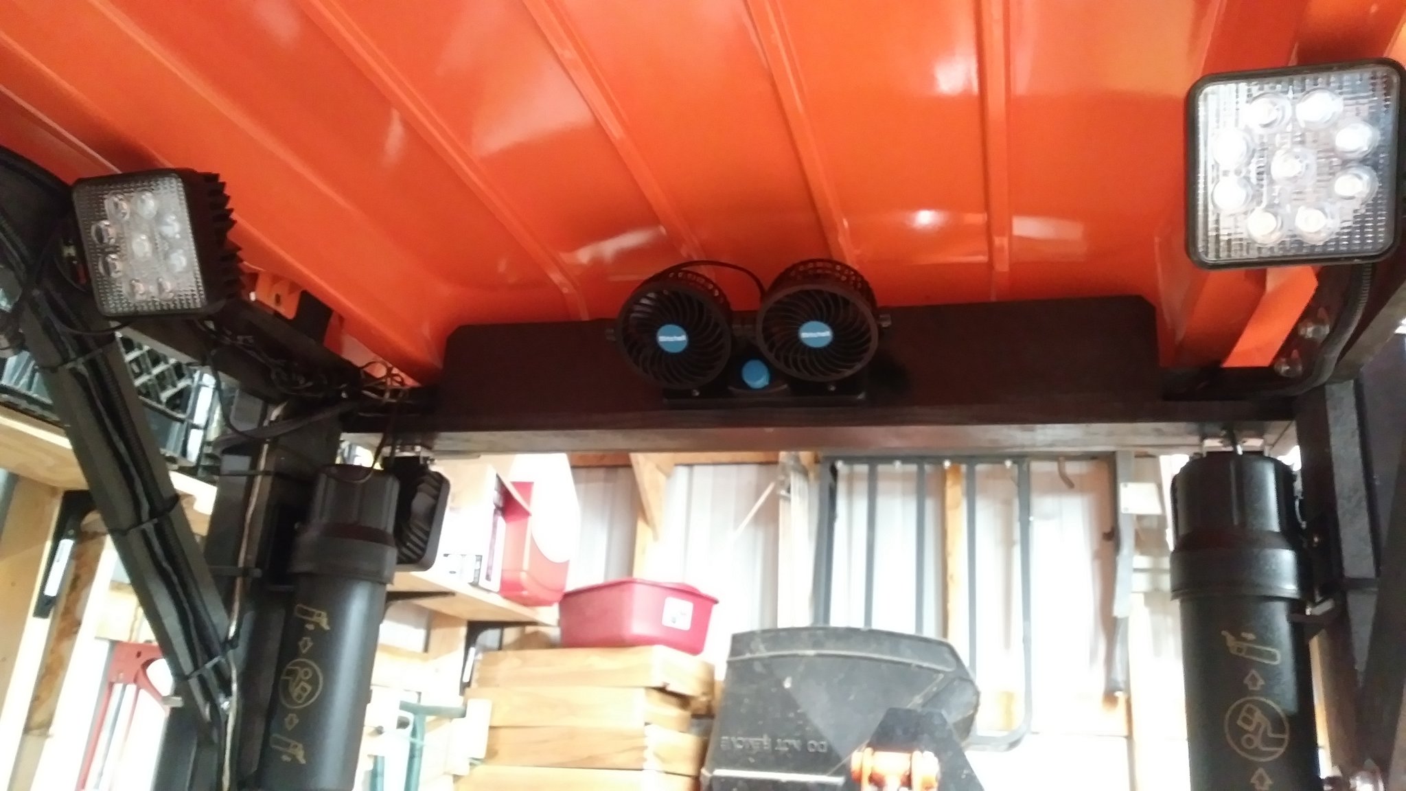

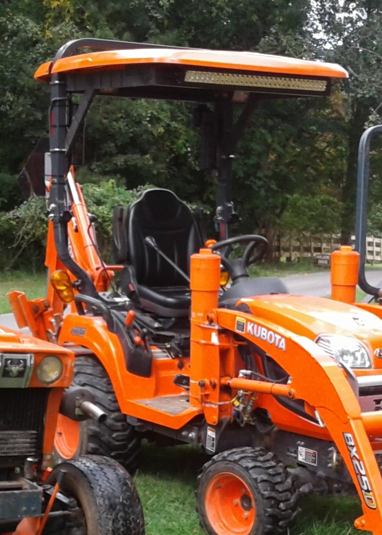

I made a shorter version of the ROPS for my BX23S, so I can drive it THROUGH the 7' garage door opening NOT hit the dang wall.... screwed an aluminum plate on for 'sunshade',works GREAT, keeps Mr. Sun off me as well as most raindrops. even works well when using the backhoe. Of course I added some LED headlights as the stock ones are, well, useless.....

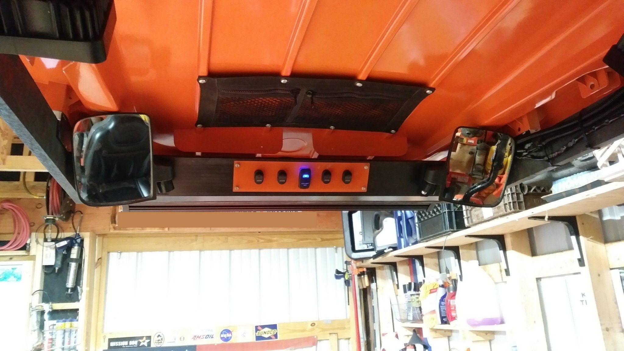

I built mine simply to knock out the sun - it works better than expected. A cheap used golf cart top and little bit of head scratching......
Plus a fan
mirrors
small storage
lights
even a speaker when time allows!
I do not have any resonating sounds from it.
That cowboy hat acts as a huge reflector, where as the baseball cap has a smaller reflection of sound.
I would say get you one and enjoy the benefits of having.
pics please, pics of all of them please! Thanks.

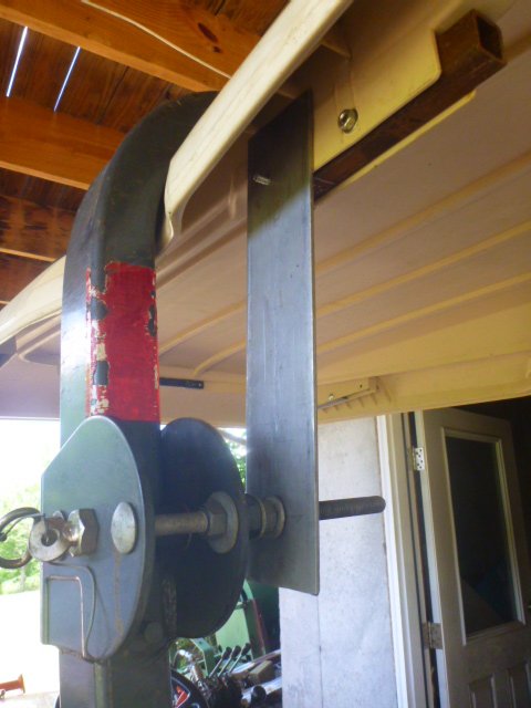

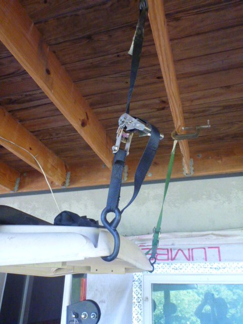

I parked the tractor under my deck, use C clamps on the joists to strap the top up where I wanted it. Bolted it to the rops using an existing hole. Then made arms to support the front.
I mounted mine below the rops since I have barn clearance issues.

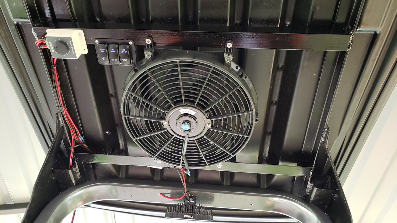

In my case I tow a lot and most of the canopy "Kits" say do not tow with them. I wanted a highway rated setup so I built my own. I also added a fan, lights, mirror and time/temp/volts gauge. I am very happy with the results.

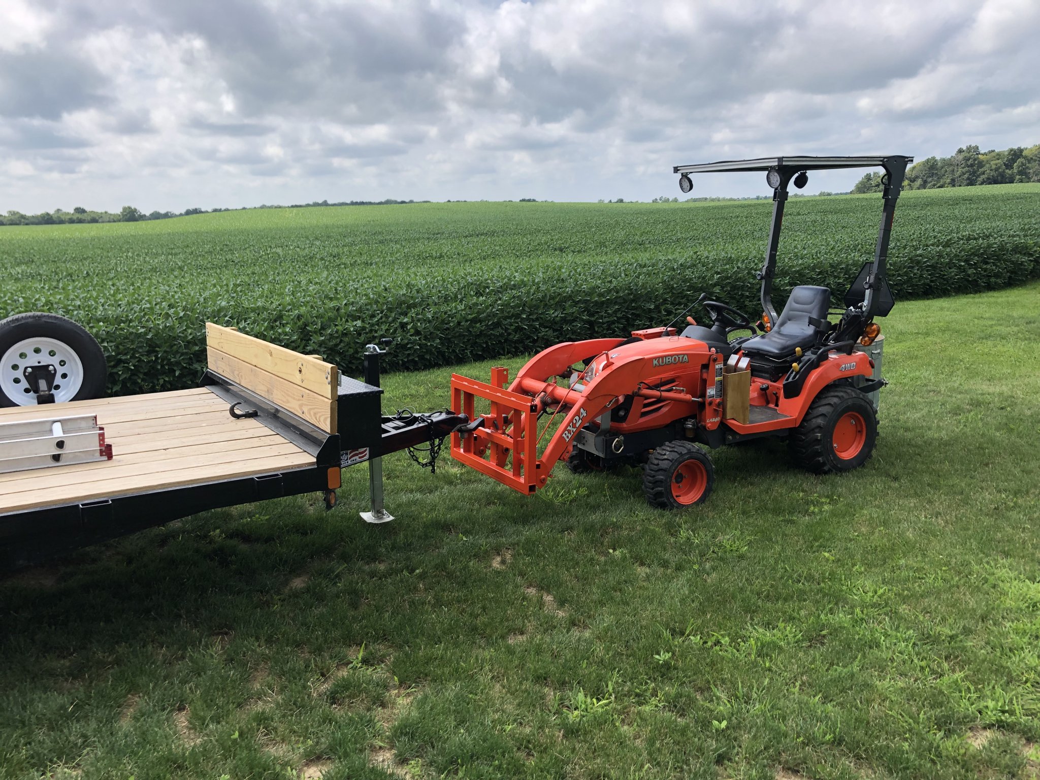

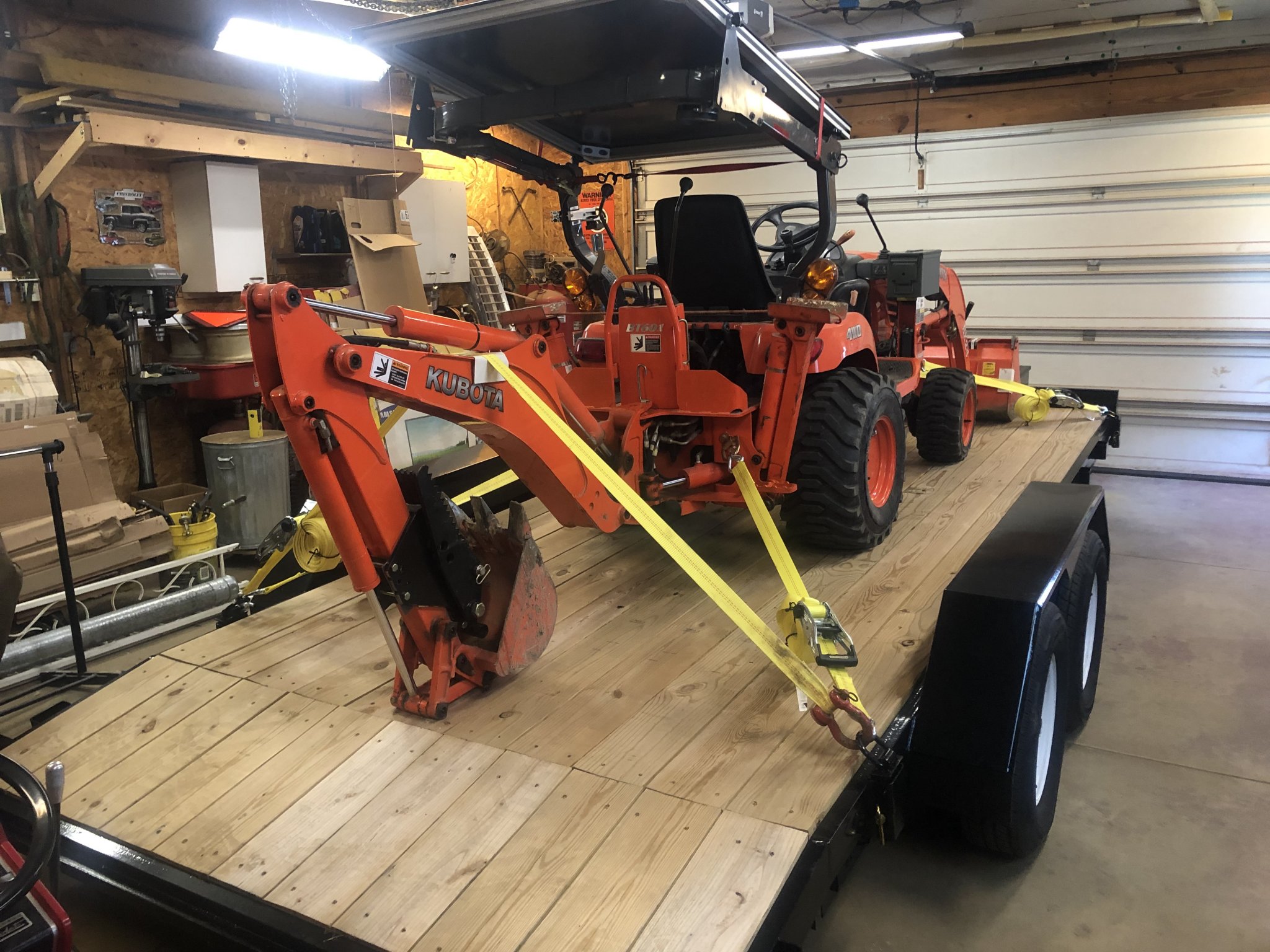

I built mine using some free aluminum extrusion from a friend and covered the top with 1/4” HDPE plastic. Made it hinged so I can fold it and the ROPS for towing. With it folded down on my trailer, it just clears the 8’ door on my shop.
