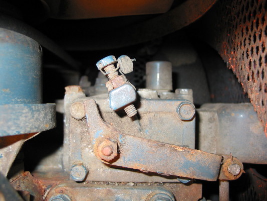

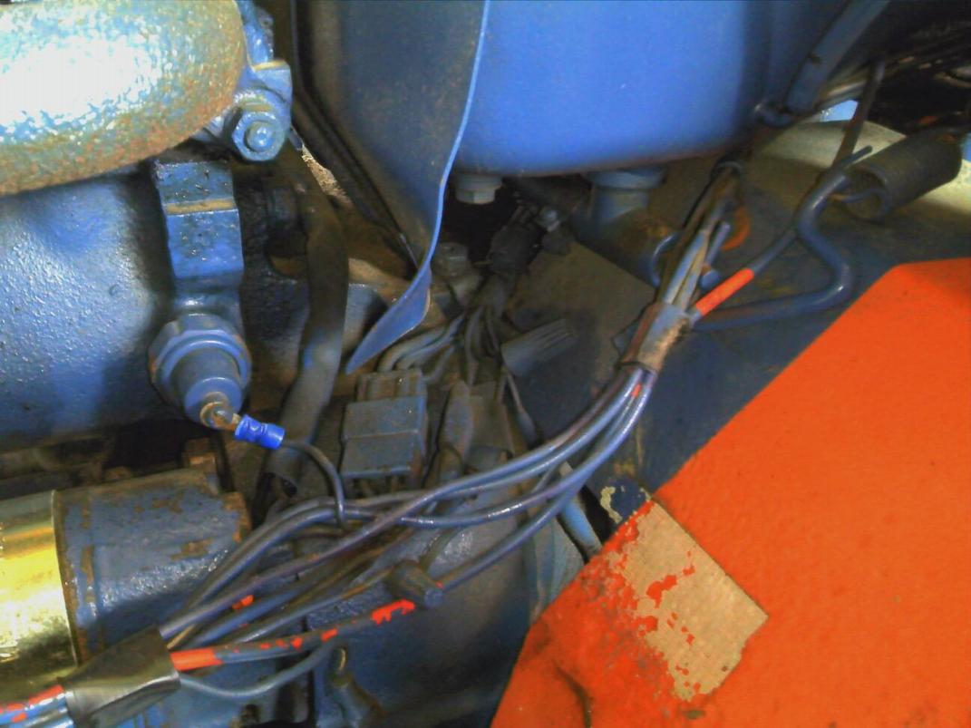

I'm wondering if my B7100 has the same setup as your photo. I have attached the best photo I could get with the side cover & hood in the way.
From what I can tell, I'm thinking that it does not have the setup for the tach. Maybe the tractor was not equiped back in the day when it was built
I believe it was built around 1980.
I have a chassis serial #: B7001-70xxx
Maybe I'm messing up by not using the full model number. I believe it is actually referred to as a B7100D.
Can you tell from my photo, if it is possible to add the factory tach.

Thanks Vic. I'll wait to see what responses we get from the photos request you posted.
I also need to check the B7100 again, as it has an 12 volt, hour meter, that I believe is wired to the key switch, and is mounted on the left side of the dash, that I always thought was factory issue. Maybe I have the optional hour meter. I will now look closer to see what brand it is & to see if it looks like part of the factory wiring harness.
I do see where the cover plate is located for the tach drive unit, from your picture & the picture I took. Still hoping to add some type of tach to her.
