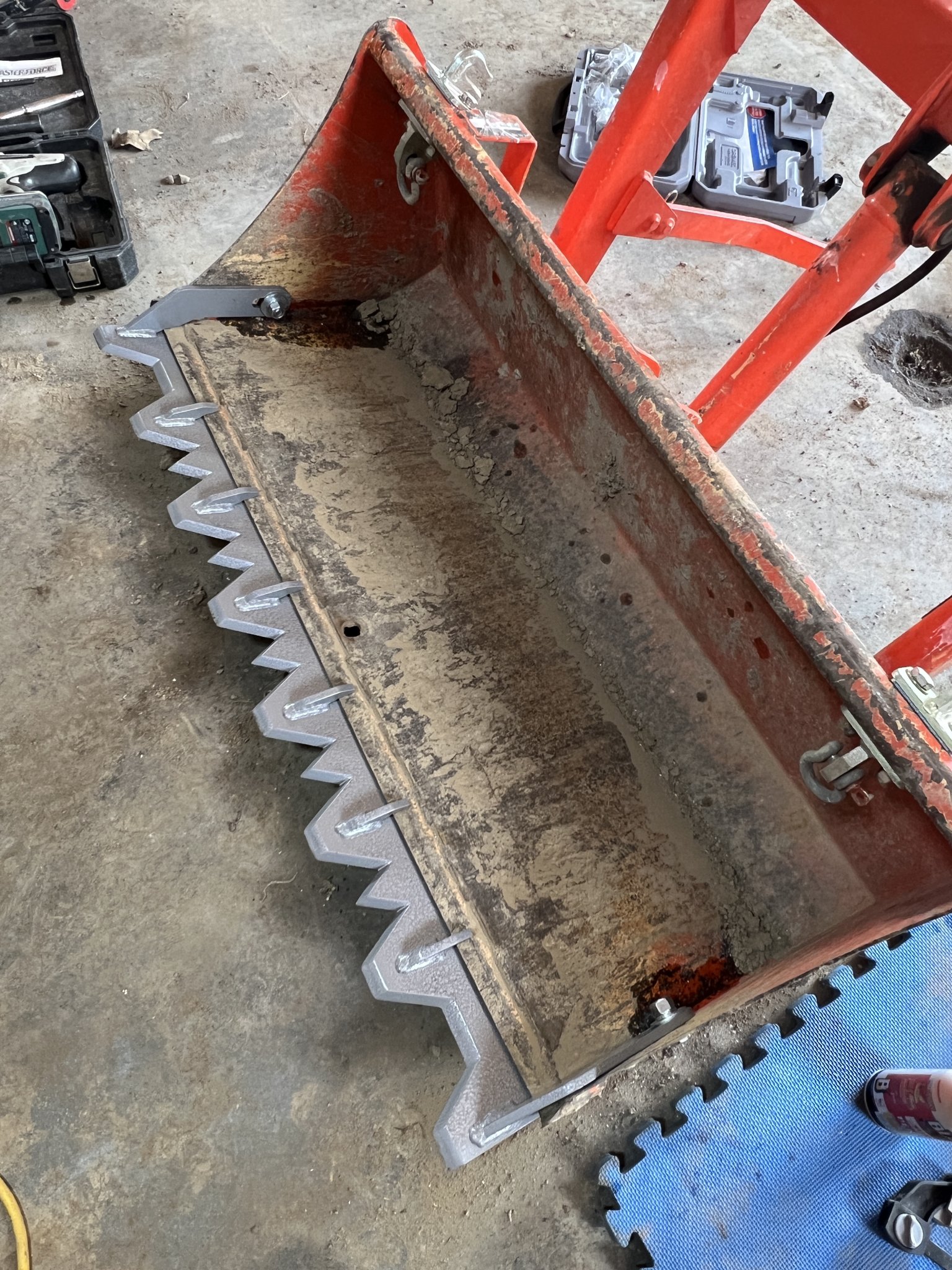

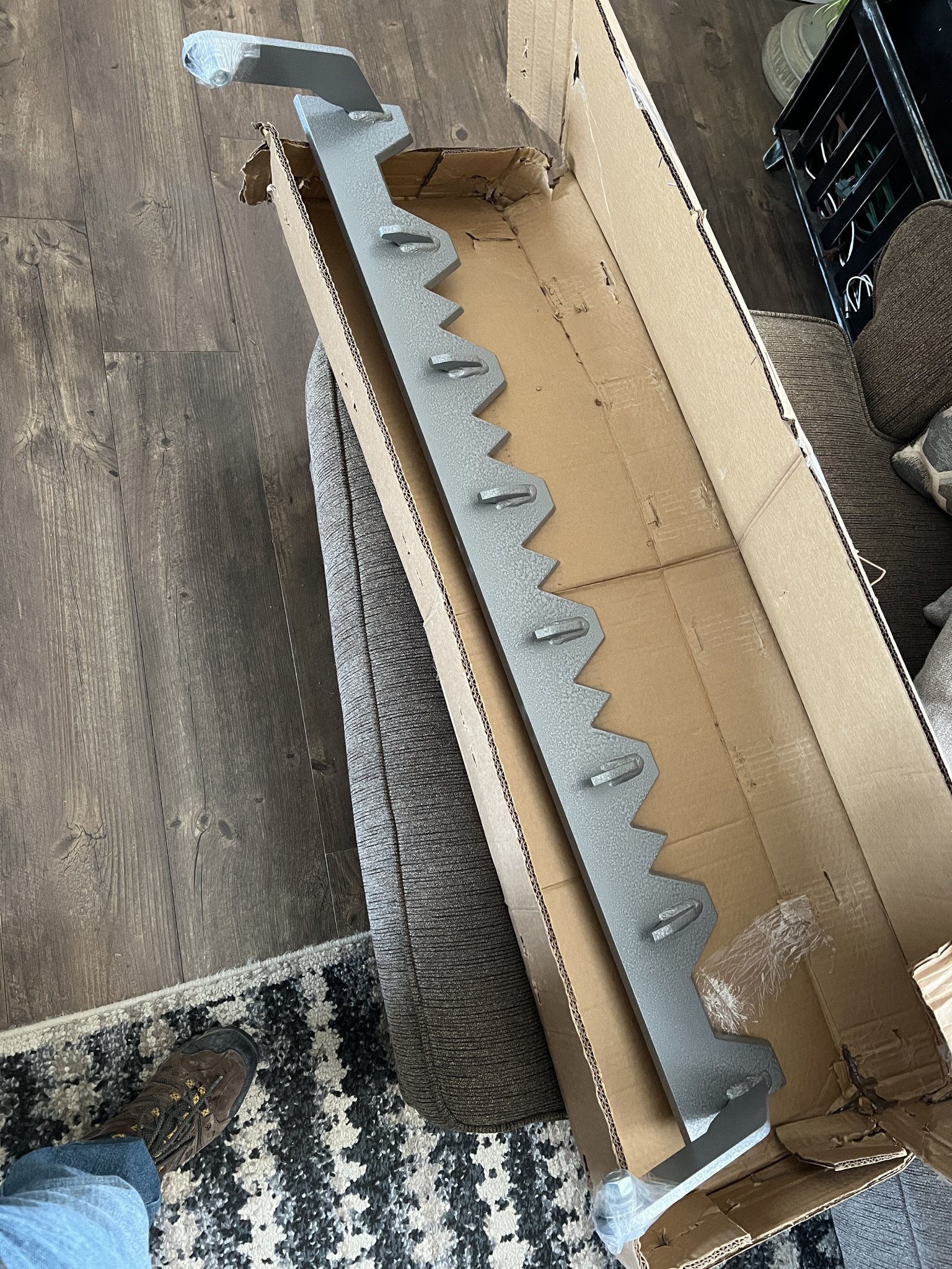

I went with a Piranha Tooth bar. Less work to install and works better than the factory one.
Probably overkill, but I put the Kubota bolt-on edge on mine to strengthen it, then 'special ordered' the Piranha edge modified to fit over it. (no extra cost, BTW).
I've seen a couple buckets with 'smiles' and don't want that to happen to mine.

Since it's impossible to use a new edge as a jig or guide to drill holes because it's longer than the approximate 47 1/2" inside width of the bucket (assuming drilling is to be done from the inside of the bucket)..............
Bingo. Clamp the edge on the bottom and drill from the outside. It probably wouldn't affect much if you trimmed the new edge to fit inside ( just for drilling the holes, still mounting it on the outside).
I bought my mag drill a few years too late for drilling my bucket. It was a good bit of work for a handheld drill.
