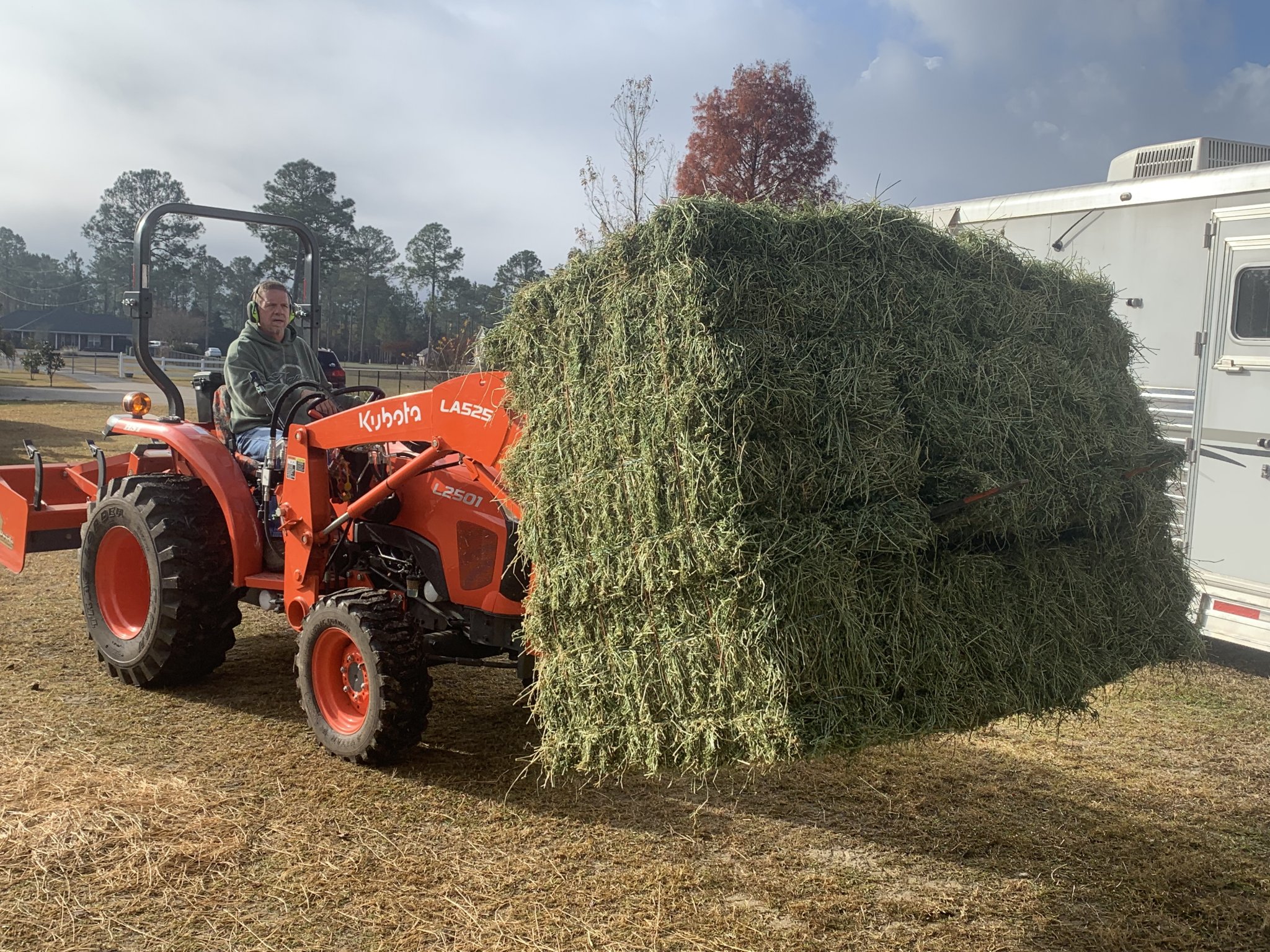

Goz63
Kubota L2501, LA525 loader, QH15,Land Pride RCR1860, BB2560, SGC0660, forks
Jun 19, 2021
299
349
Mississippi
I think you should get a bale and see what it does. I get hay cubes, which are 21x65lb bales banded together. This fall I will be seeing what number the tractor will lift and just move 30ft into the barn. All flat ground. Environment will play a factor.
Well this was my post then, this is now. No sweat.

Well this was my post then, this is now. No sweat. View attachment 72751

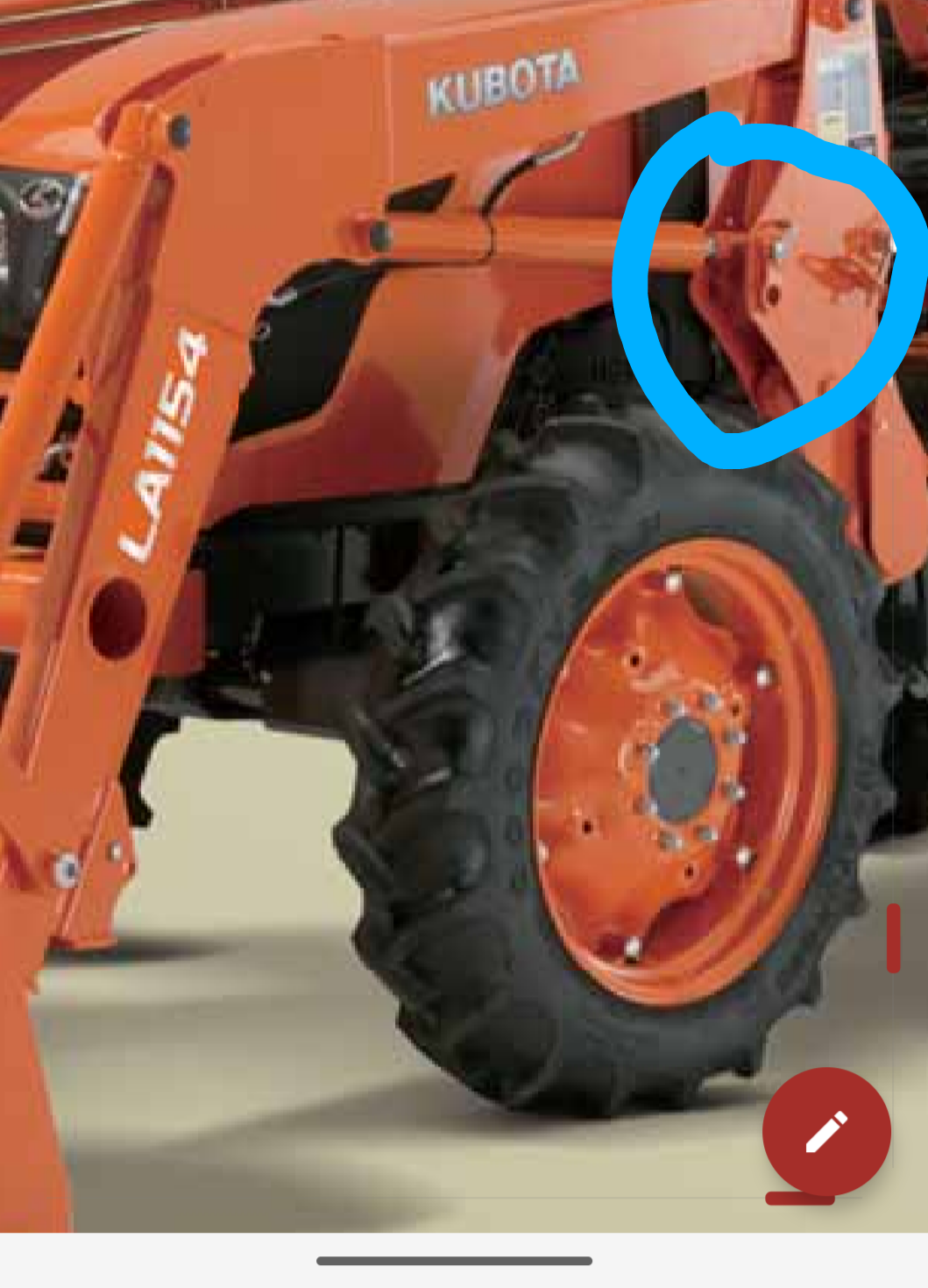

My bad. I thought the 2 curves on the graph showed the capacity at 2 cylinder positions. (Probably showing cap. at the pins and at 24"?)
Some loaders have 2 places the cylinder can be pinned - one gives higher lift and one gives more weight capacity. This may be only on the larger loaders like the LA1154 below.
greg86z28
May 17, 2020
303
171
South Central Wisconsin
View attachment 72812 View attachment 72812
Hey that's pretty cool.
12,445
5,379
Hay Goz63..
gotta ask, did you defeat the seat switch ?? cause HOW do you see 'over' the load ! My luck, engine would shut off EVERY time I'd get up to make sure the way is clear.
also , are those a bunch of small squares ? maybe 12 ??
