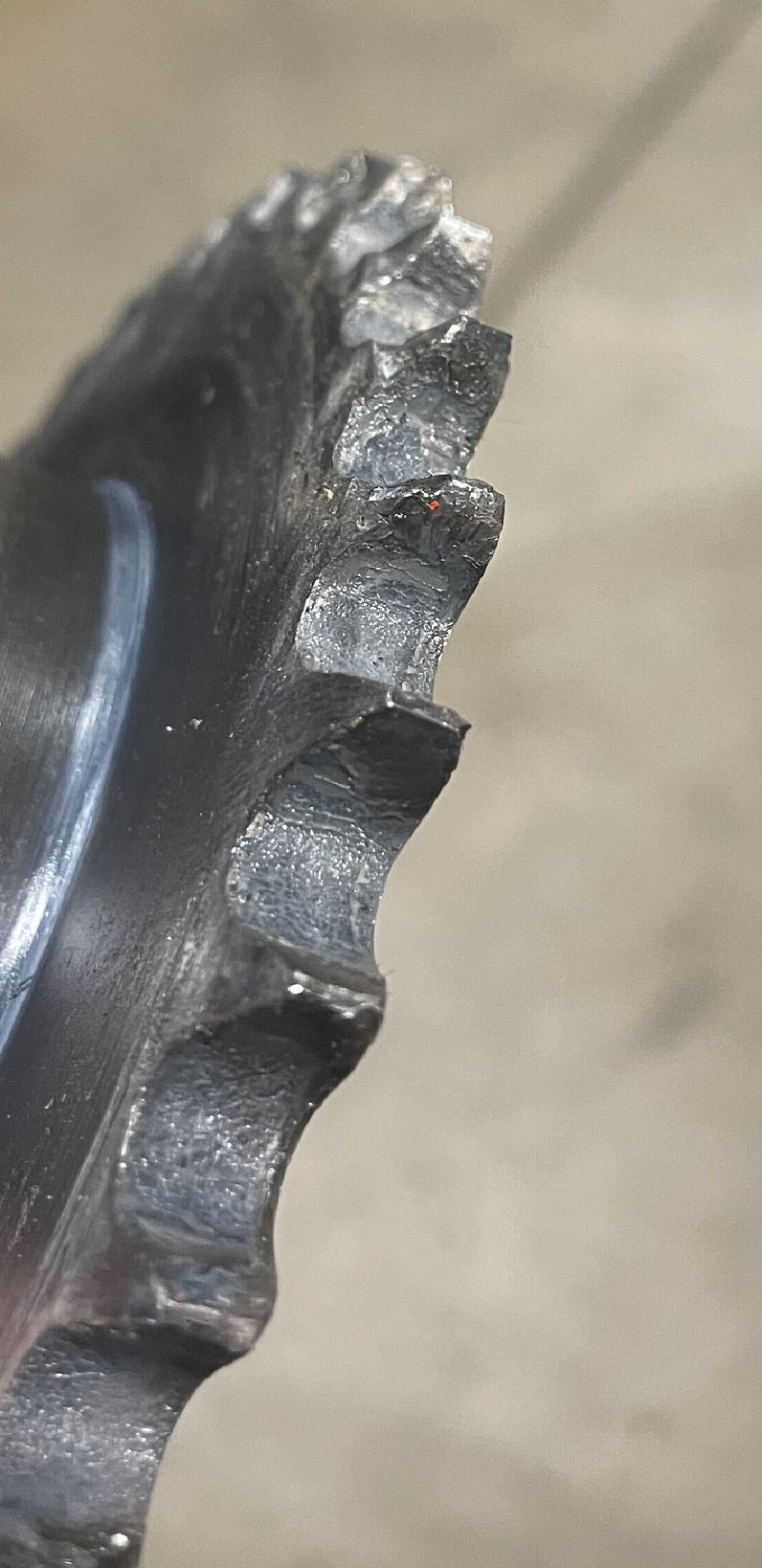

19
Pa
Be sure if they were running out of line for any period of time that your sprockets are not heavily worn. This one came off a used BX5450 that I bought. I ended up replacing both sprockets and the chain as a precaution and due to the horrible grinding sounds it made even once aligned properly.

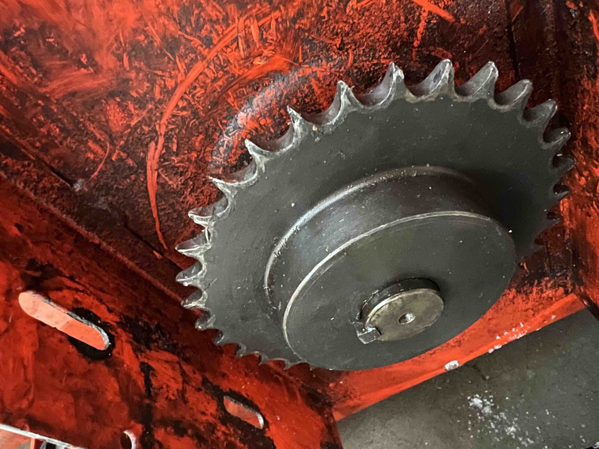

mdougher74
Dec 1, 2019
7
Spokane, WA
Thanks everyone. YNot, thanks for the photo of your sprocket. Judging from the looks of mine, its probably in need of replacement. What do you think? The bottom sprocket looks brand new.
How do I get this big sprocket off?
I've removed the two set screws, but it seems like the axle is flared at the end, and while i can get some movement, it stops dead when the sprocket is flush with the end of the axle.
It seems like any adjustment in the alignment of the sprockets is intended to come from moving the top sprocket. I appear to be about 1/4" short of what I need. Is my only option to move the lower sprocket, or is there some way I might be able to adjust the top axle out to get the additional reach that I need? Any advice?

YNot
Mar 6, 2022
19
Pa
My upper sprocket was also tight. Once I made up my mind to replace it, I used a two jaw puller to pull it off the shaft. Once removed, I used some fine sand paper to clean up the shaft at the edge until the new one went on with only minor resistance.
If your lower gear is like mine, it is welded onto the small shaft. You have to adjust its placement by loosening up the set screws or collars on the two bearings it runs through. Once they are both loose that shaft should be able to be pushed into those bearings more. Past moving that shaft, there is no way to move the sprocket on the short shaft itself.
11,421
4,908
I suggest moving sprocket as far away from end of shaft.... grab key real good with vicegrips, whack vicegrips to pull key out of sprocket and shaft, take file and lightly smooth the end of shaft.
sprocket will come off.
yes, you may need a new key, though chances are you can just fille off any burrs the VG jaws made....

tinkerwitheverything
bx2370-1
Jun 3, 2015
319
72
Manitoba
Grateful for you all.
Looking at the end of the shaft looks like it's been hammered on and mushroomed the end of the shaft. From what I can see your going to first have to get rid of that burred end. If you can just leave the sprocket on this way you won't be grinding the shaft where its not needed to be. Either using a small die grinder or a file. You could use a angle grinder as well if you have the room. Take off only as much material as yo need to at the end of the shaft. . BTW if you go a little to deep don't sweat it as the sprocket sits further on the shaft then the end.
