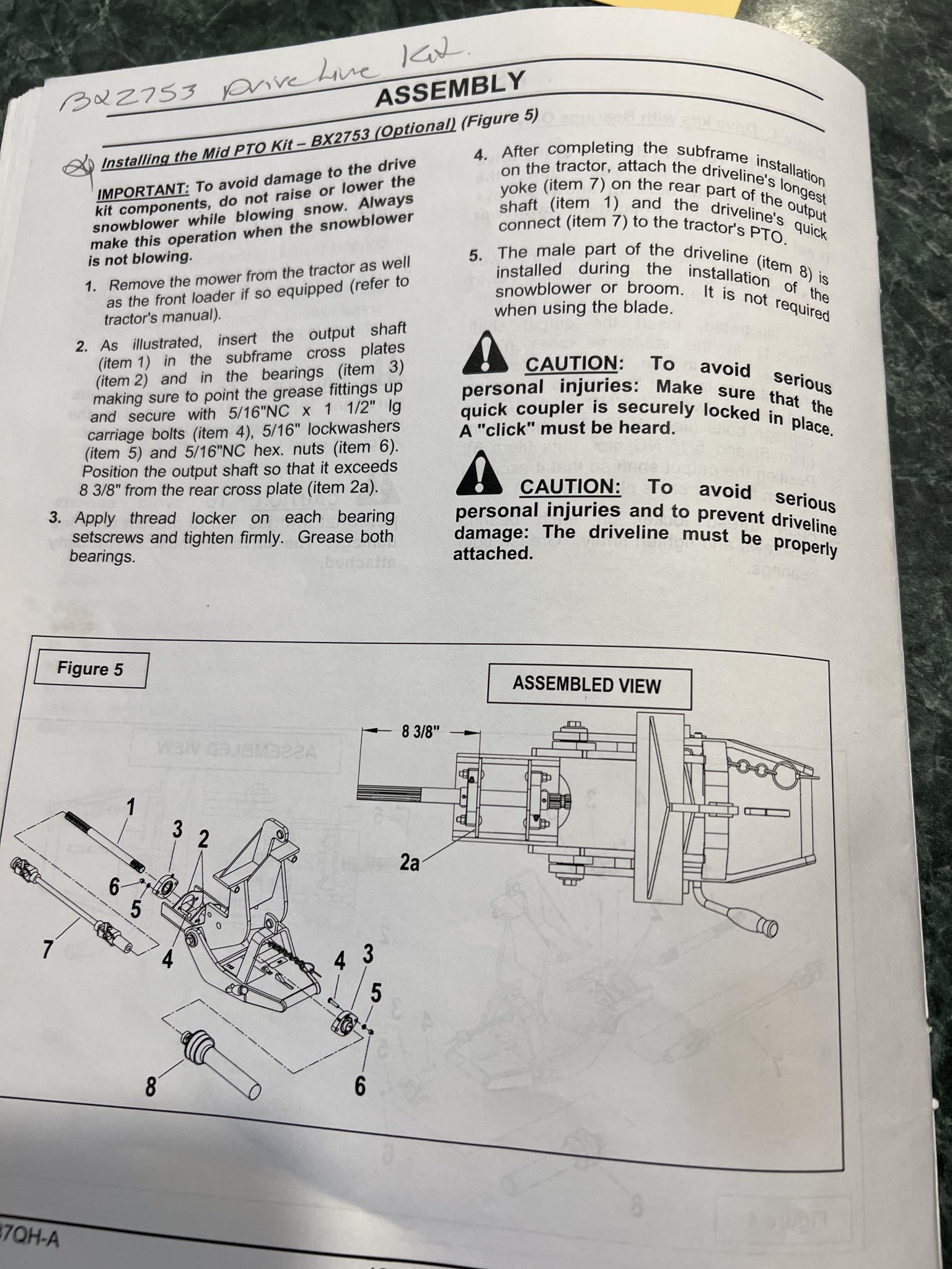

Are you saying maybe I can take the BX2051 Quick Hitch and replace it's 8-3/8" shaft with the shorter 5" inch one? That way the existing longer 2053 mid=-PTO drive shaft would fit?

Both the BX2752 and the BX2753 fit the BX1870
The BX2753 has a heavier front shaft and heavier bearings.
