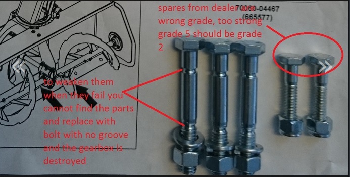

Some of those bolts are special, I would get the first set from a dealer to be sure.

I do get mine from the dealer for my BX2750D. They're $2+ each, but most years I just break a couple. Better them than a gearbox, etc.
They're grooved.
Hopefully you can read my Part numbers (I keep a sheet in my wallet with all Model, Serial, and P/N's). Not sure a BX2750C is the same, but betting pretty close.

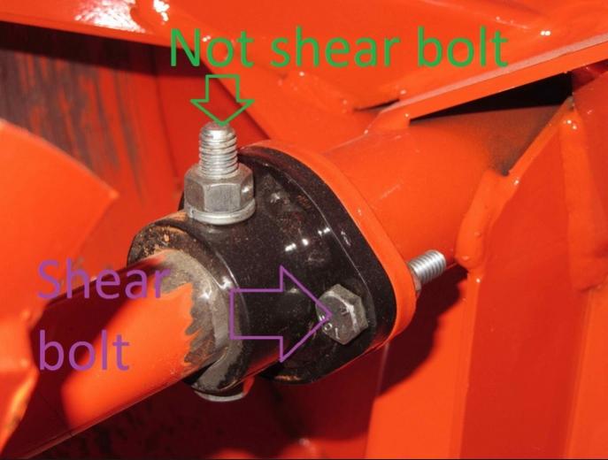

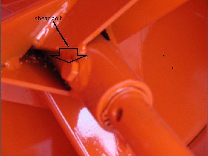

You need to check which style of shear bolt location you have.
The one with the shear bolt through the fan shaft is the old style and was trouble. The new ones come with the flange style. The black one in the photo is a retrofit. New blowers everything is orange.
The caution on the grooved shear bolts is to be followed. Some dealers have provided wrong bolts to owners.

I have had two different BX2750D. Latest model has the flange shear bolt, original had the Gr8 bolt thru the shaft.
The design/shear bolt depends on the serial numbers. Serial numbers 21219365 and up use the Gr5 flange shear bolt. Those below use the Gr8 thru the shaft, which was a horrible design. The reason I got a new 2750D was that the old one eventually warped the drive shaft when I sucked up a small piece of 2x4. Repair costs (and new gear box) was about 1/2 the price of a new blower, so I got a new one....
