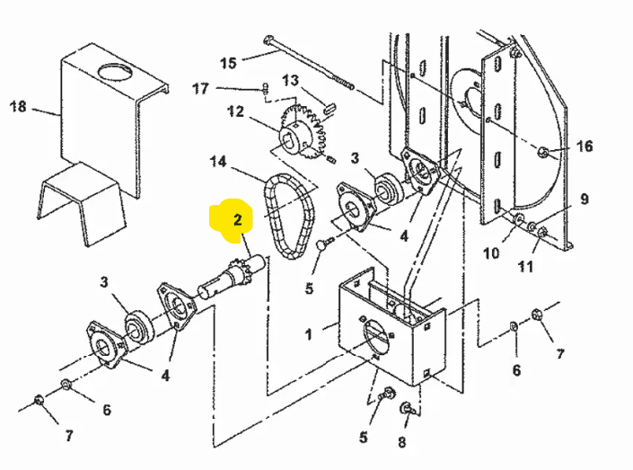

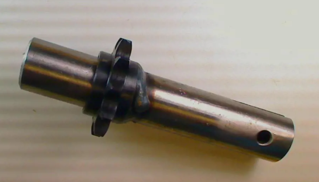

Mine is back together and working great with a 1/4x20 coarse bolt, nut and locktite.
some helpful images. New shaft is welded.
