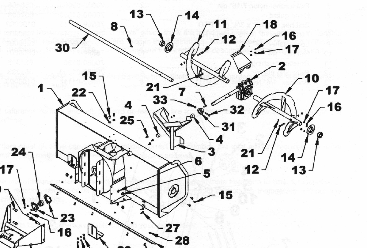

I need a nut & bolt set for my snow blower. It is the one just forward of the fan holding the two flanges together. The one just back of the shear bolt going through the shaft. Is it a shear bolt also. It will be shorter and smaller diameter as the shear bolt in front of it as well as the two shear bolts ( one at each outboard ends of the auger). Can anyone give me a part number please.

I know the bolt you are referring to and it is a standard soft bolt, nut and lock washer. They don't break very often and the part is discontinued and says to source locally.
O/L OBTAIN LOCAL (number 7)
Part # 70000-74028 Discontinued
-OBTAIN LOCALLY
If it is number 6, you can also source it from a local hardware store, make sure that it is a "common bolt, not a #5 or #8. That is crazy money from Kubota.
FAN SHEAR BOLT 1/4X 1 1/4"-KIT
Part # 77700-11443
-BOLT,SHEAR 1/4" NCX1 1/4" G5 (FAN) *

This is the image for my BX2750D, Canadian version: (part description below picture)
Part 7:
Shear bolt l/4" NC x 1-1/4" w/ lock & nut gr.5 Part # 70060-01075
Part 32:
Bolt Hex. 5/16" NC x 2", gr.8 Part # 77700-04112
Matching nut, Part 33 Nylon insert locknut 5/16" NC Part # 75599-31912
Part 12:
Auger
Shear bolt 5/16" NC x 2-1/4" w/lock & nut gr.5 Part# 70060-01338
Auger bolts may be grooved
Part 7:
Part 32:
Part 12:
Auger
Part #7 is the exact part. Thank you. Now I know the size 1/4”, the length 1-1/4”, and grade 5 with appropriate lock nut. I tried another link that someone else sent but being Canadian I wasn’t authorized to open the site. Have a great day. Thanks
