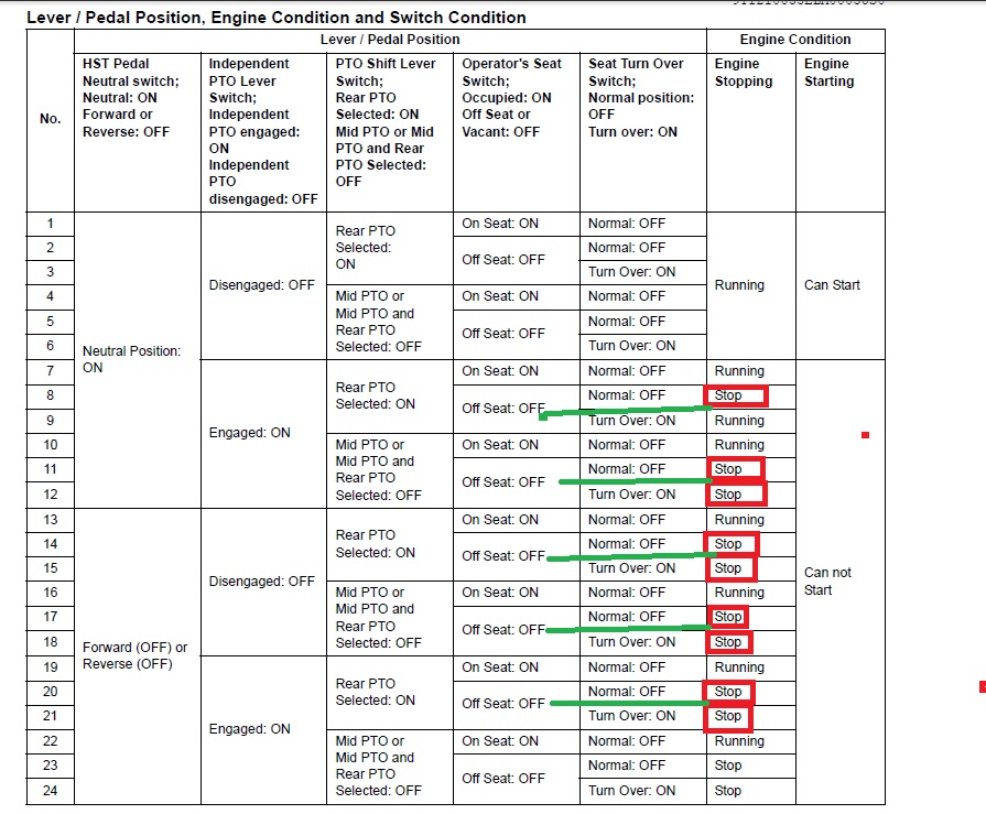

Your description of the way the stalling presents itself makes me think there is a safety system involved in all of this. Typically called an OPC for Operator Presence Controller.
I have attached the logic chart from the WSM outlining the conditions that stop the engine.
Note that the OPC system takes one second to shut down the engine so this can be a big clue.
I have taken a screen shot of the same paage and marked it up with red boxes showing the number of conditions that can cause the engine to stop.
The seat switch figures predominantly in all of these engine stop conditions.
If you need help understanding this information, please ask.
Typically in an Owners' manual there is a simple check out procedure the owner can do to verify the proper operation of the safety systems. I have attached the page from the Owners' manual dealing with checking the OPC operation.

Thanks Dave! Not convinced its safety switch related at this time; tractor never completely shuts down and will run fine for awhile before choking starts. I will keep this info though for future reference. Once I eliminate fuel tank, fuel filter, and and/or possible water in fuel issues I may have to revisit safety switch possibilities . I will be relocating fuel filter from under tractor to more accessible location and with filter upgrade soon. Meanwhile the tractor sits until extreme cold spell passes and I can work on it. Thanks again.
