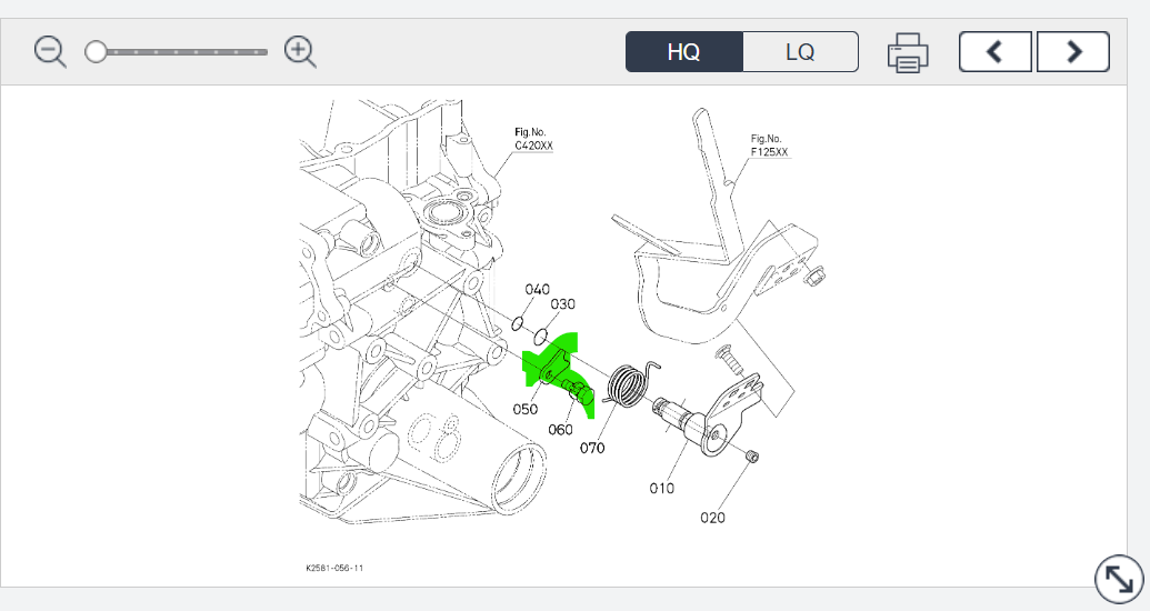

Look at the BX25D parts diagram I posted. The "plate" is on the end of the shaft thar shifts the PTO. Part #10 in the diagram

I'd remove bolt 060 and retaining plate 050 first.
