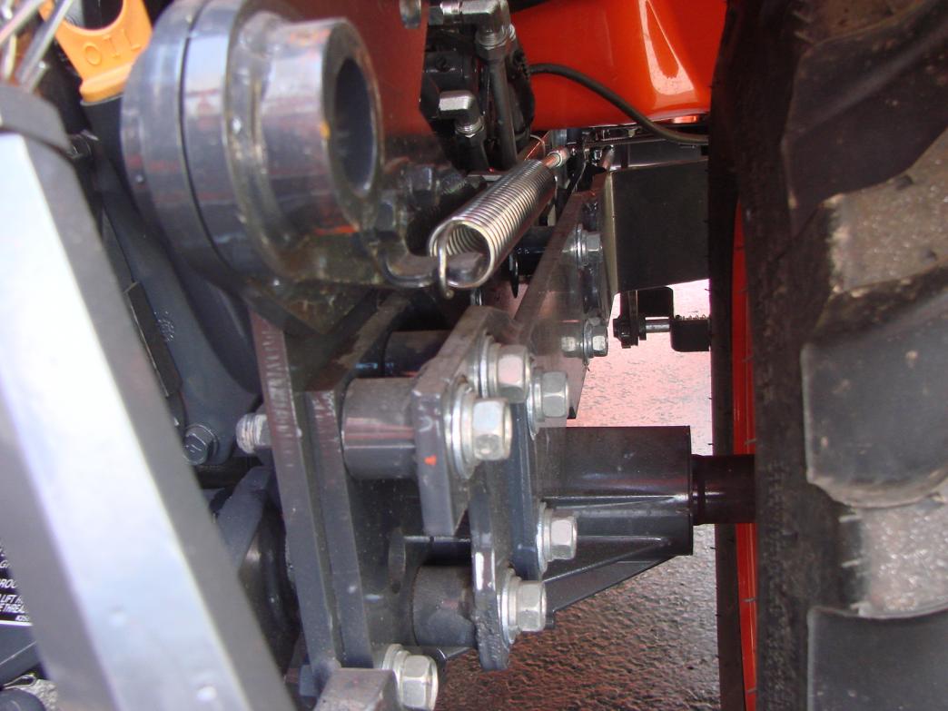

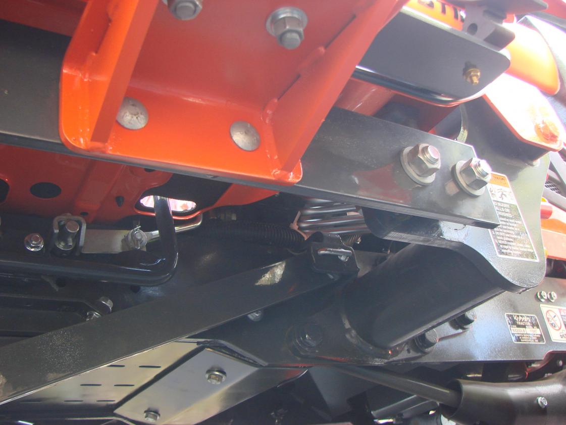

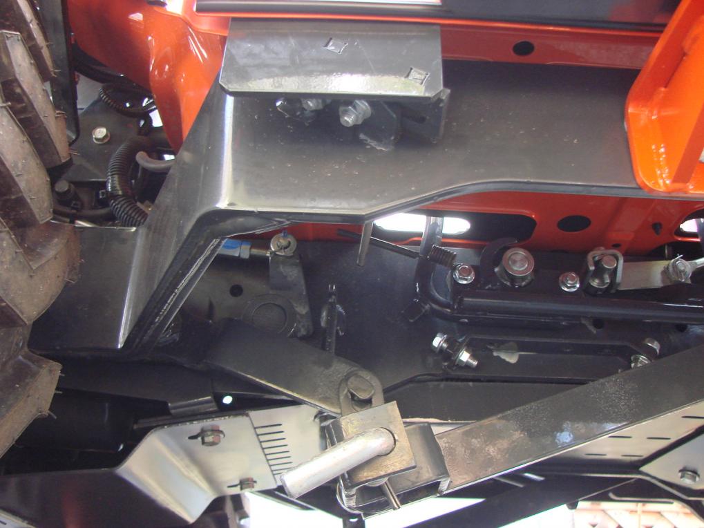

Well I snapped a few photo's for you. might help a little. It's flat out here. I started work at 4 am and sitting here having my lunch at the computer :(
Don't know the output of all the lights. I just haven't gotten around to doing that yet along with checking the hydraulic pressures but I'm getting close to doing it. Thank you for posting :)

Thanks Paul that put it in a little better perspective,, That is the sub frame for the FEL,, I see said the blind man ;)
Your more than welcome sir ;)
