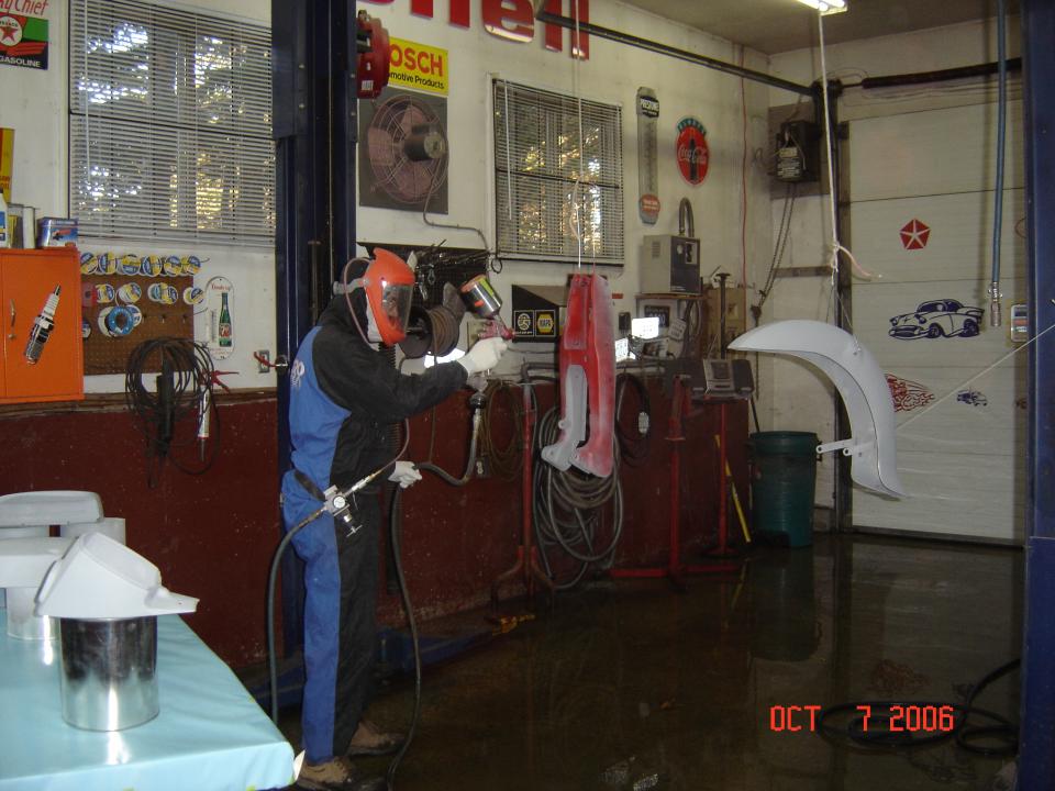

What paint products are you using?
Spray booth?
Well that's a tricky question. For automotive or restoration work I use base/Clear paints but for tractor stuff I machinery enamel. No spray booth but when I go to paint my shop is spotless. MY paint work is where I take all my pride. If I see any dust I'm devastated and I know it's hard to believe but my paint work is flawless.
I use HVLP equipment in the shop. Outside air supply as well. I attached a few pics of related paint work.

In the second picture I see the floor of your workshop is wet. Do you make it wet, to keep it clean when you spray?
Wildfire
Yes. Everything is washed down and the floor remains wet while the painting is in progress. It keeps dust down and trapped in the water resulting in zero dust if done properly.

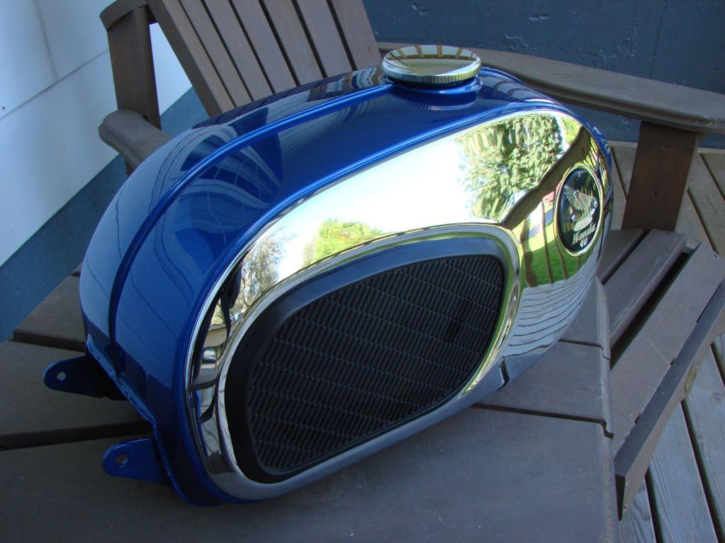

Here are a few more examples of the paint work I've done.

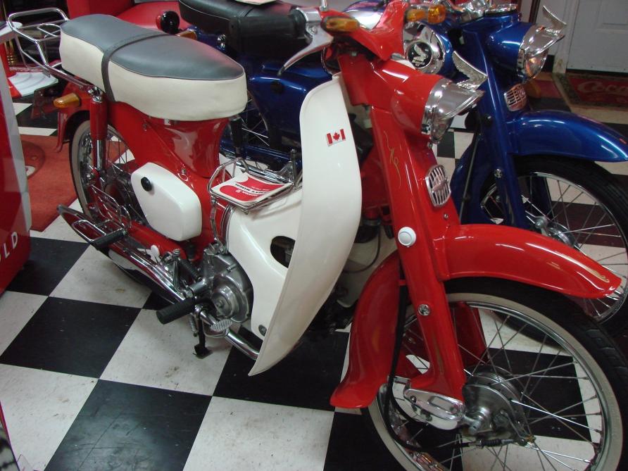

8,216
3,600
Wow, your 1st two restoration pics bring back memories.... the first motorcycle I restored was a CA95 150 Dream in blue, the little brother of that 305.
I also had a black Honda step through, a virtual twin to the second pic.
Thanks for posting!
16,026
5,755
Man that was a flash back,,, that 305 dream was one sweet little bike,, and it lead me down the path of 2 wheeled bliss many years ago,, Mine never looked that good, sometimes I wish I would have kept it,,
