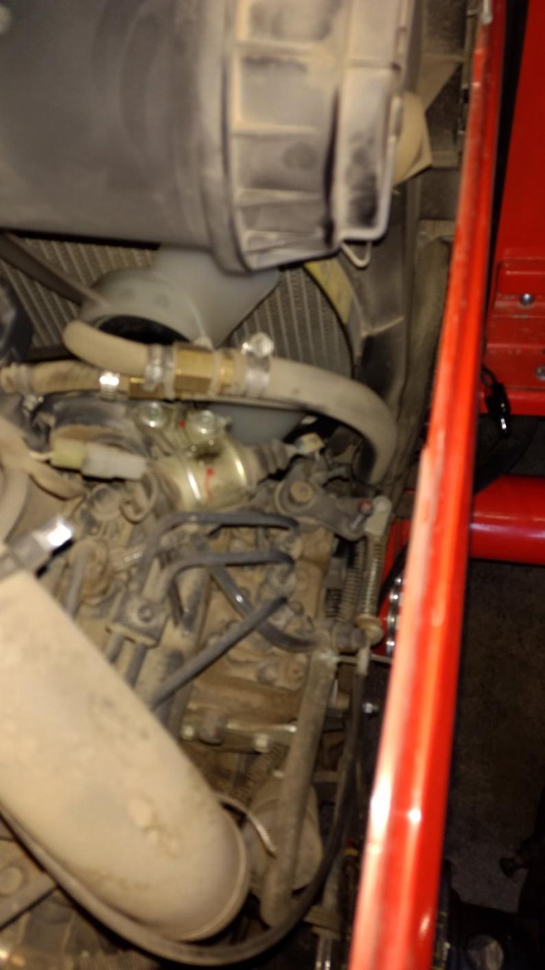

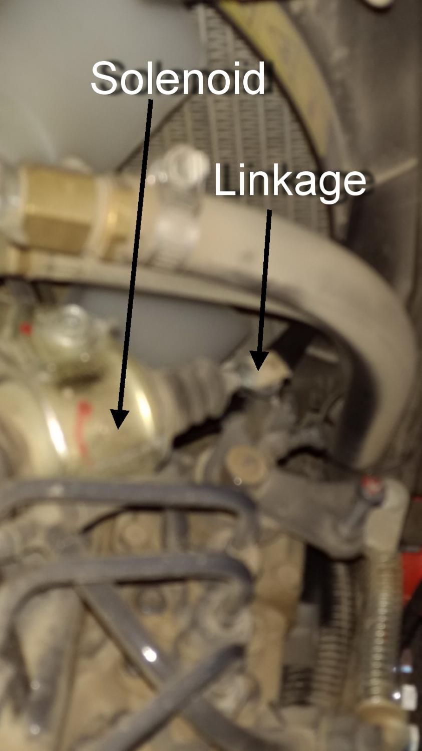

Here are a couple of pictures of the fuel shutoff solenoid. It is located on the left side just in front of the radiator. When you have the hood open if you reach across and move the throttle you can see how the throttle linkage moves. To move the solenoid linkage push in on the linkage where I have it marked on the picture. When you turn the key off, or one of the interlocks operates, the solenoid energizes and shuts off the fuel. I would clean the linkage pivot points and contact points with WD40. The WD40 is not a lubricant and will evaporate in about an hour. Then you can lubricate with oil, or if it is really dusty a dry spray on lubricant.
